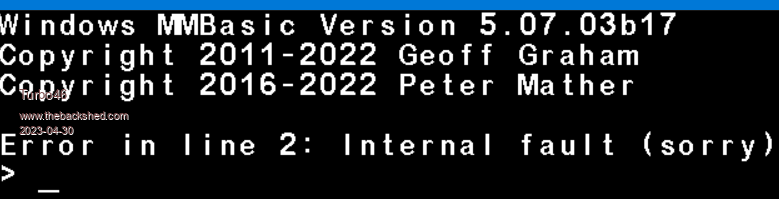

Thanks Peter, I tested it with this from your post:
a$="123456789"
? math(crc16 a$,9,&H1021)
and got this:
Bill
Posts: 12040
Posted: 10:05pm 29 Apr 2023
Here you go

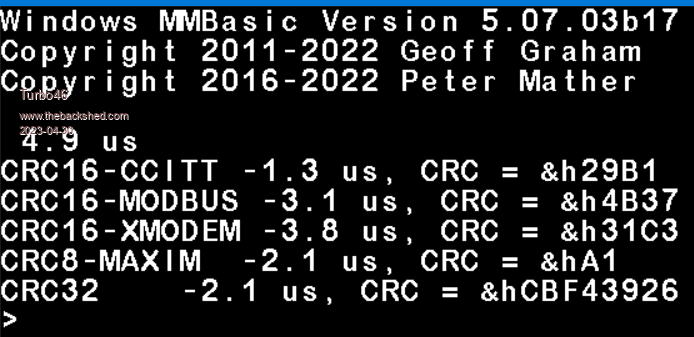

Posted: 10:40pm 29 Apr 2023
Thanks Peter, That worked.
I tried Volhout's test program and got the same values as a result.

Much faster though, the times are negative you must have added a flux capacitor to MMB4W.
