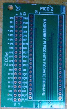

  Mixtel90 said  I can't imagine why not, except that I don't think VBUS and VSYS are connected to the I/O connector on that version.
With DVM set to buzz for a link, all 40 pins on PICO2 are connected to the corresponding pin on the 20x2 connector. Two-for-one PCB.
Posts: 9329
Posted: 06:09am 01 Jun 2022
Perhaps it needs some more silkscreen: "Tear along dotted line". :)
Posts: 3888
Posted: 12:10am 07 Jun 2022
Re that 20x2 breakout PCB cut from the "Pear" PCB, here it is:
And here it is in a box:
And a running example: Picomite plus 20x2 cutout PCB
Posts: 9329
Posted: 07:39am 07 Jun 2022
That worked out really nicely. :) Well done!

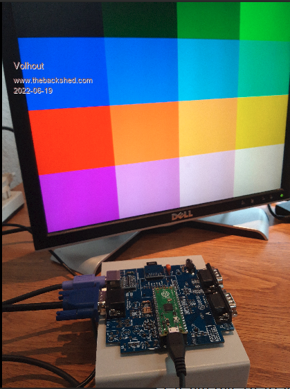

Posts: 6254
Posted: 09:30am 19 Jun 2022
Mick, Tom,
You 2 are the driving force behind the picomite VGA game pcb.
I have received my 1.4 board from Tom, and am starting to build it up.
I think we can simplify the VGA output circuit
for RED and BLUE we can use only a 270ohm resistor (no diode).
for Green we can use 390 ohm and 820 ohm resitors. (no potmeter, no diode).
On my monitor that is adequate.
On the 1.4 board it is simply placing only these 4 parts and a jumper for R14.
I noticed on the 1.4 board there is a option to disable the onboard switchmode power supply, but that coffee bean goes nowhere. The coffee bean in the 5V (default open) I have closed to get the PS2 working. Currently running of micro USB on the pico.
I reworked the board to get audio corrected.
I am building up the board in phases, testing each circuit as I go.
Edited 2022-06-19 19:32 by Volhout
Posts: 9329
Posted: 10:41am 19 Jun 2022
I'd considered simplifying the video - in fact I have done on some other designs. As you say, it would be easy enough to do on this. The results look pretty good. I've not tried comparing the two yet. I'm also not sure how well the simplified design would work on all monitors, or whether the few that are using it have just been lucky. Leaving bits off saves board space, but that's all really. It hardly saves any money.
I know about the SMPS inhibit - that's one of the things fixed on the next version. I could kick myself for not spotting that! lol
It's lovely to see another of them running. :)

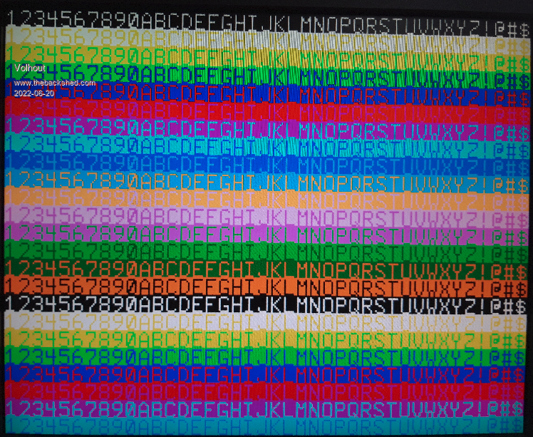

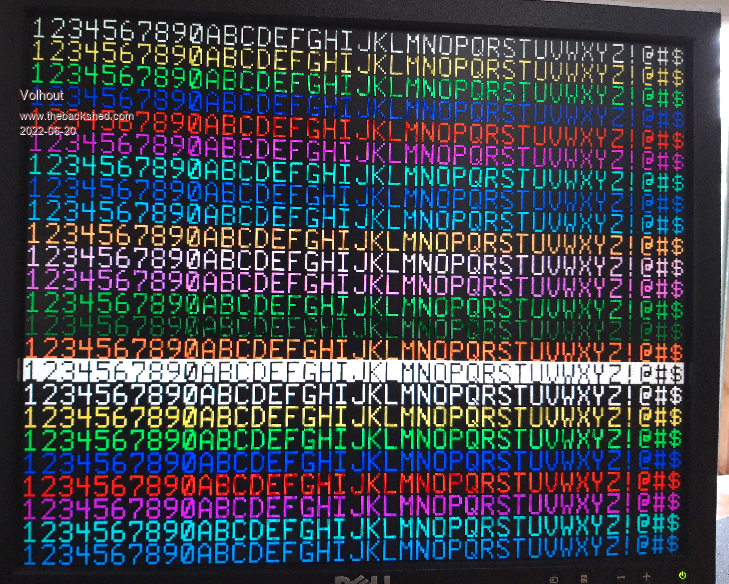

Posts: 6254
Posted: 02:34pm 19 Jun 2022
  Tinine said
@Volhout:
I wonder if you could show a pic of what text looks like in that multi-coloured mode, please?
Is that 330 X 240?
320x240
Here are (large photo's) color text on black, and color text on color background.
I have no idea how the photos look in the forum. On the phone they look sharp.
I was afraid of that, the color on color shows some artefacts that do not show on the monitor (especially on the yellow on green).
Edited 2022-06-20 00:36 by Volhout
