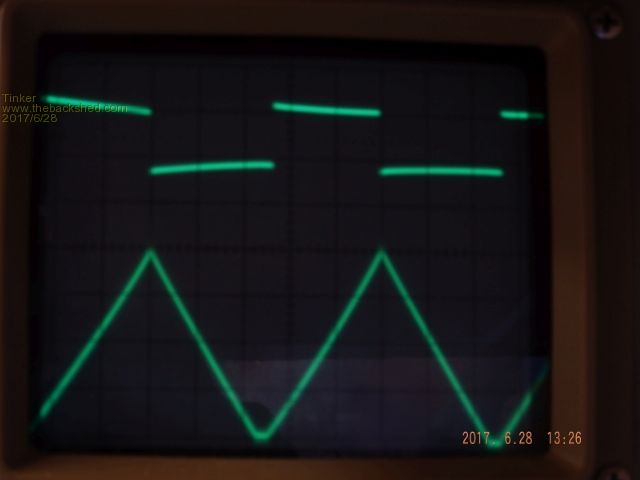

More saturation testing:
The parameters are a little different from above.
Test frequency : 101Hz
Air gap ; 2 x 2mm
Test coil : 125 turns of 5 mm sq
Voltage at capacitors (just before saturation): 43.9V
Peak current at that voltage : 20A
Current drawn from capacitors : 0.579A
A picture taken with my other camera:
The hall sensor is bidirectional (did not say so in the specs when I ordered it) and its zero current output is 5V DC. Each Amp passing through increases (or decreases this by 40mV.
The current trace is 200mV/div, set to AC to allow for the 5V offset.
According to Warpspeed's formula that should give an inductance of one milli Henry.
Is that right? my maths are a bit rusty these days.
The slight increase in the air gap seems to have made no difference to the max Amps before saturation. Perhaps this was because I doubled the test frequency?

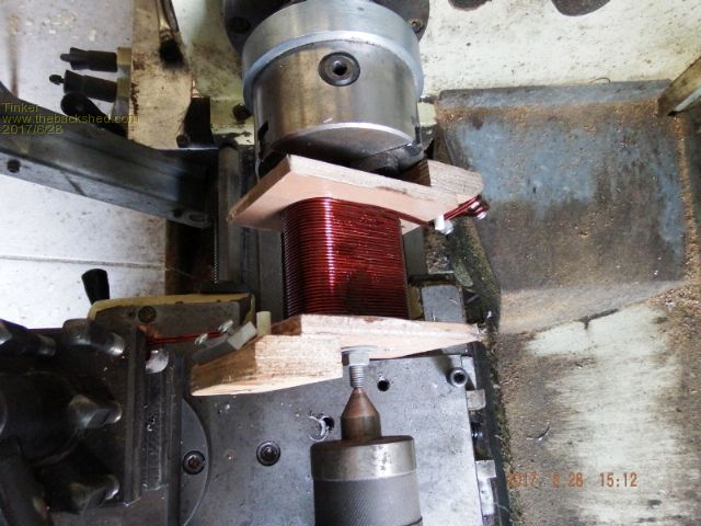

Now the final coil has been begun, the first layer is on and the ends being epoxied to keep them firmly in place.

L = E x Ton/I
L mH = 43.9 x 4.95mS / 20A
10.86mH
That sounds about right. One of those cores with 84 turns gives around 2.8mH.
You now have two cores, and more turns, but a slightly larger gap (2mm vs 1.6mm).
One turn would be 10,860uH divided by 125, again divided by 125 = 0.695uH
Eighteen turns will be 0.695uH x 18 x 18 = 225uH
Saturation is 20 Amps x 125 = 2500 ampere turns.
Final choke good for 2500/18 = 139 amps peak. (about 98 amps rms in the primary).
Your toroid turns ratio will bring that down to secondary rms amps.
Sounds like a goer Klaus !!

I now use a similar setup on my own lathe for winding things. Its very easy to get distracted and mis count turns, so I fitted a Chinese turns counter to my lathe.
Its very important that every layer has exactly 18 turns.

I do use a turns counter, its an old fashioned 3 digit one (no shaft) with a lever to advance and a knob to reset. You might have seen them attached to clip boards people used in the past to count things passing by.
But, with winding on 2 in hand simultaneously, and exactly one one full layer (68mm wide) its easy to see when 18 turns are on. The counter is just to double check.
After having done another layer today this is going to be a tedious job as I have to lock the ends firmly in place each layer. Using fast setting epoxy that does not set really fast in my cold shed will keep me at this for a few days to do 10 layers.

Using many layers of epoxy is certainly a very slow process, but it makes for a really good final job.
Posted: 11:37pm 08 Jul 2017
So I finished winding that power choke now. Not the easiest of jobs doing it this way but definitely the only way to get a fair number of turns at a reasonable cross section onto these cores.
While there was room for ten layers of 1.8mm wire, in the real world I only managed to fit 9 layers. Still not bad, 45mm sq total @ 18 turns.

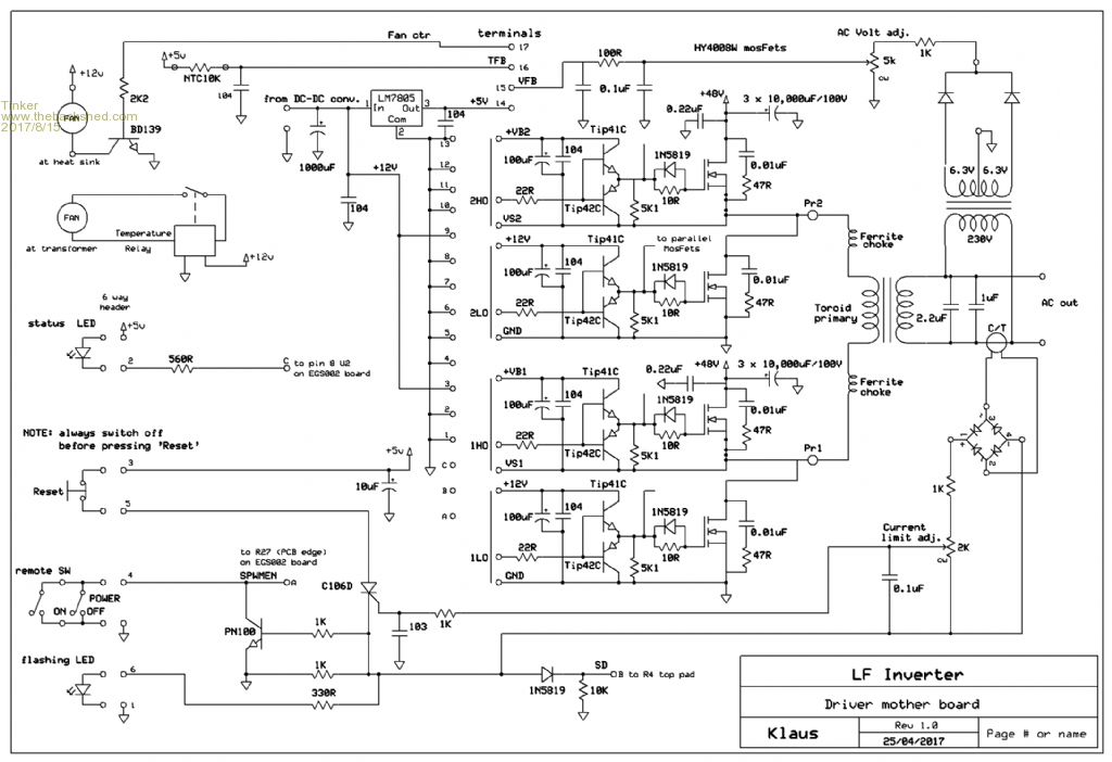

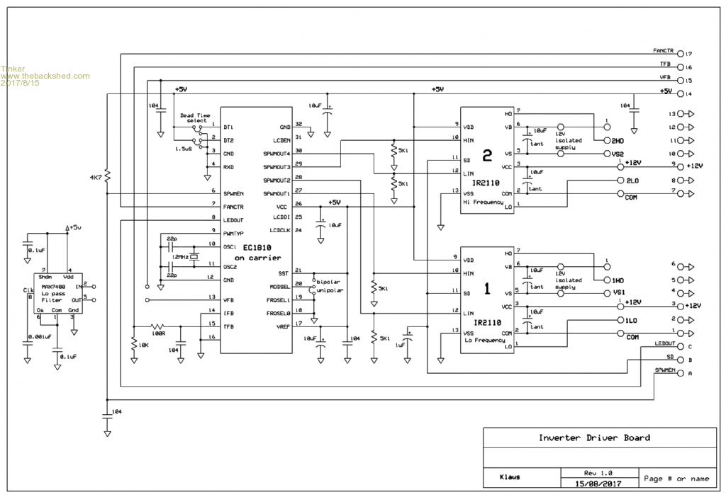

Anyway, I'm stumped now, can't get that thing going at all now
The new board is based on a circuit that Solar Mike posted, back on the 29th of March.
This worked for Madness but for some reason not for me as yet.
I'm sure I done something silly but no matter how hard I look at it the penny will not drop .
Any ideas are very much appreciated. I'll attach the schematics below.
Symptoms: no magic smoke and no sine wave at all at the transformer.
Just 4 Mosfets connected for now.
These switch fine if tested individually, switching a car spotlight.
All 4 outputs of the EG 1810 show a square wave. Ditto on the IR2110 Hi & Lo outputs.
Drive signal still present at the mosfet gates.
Perhaps the mosfets turn on in the wrong sequence but I would think that surely demands magic smoke??
Since I am not fully sure what kind of drive signal wave form I should see at the Mosfet gates perhaps I could be enlightened here?
In particular, referring to my "Driver mother board" schematic, from the top Mosfet down to the bottom one. And the sequence they turn on? I thought its 2HO + 1LO then 1HO + 2LO and repeat.... But I could be wrong.
Does anybody know a site that explains a full bridge mosfet inverter well in a simple way with perhaps wave form pictures (not bags of mathematical mumbo jumbo)?
The signal generating board:
And the power board. Please ignore the left half of the schematic for this post.
Thanks, Klaus

If you disconnect the transformer, you should see a very clean 50 Hz square wave on Pr1. No high frequency PWM, just alternately on and off, ground and battery at 50Hz.
Pr2 will switch at 20 Khz and will look like a mess if viewed directly.
On page six of the EGS002 datasheet there is a low pass filter test circuit that consists of a series resistor of 5K1 and a 100nF capacitor to ground.
These values are not at all critical, 4K7 will work fine.
If you connect the 5K1 to Pr2 output, and connect your CRO probe across the 100nF, you should see some funny looking half sinusoids that look exactly like the waveforms shown on page six.
http://www.egmicro.com/download/EGS002_manual_en.pdf
The same identical waveforms but at lower amplitude should also be on the four mosfet gates and gate drivers.

I know this is not comforting for you as I have been your shoes also but my inverter has been running nonstop since early April. I did turn it off once to disconnect my old Trace inverters from the switchboard, that was only done for my safety. It has been working flawlessly, still using the original Oztules (big thank you to John for making this possible) control board, it is the version before the ones with the SCR. I am using the choke you sent me, the waveform still has a small blip but that does not seem to matter.
My circuit is the same as posted by Solar Mikes (thank you again Mike) except I included the Snubbers as you have done. What I can't see on your circuit is where VB1 and VB2 are connected to, I have a diode (UF4007 on Mikes circuit) between each one of those points and the 12V power supply. Without the diode, you will not get the high side MOSFET to turn on. I see you show the Isolated 12V supply at the IR2110's, this is the only difference I can see between your circuit and mine. I have had EG8010 chips that will not start up reliably with capacitors on the power PCB unless I powered it on with the 300A breaker I use for the inverter. Powering up the control board on its own was no problem, Oztules mentioned he had some issues like that also trying to power up the board via a resistor.
What I had done for testing is to connect 12V on the control board to the VFB circuit, this keeps the control board running with no power board connected. then using the low side output you can connect it to each gate drive to individually confirm they are working. The high side signals from the control board are just very slight squiggle on the CRO until the power board is operating.

I tried the scope between PR1 & PR2 and got nothing.
Will try just PR1 tomorrow. Also the test circuit in the PDF manual you mentioned.
I do have a suspicion the EG1810 might be funny. I have another one on a carrier board but that has the same symptoms. So I'll have to make another yet - tiring work soldering these tiny SMD's for my old eyes.

Are you getting 0 to 12v peak drive pulses across each of the 5.1k resistors connected to the Tip42/2 common emitters, if so, and the mosfets have a 48v supply, they should be switching the transformer primary.
To test just the bridge components, if you disconnect the toroid primary and place a 100 ohm resistor or a 48 volt lamp across bridge Pr1/2, then unplug your IR2110 driver chips, you can test each mosfet pair and get the lamp to light up by shorting the drive to the 22 ohm resistors of the tip 41/2 to their respective 12 volt supply or 0volts with a 100 ohm resistor, do this on both 1LO/2H0 then 2L0/1H0, lamp should light in each case testing the bridge components.
Noticed your cct has 10uf tant caps on the IR2110, perhaps not a good idea, they fail randomly by partial shorting and are not suited to discharge applications, use a 105c electrolytic here.
If that works and the IR2110 are getting drive from the 8010 then it sort of leaves the 8010,

Thanks for the tips. Solar Mike, I will replace the tantalums, I have suitable electrolytic caps.
It appears the EG1810 had lost its high side output. It put out an identical signal than that at the low side.
All the other components tested out fine. Since applying an identical signal to PR1 and PR2 would not do anything - as I discovered, the faulty chip was to blame. After you kindly mentioned what signal to look for the diagnosis was easy enough.

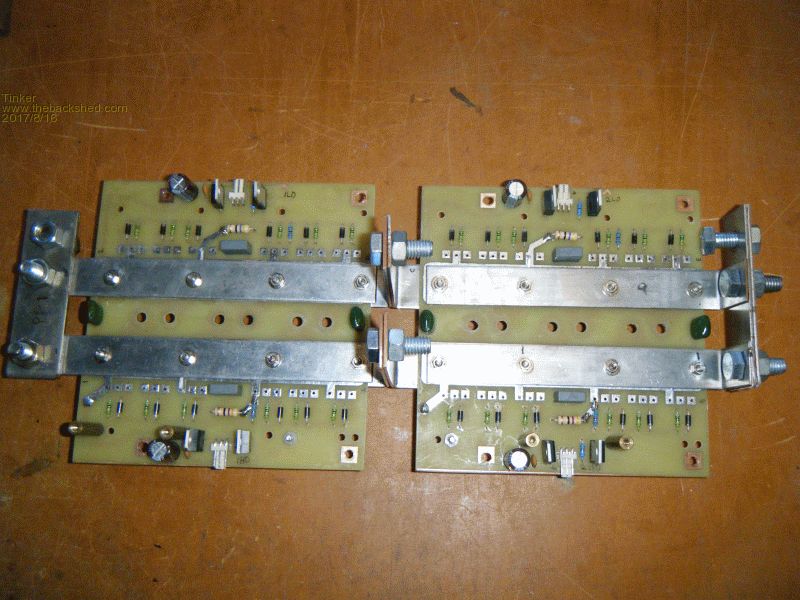

Below are a couple of pics of my power board for your interest. Its different from other inverter builds.
Top side is shown above. Two identical 150mm x 150mm boards, one for the low side and one for the high side.
The busbars on the underside, exiting between the boards, are the positive and negative rail. No capacitors are fitted yet, they are the screw on type and fit in the center between the power rails.
PR1, located on the left and PR2 on the right outside of the boards connect to the primary via chokes. The 4 screws fixing the busbars to the board have insulator bushes on the underside to stop shorting out the power & primary rails.

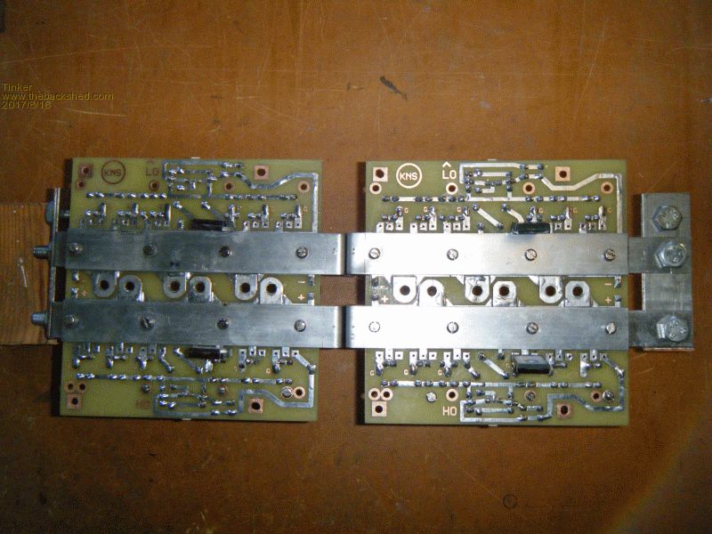

This shows the underside where the Mosfets live. Only 4 of the 24 are fitted for testing. The source & drain legs clamp under the busbars, only the gate leg is soldered on.

That is super neat Klaus, very impressive workmanship.

Excellent Klaus, modular construction and ease of servicing in your design layout, that is the way to go.

Thanks guys, but it comes at a price . The holes have to be super accurate for everything to line up. Its also my first attempt to make a double sided PCB, another challenge for the home tinkerer.

Nice engineering Klause, I found it quite easy to clean up solder between the legs of the 8010 very easy with solder wick. Having SMD flux on it helps a lot with the soldering too, just the slightest bit of solder on your iron flows right to where it is needed. Less solder is definitely better than more on your iron.
