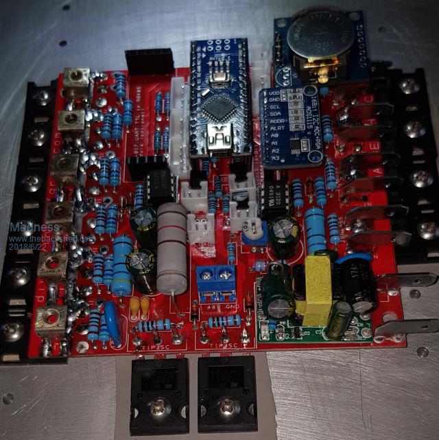

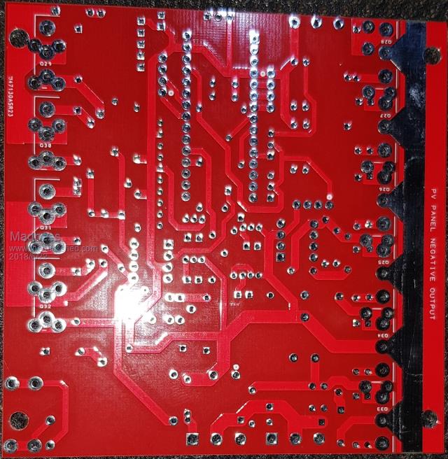

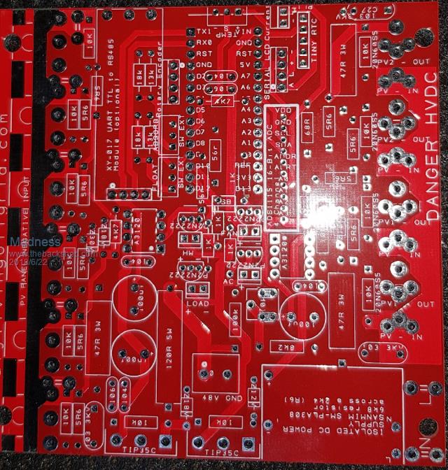

Hi Gary,
Can you post pdfs of your charge regulator? If I may I would like to make a schematic during my spare time for reference. Thanks.Edited by tinyt 2018-06-19

Posted: 09:57pm 17 Jun 2018
PDFs attached.2018-06-18_075520_Silk.pdf 2018-06-18_075654_Bottom.pdf 2018-06-18_075729_Top.pdf

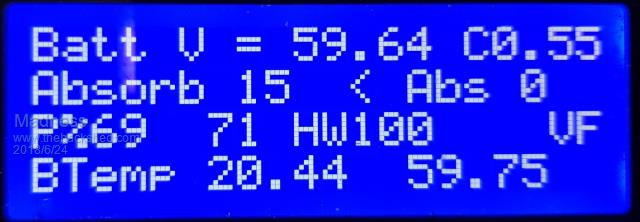

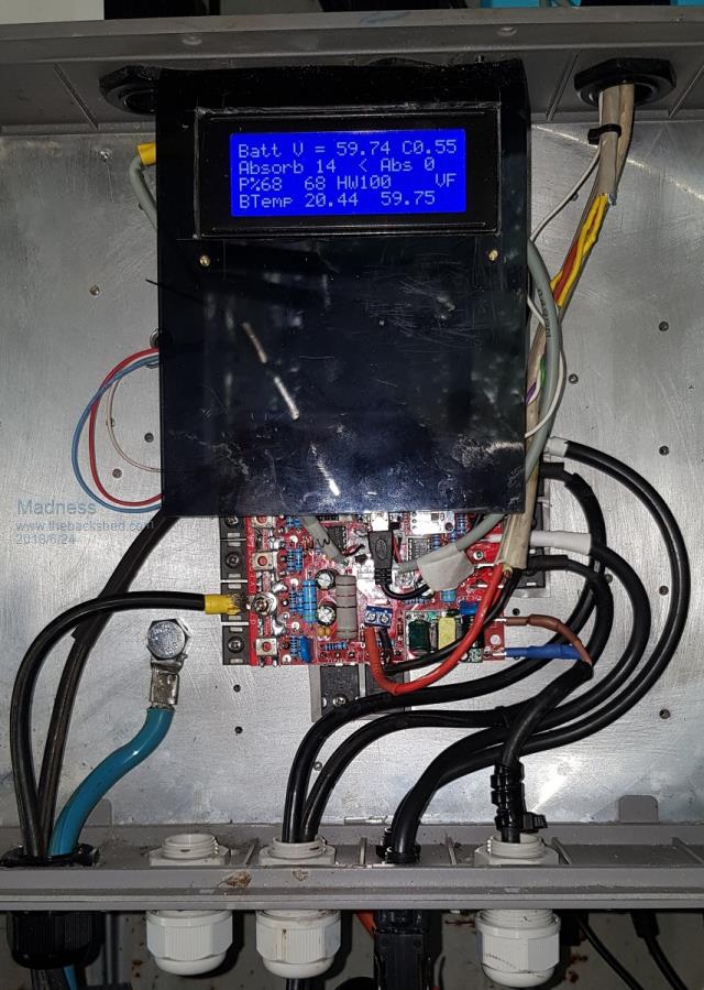

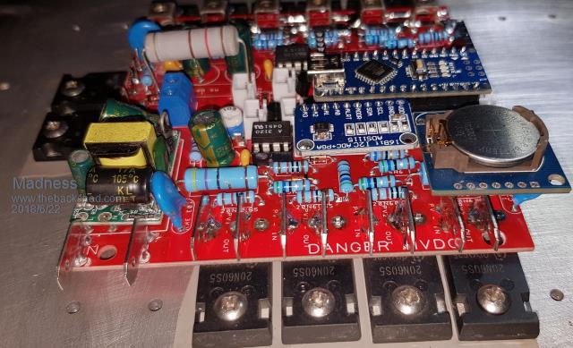

Hi Neil,
The Arduino Code is evolving, there is quite a bit I want to add to it yet. ATM I am waiting on another current sensor to arrive to do more with it, the one I had failed due to voltage spike from the step-down power supply. Hence why I mentioned needing Zener Diodes to prevent that from happening. Here is what I am using now it works very well as it is and nothing more is needed if you don't want any extra functionality bells and whistles.
The latest order of PCBs are supposed to arrive here on Friday, I will do a new thread on how to assemble the Charge Regulator over the weekend.
[code]

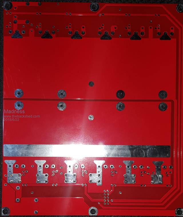

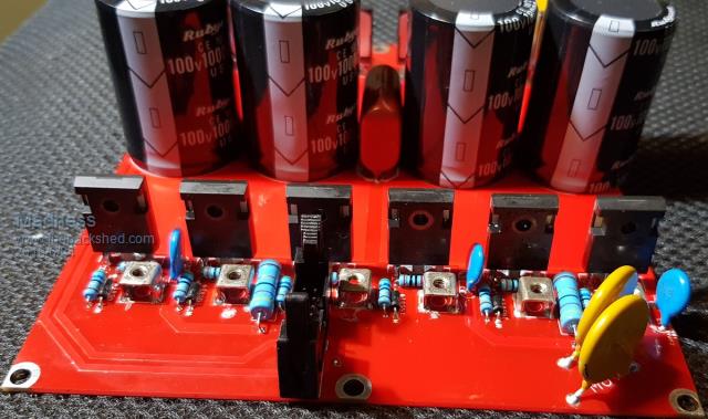

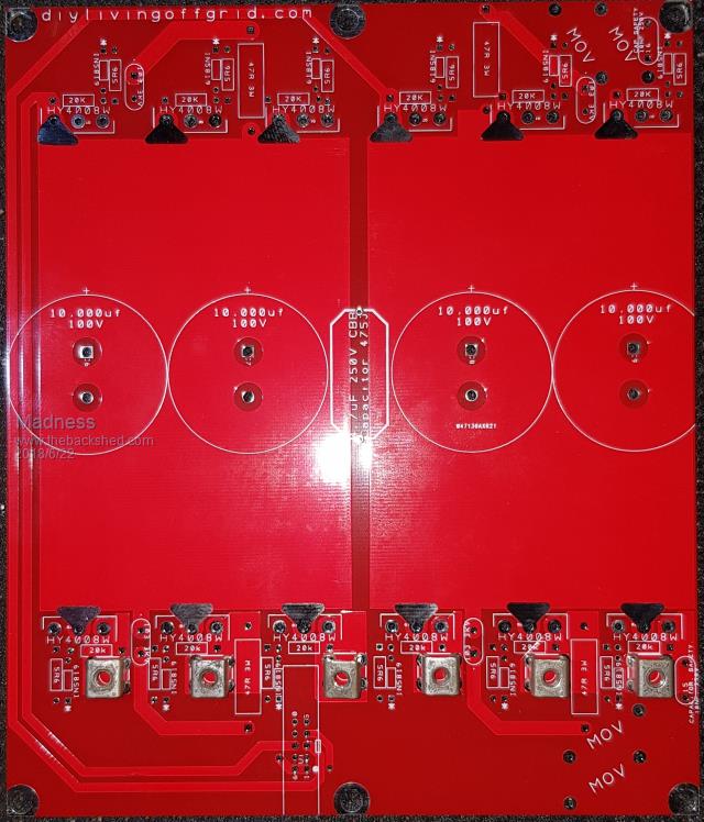

New PCBs have arrived, still waiting for new screw terminals, the ones in the photos have been taken from AeroSharp PCBs.
This is the 4KW Power Board, the screw terminals are for the ground connection. There is 2oz copper top and bottom of the PCB from the terminals to the MOSFET source legs.
Bottom side still places there to solder negative to PCB if you wanted to.
New Regulator PCBs
Here is one I have assembled ready to test.
The spade connector sit just to the side of the drain and source legs, straight Spade terminals will work also.
Edited by Madness 2018-06-23
Madness
Joined: 08/10/2011
Posts: 2498
Posted: 06:46am 24 Jun 2018
I have one of the new Charge Regulator boards assembled and been running all day today.
Close up of the display, top line is battery volts and compensation value on the right for battery temperature.
Line 2 is charge stage here showing absorb and minutes in absorb, on the right is time it has spent below absorb voltage since absorb started.
Line 3 DC - DC and Grid Tie PWM percentage, Hot Water SSR percentage and VF indicate battery vent fan is on.
Line 4 Battery temp, and target voltage.
I have ordered another current sensor and waiting for it to arrive after the first one was killed by a spike from the step-down converter I was using.

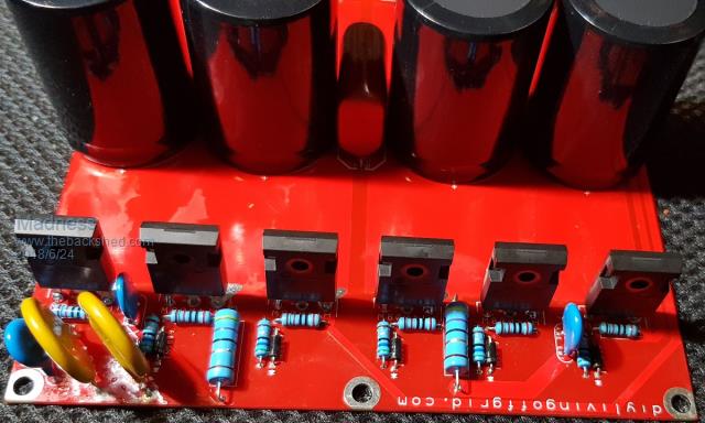

Here is a 4 KW Inverter PCB Assembled, just washed it ready to fit it to the heat sink. The clips of the 10 pin connector is in the way to get to the MOSFET screw however the clips are easily removed and popped back in later.
Just waiting on terminals to arrive, should be here in the next few days, I will start sending PCB's tomorrow to those of you who just ordered bare boards.

Hi Madness,

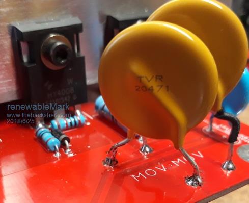

I haven't seen it mentioned before, what value are the MOVs on that 4kW board?
If I read the board layout correctly, are the MOVs connected from the -48V and +48V rails to the earthed case via the mounting holes?
Madness
Joined: 08/10/2011
Posts: 2498
Posted: 05:02am 25 Jun 2018
The MOV's (Metal Oxide Varistors) are there for lightning protection, I have not seen anyone else including them. They are connected between + & - 48V to earth on the case as you correctly mentioned. Any voltage above 65 is okay but any I have seen are rated over 200V at which they will conduct.
renewableMark
Joined: 09/12/2017
Posts: 1679
Posted: 05:51am 25 Jun 2018
Yee of little faith, tut tut.
Actually I only just put them on, I wasn't too concerned as it's not mounted in a box yet, and we get bugger all lightning in Melb anyway.
Those are the recovered aerosharp ones, if you look here on p30 it has the data for them.
The ones I used were NIB inverters so ok but best to get new ones rather than pulling them from used equip.
Cheers Caveman Mark
Off grid eastern Melb
