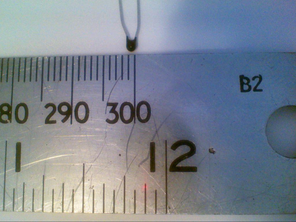

They are a tiny teardrop glass looking device, all of 2mm in diameter by 4mm long ...  a bit like a tiny christmas light globe out of its holder.
I did measure its resistance last night before I unsoldered it from the board at about 17 or 18 degrees  ...  and it was 124k. Dunno if that sounds like it can be replaced or not.
That sounds about right for a nominal 100K at 25C thermistor. The resistance goes down as temperature rises.
I could not find any of the really tiny ones, but at least these are in Oz and should arrive in about a week.

Mmmm  ...  those look exactly like the ones in the logger now.

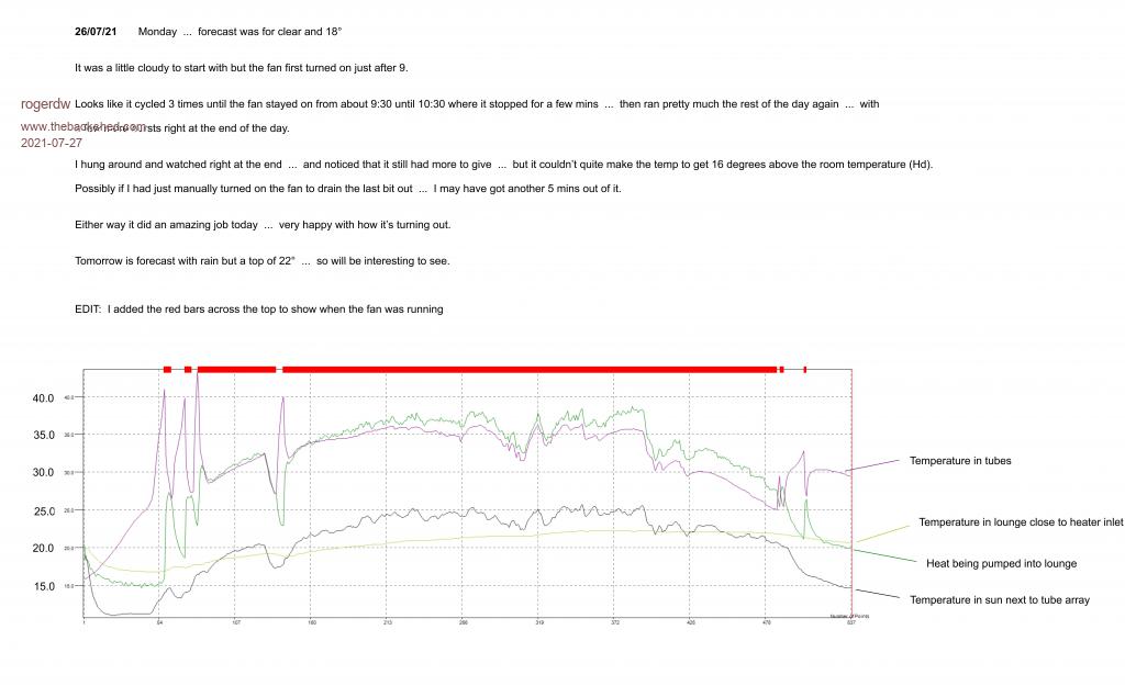

I may need to persevere with what I've got I suppose. Cetainly this one responds more quickly than it did before.
One thing that is disconcerting with the chart is that it looks like the fan is pumping air in, right down to about 16 degrees (during the early cycles for the day)  ...
...  but the temp dropping down to 16 is simply the sensor floating back down to the room temp and not the system pumping in cold aitr.
I need an indicator that shows when the fan turns on and off.
O/k, I looked through e-bay but could not find any that are really small like these that I have here, which are only just over a 1mm blob.
Just breathing on these and they respond pretty much instantly. If you PM me your address I will get a few off in the mail to you today.

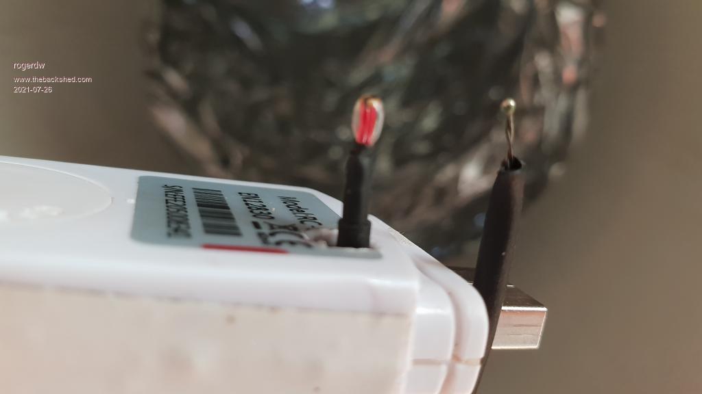

It's a ripper day down here today  ...  the system only fired up around 9  ...  but it is nice and sunny  ...  so expecting to cook the house if conditions don't change.
Thanks very much for your kind offer Tony but now that you've found those others I'll grab some of them instead of depleting your supplies.
I'm looking forward to fitting one to the outside logger too.
The photo shows a comparison between the original logger one and the sensor from the Owon multimeter.

Just thought I'd throw up todays results and come back later to answer some of the above comments. Gotta go out and practise my ally welding otherwise this new one will never get finished.
We started at about 17 degrees in the lounge this morning and got up over 22 in the arvo. When I came in at 7pm, the house was still nice and warm and I was almost tempted not to light the wood fire  ...  but that would be a mistake because it would freezing by morning.
I edited the image to show when the fan was running.
Edited 2021-07-27 02:03 by rogerdw
Cheers,  Roger
Posted: 07:45pm 26 Jul 2021
Its interesting how the tube temperature was slow to climb initially, but then suddenly took off just before 9am.  I think you mentioned earlier about shading from a fence.
Once its up on the roof it should get going much sooner.
Imagine how this will go on a good day with three times as many tubes and no shading !
It will heat up much faster in the early morning, then the whole house can absorb the heat which should then stay warm for longer in the evening.
Edited 2021-07-27 05:49 by Warpspeed

  Warpspeed said  Its interesting how the tube temperature was slow to climb initially, but then suddenly took off just before 9am.  I think you mentioned earlier about shading from a fence.
I think yesterdays was also because of cloud on the horizon  ...  it looked quite sunny outside but it took a while for the sun to get up over the cloud.
