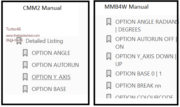

Hi Doug, One more thing: Several of the command and function bookmark entries include more than just the command or function name like:
There are too many to list.
I think I said it before but I like the extra level of headings included in the index. I does make thing a lot easier to find when using a paper copy particularly.
Bill

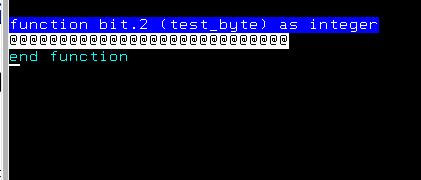

Sometimes in editor I`m receiving mess like this (always @@@@@@ in place of one program line)
But can`t really catch how it happens.
MMB4W ver b15, WIN7, WIN10, two different notebooks, longer programs edited.
It seems to me, it appears randomly after I have copied something into buffer, run program, returning to edit and scrooling down/up inside editor`s window. And it needs some time (run/edit cycles) to appear. Not a big deal, really, but still kind of problem (say, if unnoticed, suddenly program throws an error to be found later some line was messed away :) )
My MMBasic 'sand box'

Hi Doug,
There is still more information in the bookmarks. The illustration below shows the difference when compared to the CMM2 manual.
I suppose it's not a big deal but I think it looks better as Geoff does it and the items are easier to find.
Bill

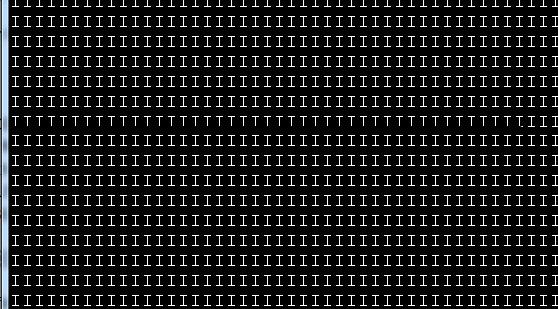

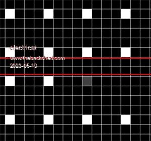

Matherp,
Just take a look - wrong vertical distance in the middle. If the distance is large enough, you would not notice this, but at shorter distances (3-5 px), there is a noticeable effect.
It is hard for me to describe it in English, but I tried to capture an image for you and make measurements using Photoshop.
(My desktop computer leaves a black gap in the right part of the screen, and it might happen due to the video card, as my notebook PC fills the right part OK, but with wrong center distance however.)
MODE 9
draw_mesh (4,4)
sub draw_mesh (hstep,vstep)
hor=MM.HRES
vert=MM.VRES
for row = 0 to vert step vstep
for col= 0 to hor step hstep
pixel col, row ,RGB(white)
next col
next row
end sub
I might look crazy rise problem of one pixel :D
But I`m just drawing accurate mesh of pixels :D
https://imgur.com/a/kbdAuvp
Edited 2023-05-10 00:48 by electricat

Posted: 02:29pm 09 May 2023
This is also very similar to the above problem?
MMB4W V5.07.03b16
OPTION DEFAULT MODE 9 1024x768
OPTION DEFAULT FONT 2,1
OPTION DEFAULT path C:\.......
OPTION KEYBOARD US
CURRENT DISPLAY 38,85
> DO : PRINT CHR$(73); : LOOP
The bottom line of the first 42 characters of I or M is distorted on line 19.
I didn't notice this with the other fonts.
Is this new or discussed before?
Nice day.
electricat
Joined: 30/11/2020
Location: Lithuania
Posts: 299
Posted: 03:05pm 09 May 2023
  Quote  This is also very similar to the above problem? MMB4W V5.07.03b16
@JanVolk Yes.MMB4W V5.07.03b17 too
I tried your example and see distortions too.
I started looking at MMB4W sources (curiosity killed the cat :D ), but Matherp sure would be faster at it :D

Goksteroo
Joined: 15/03/2021
Posts: 114
Posted: 03:53pm 09 May 2023
Two questions....
Is your screen's native resolution 1024x768?
Do you get the same 'distortion' if you use a full screen mode, eg "Mode -9"?
Edited 2023-05-10 01:55 by Goksteroo
electricat
Joined: 30/11/2020
Location: Lithuania
Posts: 299
Posted: 04:44pm 09 May 2023
@Goksteroo
I believe, I follow what you have in mind.
Screen`s physical resolution is 1920x1200.
And in mode -9 of I get even more fancy patterns of course :)
Posts: 12040
Posted: 04:58pm 09 May 2023
V5.07.03b18
MMBasic.zip
Should fix the above issue
JanVolk
Joined: 28/01/2023
Posts: 420
Posted: 05:51pm 09 May 2023
Thanks Peter,
I'm new to fashion and ran into this distortion by trying and unfortunately got stuck at mode 14.
Got the latest version and worked immediately in mode 14 and my test program: > DO : PRINT CHR$(73); : LOOP works well for mode 14 and font 1,1 and display 45,120.
This is image filling with the data in the middle of the screen. Also tested mode 9 with font 2,1 and works fine now. Now to test the other modes and fonts, I probably have to do this again?
According to the manual there is mode 1 to 20, but many modes are invalid mode I found out.
Can I find the setup data somewhere on my laptop because I couldn't do anything with the previous version because the cursor was lost? But if everything continues to work well, that is not really necessary.
Nice day
