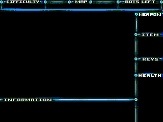

My Idea for the Top Line ..
while the game,it could be a Status Line ...  which could be the name of the Map, the Difficulty level and maybe the number of remaining Robots, so that you know, when you can go to the Transporterplatform (end of Level).
if we do so, I can extend the frames upper 24 Pixel that the information fits better to the rest of the Game
Edited 2023-11-03 20:48 by Martin H.

One hour of sweat later....
How about the Info Line ?
layerc.zip
PS: For my taste, it will fit better to use the Top Line at the Start/Intro Screen for Credits etc (Thats what I made it for) , not the Info at Start of the Game
Edited 2023-11-03 23:17 by Martin H.
'no comment
Posts: 6171
Posted: 02:12pm 03 Nov 2023
I just copied the DOS version implementation.
