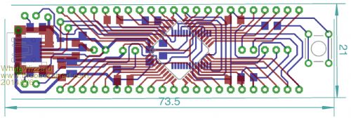

Not sure if anyone will be interested in this but with the aim of simplifying Beta Testing I decided to build what is turning out to be a cute little evaluation board for the 44 Pin MicroMite. I will make it openly available as soon as it is finished so watch this space . . .
I originally bought various TQFP Break-Out-Boards but none of them gave me 100% of what I needed - so hence the above baby was quickly born!
Note that this is work in progress. I only just got the 44 pin PICs late today (50MHz version x 10 ). My plan is to etch the first board tomorrow and hopefully assemble everything by tomorrow night.
Headline Features::
- Dedicated yet compact module - can be up and running by simply connecting to PC/Mac (no other BoB's or PSUs required)
- Breadboard friendly - Slightly longer than a 40 pin DIP
- All 44 pins from the PIC available to user
- Built in USB-to-Serial circuit (FT232RL)
- Dedicated 3v3 regulator - supplies up to 1A (dependant on USB power source)
- Built in ICSP - useful when Geoff sends us his next MasterPiece!
- 3 x LED indicators 3v3 Power, Rx, Tx
- Power Jumper (save unplugging it all the time when you finish playing/testing)
- Reset Switch - Added at the last minute but not yet sure if MCLR enabled to support this
So for anyone out there reading this, please give me your thoughts (criticism welcome! ). By the way, I didn't include any LEDs, Switches, Sensors etc as that is the role of the breadboard!!

Posts: 10100
Posted: 06:18pm 05 Feb 2014
Looks great.
Let us know how you get on with the etch and prototype build.

Hi Phil,
Looks like a great step to take. I am surely interested in acquiring the board. Will it be populated or bare?

Posts: 2998
Posted: 10:00pm 05 Feb 2014
Hi,
The simple answer: "which would you prefer?".
Once the design is checked and the first home-etch board is successful, I will make the Gerber files immediately available to all of you through a web link. I will also incorporate any worthy hardware mods discussed on this forum (like the RC from the last couple of posts).
Passing you the Gerber files will allow you to etch & assemble this Eval Module yourself; but do note there are some very small tracks so some people may find it difficult for a home etch. Alternatively, you could get it etched by someone local.
However, if there is sufficient interest I would gladly offer the following:
1> Unpopulated board (reduced postage cost if sent as airmail letter!)
2> Part populated (all SMDs mounted but you still need to solder some parts (i.e. header pins) - for the hobbyist!)
3> Fully assembled and ready to go.
I will see if I can make a handful of home-etched PCBs readily available unpopulated on a first come first served basis!
Now off to begin etching . . . . .
Phil
