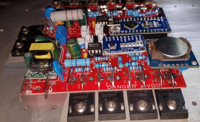

I had fun on the weekend with the 2n2222a transistors on the regulator board. Jaycar lists them as 2n2222a but if you open the datasheet from their website it is actually a P2n222a. They are not the same, everything is the same except the collector and emitter legs are reversed. You can use either but the silkscreen is correct for the P2n2222A, if you use 2N2222A you just need to rotate the transistor 180 degrees.

I need to start a build thread for the regulator. The side with the 6 HY4008 MOSFETs is for DC to DC battery charging via PWM, on a 48V battery bank that works best with panels with a 30. something Maximum Power Voltage configured in strings of 2. If this is all you require you can leave out the 4 20N60S5 MOSFETs and associated resistors, isolated power supply.
Some of us are using Grid Tie Inverters (GTI) connected to our Off Grid Inverters (OGI)via AC coupling (does not work with all OGIs) the OGI converts the excess power from the GTI to DC to charge the battery. This works really well however there is nothing to stop it when the battery is full which is why we use the Regulator. As the battery gets closer to full charge the Regulator reduces the power from the PV panels being supplied to the GTI. A little like putting a cloud over the panels to reduce output as needed for the battery.
You can use the regulator just with DC to DC or just with a GTI or use both. If you look at the parts list spreadsheet back a few pages in this thread I have separate columns identifying what parts you require for each configuration.

Just realised I didn't order a part for the charge regulator, Mad have you got a link for the button cell module?

That is the Real Time Clock, I have not used it as yet so don't rush to get one. It is there to keep more accurate time for doing equalization charges every 30 days and a few other things I have in mind.

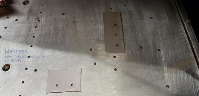

Mad, I see you used a big sheet of heatsink insulator and cut a bit for your area, but using these is fine isn't it?

  renewableMark said   Mad, I see you used a big sheet of heatsink insulator and cut a bit for your area, but using these is fine isn't it?
(Re gti charger/regulator)
Yes the individual ones will work but you may need to cut down the width a little so they don't overlap. Also getting all the individual ones in the right spot is a PITA but doable. The sheet type sticks down and stays in place so it is much easier. It is very important that the GTI high voltage MOSFETs and the 2 TIP35c transistors are insulated correctly. The HY4008 MOSFETs must not be insulated.

If you use the self adhesive pads, I have found in some cases sticking the pads the other way around - to the Mosfet instead of to the heatsink made alignment & trimming off the excess a cinch.

  wiseguy said   If you use the self adhesive pads, I have found in some cases sticking the pads the other way around - to the Mosfet instead of to the heatsink made alignment & trimming off the excess a cinch.
OK, I thought that was how they were intended to be used, so there was no chance of them not being lined up.

I find using a larger sheet cut to size very simple.
It does not cost a lot either.
