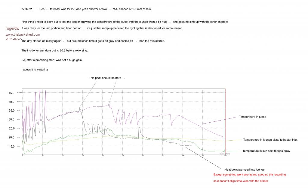

Yes, that should be easy enough to do  ...  though I do already have those three reflector panels behind my existing tubes. It's really hard to compare results because of the constant changes that happen out in the sun. I really need two systems side by side to be confident.
Today started off well  ... but a change with rain came in about lunch time.
On top of that, one of my loggers glitched for some reason and must have changed its recording times somehow. If you look carefully you can see where it should line up  ...  so it's still worth posting to see what poor conditions do to the results.
Cheers,  Roger

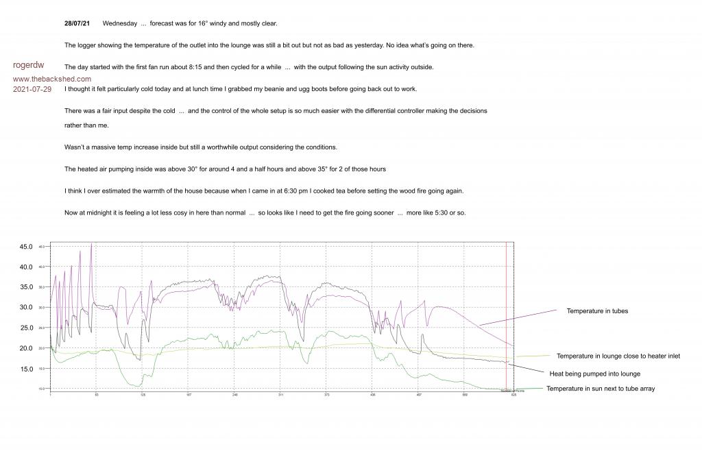

We did get quite late into the season that would normally be cold with brilliant sunny days.  I am sure your tubes would be Punching out the heat then.
The current weather makes your setup a little  iffy but then every year is different and next year may be much sunnier even if cold days.
We seem to come out of winter here, have beautiful September weather and then the first week or 2 of October is Chit just when you put the cotton sheets on the bed and  did away with the warm clothes.  Usually rains for a fortnight or best part thereof as well.
This last week since I got the Diesel going again I am running it much lower and the house is staying at 20. I was blowing through a tank of fuel every few days before, now it's just sipping it.  We had one day with a low of -2 then 5 days later the low was 12! It makes a HUGE difference to the heat input required.

When I first started I reckon we had a few days when it was pretty lousy  ...  but then it picked up and had been fantastic most of the time  ...  just the odd day that was poor  ...  but we've had a lot more of them recently.
  Quote  We did get quite late into the season that would normally be cold with brilliant sunny days.  I am sure your tubes would be Punching out the heat then.
I don't know if this is a normal winter or not really  ...  feels like it hadn't been all that cold or wet  ...  but we've certainly had plenty of rain and now cold  ...  so maybe it'll get real wintery for the next couple months  ...  and make my machine ineffective!
