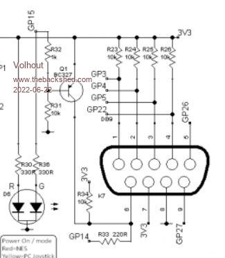

Your design has a 150ohm resistor to power the NES controller. I am not sure if I have this right, but the schematics I found on the web for the NES controller had 1k pullups to the switches (they use this low resistance to prevent high impedance wires that pickup noise when no key is pressed). When all keys are pressed there is 125 ohm load. And 150 ohm series. So the 4021 is powered from 1.4V where 3.3V was normal.
Maybe newer controllers have different pullup resistors. If not I think this resistor needs to be 10 ohm or so.

  Quote  I am not sure if I have this right, but the schematics I found on the web for the NES controller had 1k pullups to the switches.

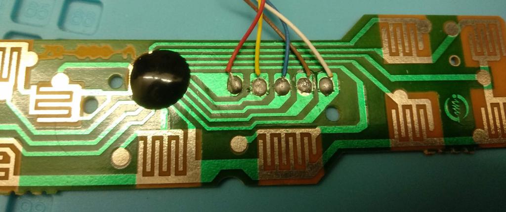

I think I've also seen it diagrammed with 10K pull-ups, my breadboarded one uses 4.7K pull-ups and my perfboard one uses 3.6K (SMD) pull-ups; it looks like there is a lot of wriggle room, but perhaps that is at 5V. The AliExpress controllers and my original old-stock clone Famicom controller have no discrete resistors:
New old-stock Famicom controller PCB - apologies that it's cropped I just grabbed a random photo from my archive.
Edited 2022-06-21 21:43 by thwill

This board revision you need to to make sure GP15 is set correctly.

  Volhout said  This board revision you need to to make sure GP15 is set correctly.
We are definitely getting our "knickers in a twist"; that schematic is derived from the prototype board as it shows the bi-colour power/mode LED that isn't required by the v1.4 board - which IIRC also doesn't use GP15 to set the mode - I think Mick did something "clever"; possibly something you might consider "god damn awful" as a working professional .

If you have the Blue pcb (version 1.4) please don't even consider looking at the circuit for the red (prototype) one. They are different in many ways. That drawing is derived from the prototype circuit. The blue PCB doesn't have that transistor at all, just a simple resistor to light the LED from the supply.
Until I discover that controllers don't work with 150R supply resistors I'm unlikely to complicate things further - especially as it would mean controlling both sockets and I've no spare pins since I put a Fire button on Port B.  :) I think that reducing the value a little might be ok, but 10R (330mA) would sink the 3.3V supply completely with a single fire button. Two joysticks would stand no chance. I know it's not a great design, but it's simple and rugged - you can hold the fire buttons on both joysticks down all day at 44mA in total.

On my blue board, K8 is powered from GP14 that I set high. By doin that you power the NES through it's FETs 50 ohm. Better than 150 ohm, and you can use 10k pullup for the fire button....when GP14 is input.

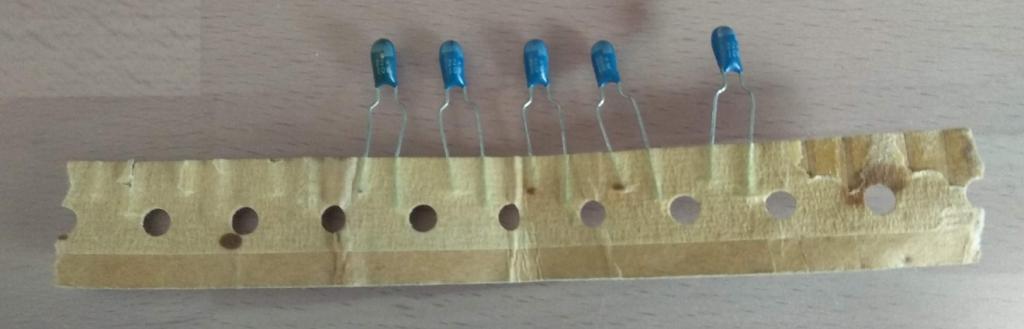

I made some progress with my soldering last night but I need to wait for some new 22uF tantalum capacitors; the ones I had in stock look like they have been in storage since the 70's and don't test reliably with my shonky *Chinese* component tester.

@thwill
"22uF tantalum capacitors; the ones I had in stock look like they have been in storage since the 70's and don't test reliably"
You may not want to bother with this but it may be possible to re-form the dielectric in the tantalums.
Stick them in a breadboard with a 10k resistor in series with each and apply a voltage a little under their rating and leave on overnight. Then measure the leakage current by measuring the voltage across the 10k. Any that are less than 10uA (100mV) are good.
Posts: 4410
Posted: 01:15pm 22 Jun 2022
  phil99 said  You may not want to bother with this but it may be possible to re-form the dielectric in the tantalums ...
I truly appreciate the "teaching moment" @phil99 but since I received them I've had my doubts and I can replace them (with less shonky looking, but no doubt still Chinese, capacitors) for a couple of quid.
