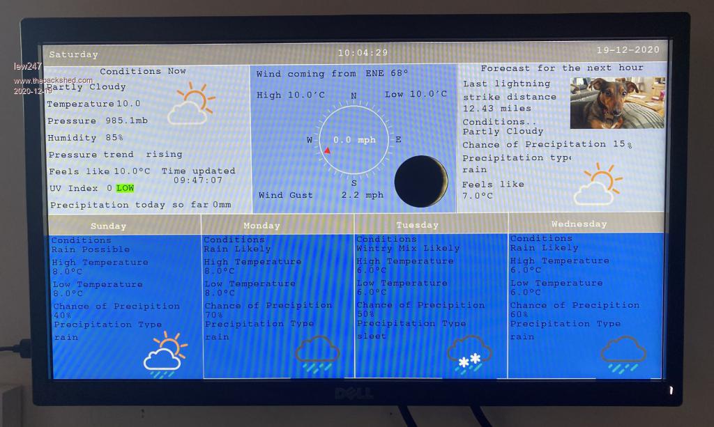

This is what I've been working on trying to get right
I know it looks pretty pathetic compared to what you experts could do but I'm happy ish with it - happier once min and max actually works
it's a 19inch monitor with the pi zero
Once it's done the pi and power cable will be hidden behind the monitor
Edited 2020-12-19 04:59 by lew247

I didn't like the pictures so went back to icons
It's a shame you can't do a "save image as" when it's using HDMI, the line scans ruin the picture, but it looks much better live

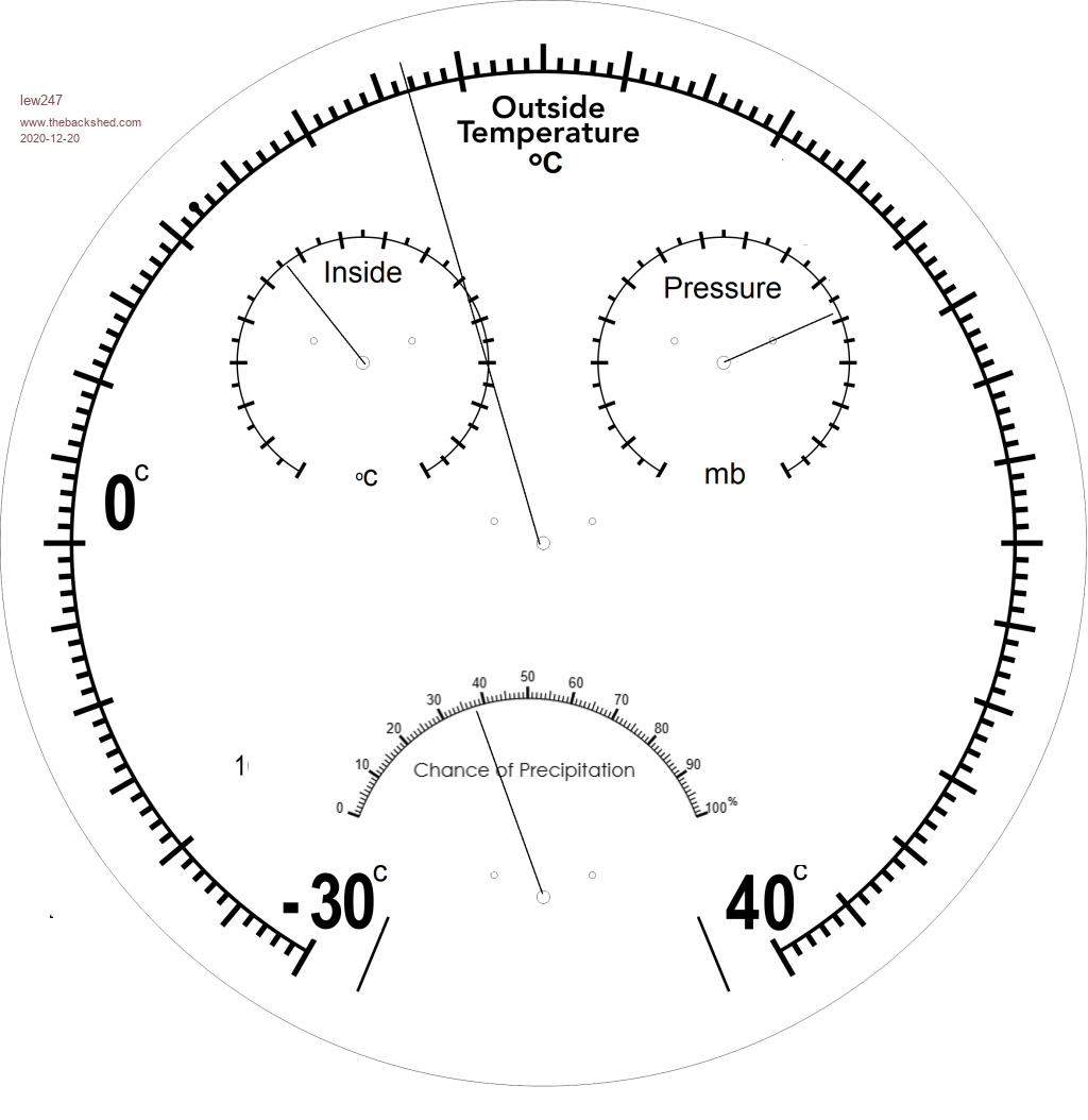

It's data from my Weatherflow weather station Lance  Weatherflow Weather Station
I download if from their server after it's uploaded there because they add the forecast information based partly on data collected from stations nearby  and it's a lot easier this way
I'm using the ESP32 to download the data, and then UDP it to the Pi to decode/display
I've also changed the moon phase picture now so it's not so "full in your face"
I'm displaying it on the 19inch monitor but I'm going to also make something like this after Christmas to pop on the other wall
It will have pointers driven by small stepper motors from a car dash and using the Armmite it should run on batteries for a long time, picking up the data from the Pi by HC-12
You can see the display better here Display
