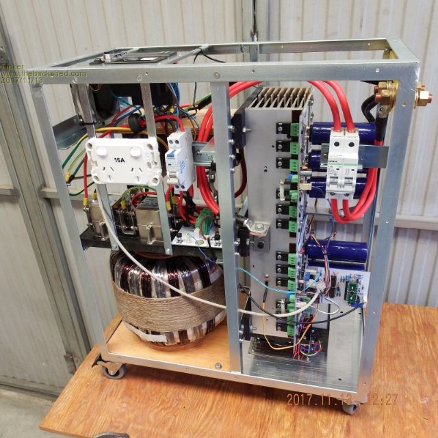

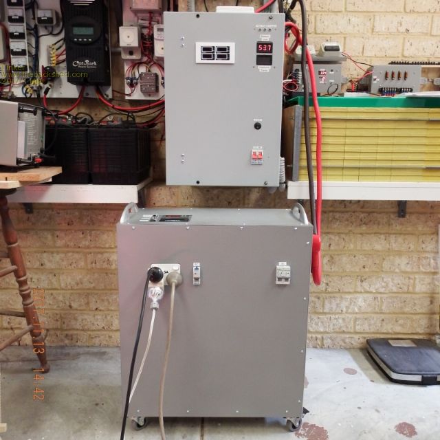

"So, does it work then? I hear somebody asking
You bet it does."
Thats what I have been waiting for.
Do you have any clues what stopped you before from getting these results.
It seems once you get one running properly, every next one you make works straight up.
Mad had a run of outs too, and we still have no firm idea as to why. Now he cant seem to kill it from the looks.
You do very nice work with a lot of time put in, wish I had your patience.
Well done, a 6kw result, with plenty in reserve looking at the fet count and cooling.
You have indeed been busy.
..........oztulesEdited by oztules 2017-10-02
Posted: 11:41am 01 Oct 2017

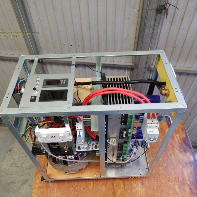

An absolutely stunning result there Klaus, extremely professional!
There has obviously been a huge amount of mechanical design work, time, thought, and know how go into this, and it really shows.
Most impressive.
I still have not purchased a digital camera, and have been thinking about the problem of focusing small objects up close, particularly PCBs and CRO screen.
The solution to this might be a document camera. A good one can focus on objects from postage stamp size up to maybe A4 sheet and produce a nice crisp high resolution image.
Previous experience with one of these suggest the depth of field is not great, but perfectly adequate for a circuit board or single small objects. Never tried it with an oscilloscope, but see no reason why it should not work well with that too.
Posted: 12:11pm 01 Oct 2017
One question Klaus, how did you cut the heatsink ?
My best efforts in that direction so, far have been with a brand new (and very sharp) tungsten tipped panel saw blade, one with the largest number of small teeth, and lots of WD40 as a cutting lubricant.
Cutting aluminium will totally destroy the blade in two or three cuts, but as the blades are not that expensive, a new blade will be junk after a job like this. Best to buy a couple of blades...
There will be a blizzard of aluminium chips that fly everywhere, so its best done outside.

Thanks for the kind words.
Sorry to say that a metal cutting bandsaw would do nowhere near as good a job with this heat sink as a circular saw with a reverse angle teeth alu cutting blade.
I do have a metal cutting band saw and there is no way the cut is smooth enough for what I required... So one needed a milling machine to smooth it and I don't have one.
Posted: 12:28am 02 Oct 2017
Oztules, I think we can best call it 'senior moments' when defining the reason for that many failures.
Unfortunately I get a bit exited when something is finished and am way too keen to switch it on, when I really should triple check everything first.
Then, learned the hard way, this inverter *MUST* be soft started, every time something has been changed....
Lastly, but not sure, the new 8010 board has a ground plane. The others were just single sided home etched boards.

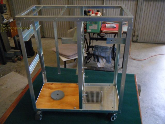

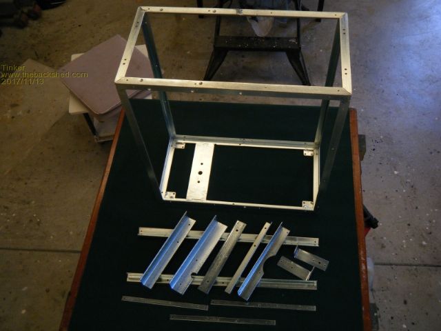

Now I will be busy for a while to make an enclosure for it, a decent looking one this time.
Thanks to everybody contributing their valuable knowledge and get me up to speed with this project.
Anybody starting up an inverter build would do well reading all 38 pages of this thread and thus, perhaps, avoid some of my mistakes.

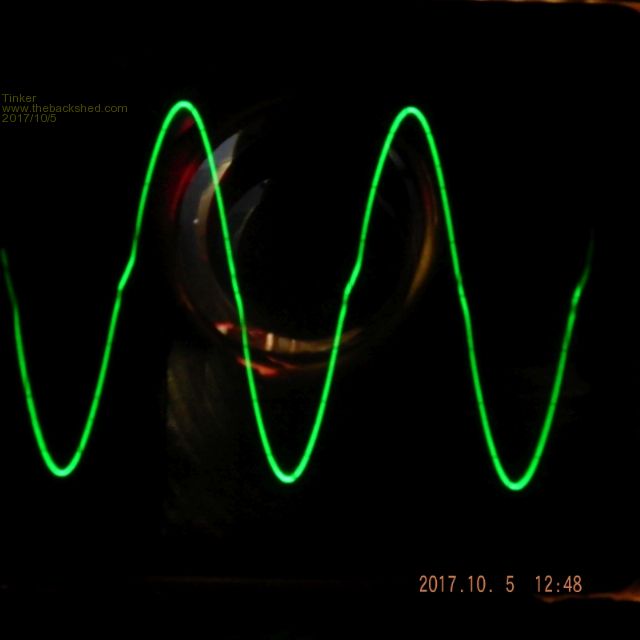

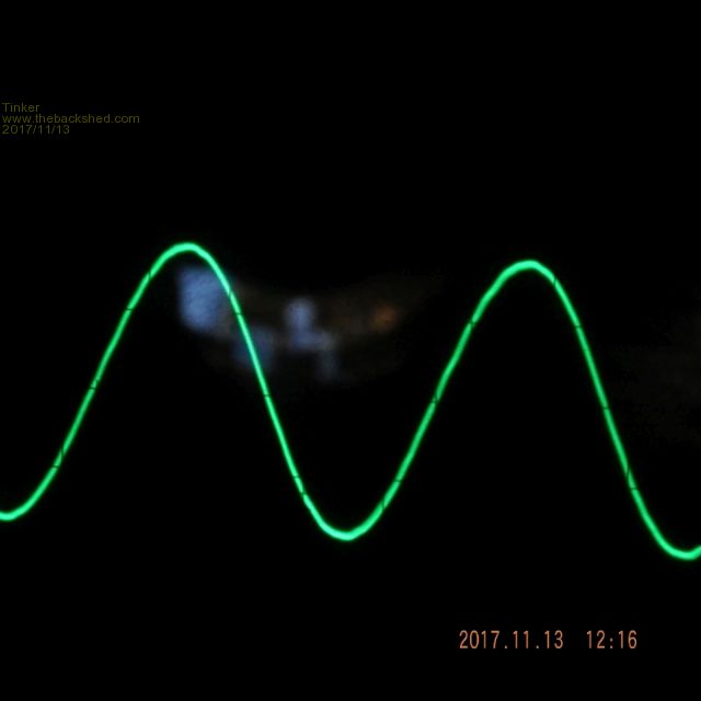

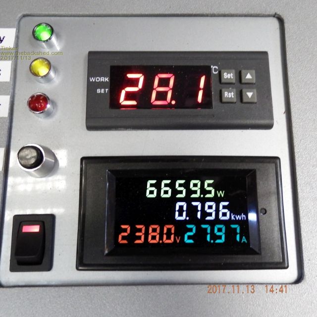

Some more testing today. This time with a 3KW load for a longer period, to see if something gets warm. My solar charging today was only 2.2KW during this test so I did not like to run a bigger load.
Anyway, this is the 3KW CRO trace now:
I'm happy with that and it appears the extra choke I connected into the other primary leg does help. So now it has the ferrite 4 turn choke (52.5uH) in one leg and the converted small Aerosharp choke (36uH) in the other leg.
If anybody is interested how to convert that Aerosharp choke let me know, I took some pics.
Total idle power (with LED power display) is now 38W, of which 29W are the magnetising losses.
And the heatsink did not get warm at all. So the over 8000sq cm of fin area are well up to the job and the 92mm fan fitted to the end of the heat sinks will have an easy life. Can't wait to put the lot into the enclosure and see if the fan comes on at all . There will be a 120mm mains exhaust fan as well, triggered by its own temperature relay.

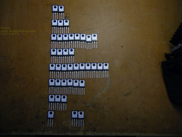

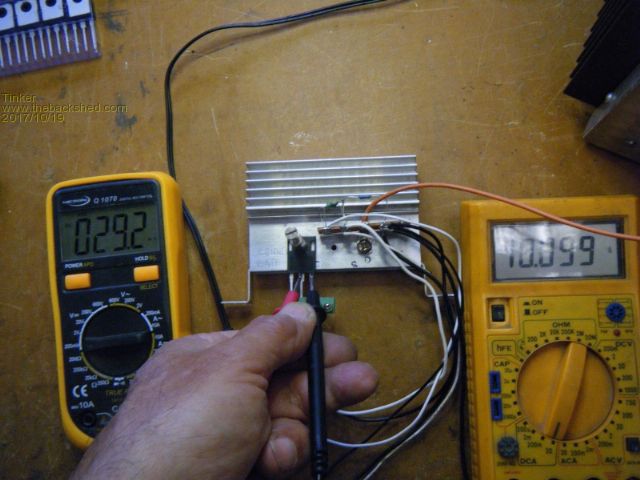

A spare batch of HY4008 Mosfets arrived today so I tested them and sorted into similar Rdson values.
40 items ranged from 2.83mOhm to 2.95mOhm.
For those who are new to selecting the mosfets to be connected in parallel - I select mine to be within 0.01mOhm (0.00001Ohm)- here is a picture of my test rig:
I use a beefy power supply (>300W) to pass 10Amps through a low value (~2 Ohm) high watt resistor. My resistor is rated about 100Watts, if only a smaller wattage is available perhaps dunking into a bowl full of water might keep it cool.
The Mosfet is mounted on a recycled piece of heat sink for mechanical reasons and, more important, for the drain current to flow via the heat sink.
There is a screw terminal connecting the gate and source pins only. This is quick to do and reliable contact wise. The gate is driven from 12V via the usual gate resistor/diode arrangement.
The power supply is adjusted for near enough to 10Amps (my power supply does not adjust fine enough with that size current)to flow in the series resistor/ drain/ source circuit.
Now the *very* important part is to place the probes of a milliVolt meter right against where the center pin (drain) and source pin enters the Mosfet body. Even just a millimeter off at the source leg gives enough voltage drop to make the readings inconsistent.
A similar current, close to 10A, should flow for each measurement and the meter probes be placed exactly at the same location for each Mosfet test.
On the mV meter the decimal point is mentally shifted to the left by one digit (2.92mV) and then the display reads in milli Ohms directly. That is why I used 10 Amps test current in the first place.
Here is a pic of the m Ohm values arranged in rows, lowest on top, highest on the bottom.

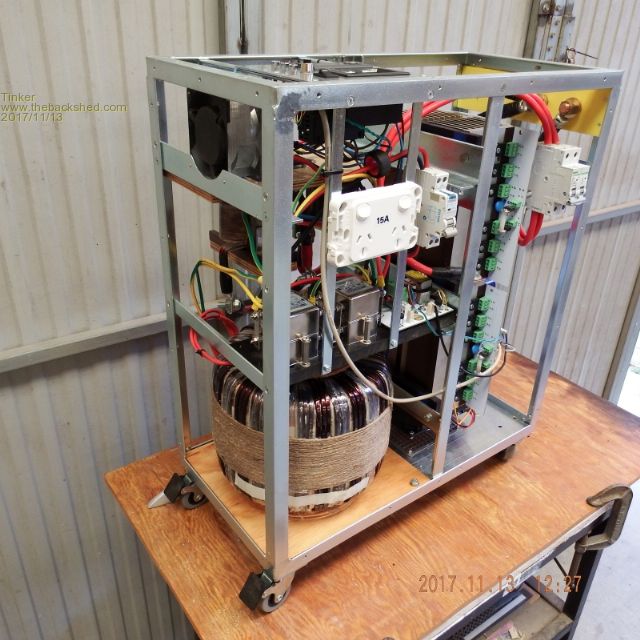

Anyway, the individual parts of my inverter have been thoroughly tested and perform as expected. So what remains is to place everything into a suitable enclosure to get a useful inverter.
I did tinker with a commercial metal toolbox which, while big enough, was made from just too flimsy metal to support those rather heavy parts inside.
So I decided to make my own enclosure, this way I get something with exactly the right dimensions and the freedom to place parts where I want them located.
How hard can it be? Not really difficult as it turned out, if one can do a bit of metal bashing.
This is what I came up with:
An angle iron frame and a stack of brackets.
Putting it all together it looks like this:

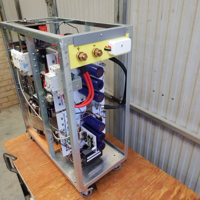

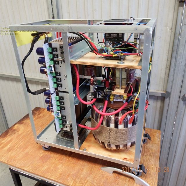

And then fitting all the parts inside. Several pictures from various angles follow:
As you can see I made it service friendly. All parts are attached to the frame so the unit can be powered up and tested with the front & side/ back & side cover panels removed for complete access to everything inside the inverter.
I learned this necessity the hard way when stuffing too many parts of my PJ inverter into a 3KW Aerosharp box...
So all that remains is to turn it on.
Idle power is 33W for the lot, about on par for a dual stack toroid core.
The idle wave form looks like this:

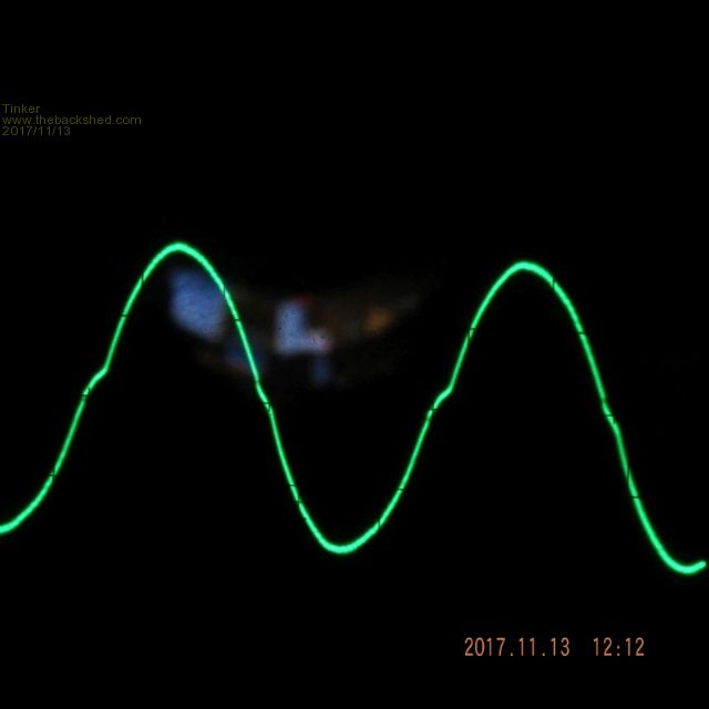

Then I started connecting loads, 2 kettles, 2.4KW fan heater & 6 flood lights. This is how far I went:
My clamp meter measured 150Amps drawn from my 54V battery bank, as much as I dared, the bank has 150A breakers fitted.
The corresponding wave form looks like this:
At idle this inverter is absolutely silent and at 6KW+ load there was a low growl which was just about drowned out by the noise of the fan heater load.
I'm happy with that
And the fans never came on at all. It really pays to fit a decent size heat sink and orient it in the enclosure so natural convection does a lot of the heat transfer.
This is the size comparison to the 3KW Aerosharp box, mounted above:
My enclosure has a similar height and depth of the Aerosharp but it is wider of course.
I was glad I decided early on to mount it on castors (lockable) as the monster weighed in at 55kg - far too heavy to hang on the wall.
Now, what's left is some more testing to see how warm that enclosure gets inside and doing 2-3KW endurance loads when there is lots of solar input to keep up the battery bank charged.
Then it will go into service, powering my house.
I had posted circuit diagrams along these pages, those who followed this marathon thread might have noticed that there were changes in them and my final inverter is no exception.
Anybody interested to see the latest diagrams please ask.
Naturally, what has finally worked out well for me might have an equally long road to success for others...
