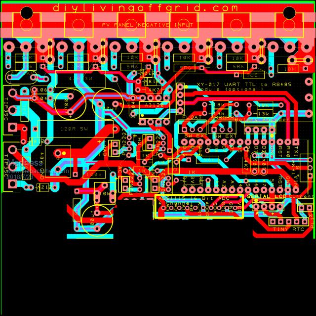

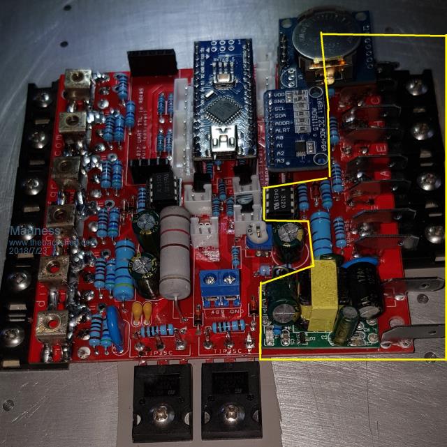

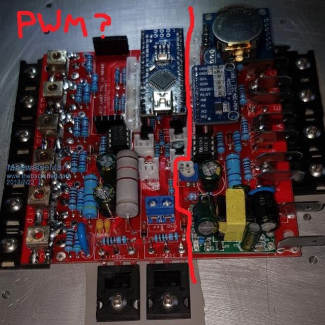

Hey Mad, if you just want to use the regulator for panels and not use the grid tie function which parts can be left out?
All the ones to the right of the line?
Cheers Caveman Mark
Off grid eastern Melb
Madness
Joined: 08/10/2011
Posts: 2498
Posted: 11:54pm 22 Jul 2018
On page 38 there is a list of which parts are needed for what in a zip file.
You need all the parts shown in the second image below.

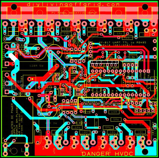

Prob should make a different thread for the charge regulator board,... but,
I am planning to use one for just panels and another for GTI controller.
So looking at the board there are two inputs/outputs for GTI's PV1 and PV2.
Each one has two 600v 20A fets so you can run up to 40A on each pvi set correct?
I'm not too sure what all the plugs are for, but to just get it operating all that needs to be connected is the hall sensor and panel in/out correct?
Cheers Caveman Mark
Madness
Joined: 08/10/2011
Posts: 2498
Posted: 08:26am 26 Jul 2018
You would be better off running both through the one regulator.
Yes there is 2 20A MOSFETs for each channel to your GTI, however your standard 5KW Inverter is not going be much above 10A on each channel. There is plenty of headroom there so the FETs don't get overloaded.
There is 2 connections for switching to absorb or float they are the 2 3 pins on the DC-DC side. the 4 2pin plugs are for vent fan, AC, dump load and hot water system. You can use as many as few of those as you need. The only essential input is the 48VDC and if you are using a GTI you need AC to the isolated power supply.Edited by Madness 2018-07-27

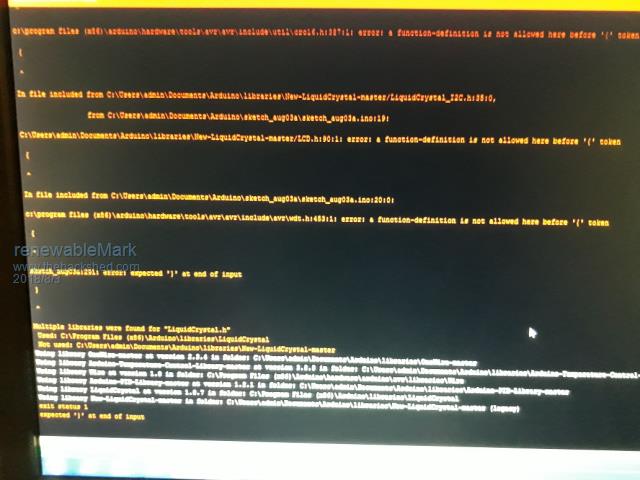

Having a bit of trouble loading software to the arduino for inverter controller.(haha that's unusual)
Cut and paste the code from p26 to the arduino and it just comes up with errors.
I deleted all the libraries and arduino software and started again from scratch.
Has this web site perhaps changed the formatting? I have seen things get altered in the past when posting on forums.
I have the arduino working properly, did the blink program and changed the blink time, re-uploaded it and it works, so the connection to the unit is fine.
Cheers Caveman Mark
Madness
Joined: 08/10/2011
Posts: 2498
Posted: 11:08am 03 Aug 2018
What are the errors?
renewableMark
Joined: 09/12/2017
Posts: 1679
Posted: 11:19am 03 Aug 2018
If you click on file/preferences/check boxes for show verbose it comes up with detailed f ups.
Below is the orange text from my failed upload.
In file included from C:\Users\admin\Documents\Arduino\libraries\OneWire-master/OneWire.h:9:0,
from C:\Users\admin\Documents\Arduino\sketch_aug03a\sketch_aug03a.ino:14:
c:\program files (x86)\arduino\hardware\tools\avr\avr\include\util\crc16.h: In function 'void setup()':
c:\program files (x86)\arduino\hardware\tools\avr\avr\include\util\crc16.h:114:1: error: a function-definition is not allowed here before '{' token
c:\program files (x86)\arduino\hardware\tools\avr\avr\include\util\crc16.h:180:1: error: a function-definition is not allowed here before '{' token
c:\program files (x86)\arduino\hardware\tools\avr\avr\include\util\crc16.h:254:1: error: a function-definition is not allowed here before '{' token
c:\program files (x86)\arduino\hardware\tools\avr\avr\include\util\crc16.h:321:1: error: a function-definition is not allowed here before '{' token
c:\program files (x86)\arduino\hardware\tools\avr\avr\include\util\crc16.h:387:1: error: a function-definition is not allowed here before '{' token
In file included from C:\Users\admin\Documents\Arduino\libraries\New-LiquidCrystal-master/LiquidCrystal_I2C.h:35:0,
from C:\Users\admin\Documents\Arduino\sketch_aug03a\sketch_aug03a.ino:19:
C:\Users\admin\Documents\Arduino\libraries\New-LiquidCrystal-master/LCD.h:90:1: error: a function-definition is not allowed here before '{' token
In file included from C:\Users\admin\Documents\Arduino\sketch_aug03a\sketch_aug03a.ino:20:0:
c:\program files (x86)\arduino\hardware\tools\avr\avr\include\avr\wdt.h:453:1: error: a function-definition is not allowed here before '{' token
sketch_aug03a:291: error: expected '}' at end of input
Multiple libraries were found for "LiquidCrystal.h"
Used: C:\Program Files (x86)\Arduino\libraries\LiquidCrystal
Not used: C:\Users\admin\Documents\Arduino\libraries\New-LiquidCrystal-master
Cheers Caveman Mark
renewableMark
Joined: 09/12/2017
Posts: 1679
Posted: 11:23am 03 Aug 2018
Looks like this.
