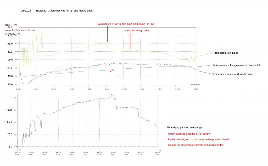

29/07/21       Thursday  ...  forecast was for 18 degrees and mostly clear.
Even though I had checked the battery voltage a few days ago  ...  I finally woke up to the fact that the battery was probably going flat in the outlet logger because the display started to look pretty faded when I pressed the button to show the display.
Under a 3mA load they all dropped to about 2.8v  ...  so tonight I replaced them all.
The day started with the first fan run about 8:17  ...  same time as last few days.
The fence shades the bottom third of the array at that time  ...  so on the roof should start earlier if good sun.
It's unfortunate that the output logger's data was corrupted as there was some useful info that was missed.
I've placed that chart below but even though it ran for the same length of time as the others  ...  its final data point was at 14:01  ...  while for the others it was at 16:33

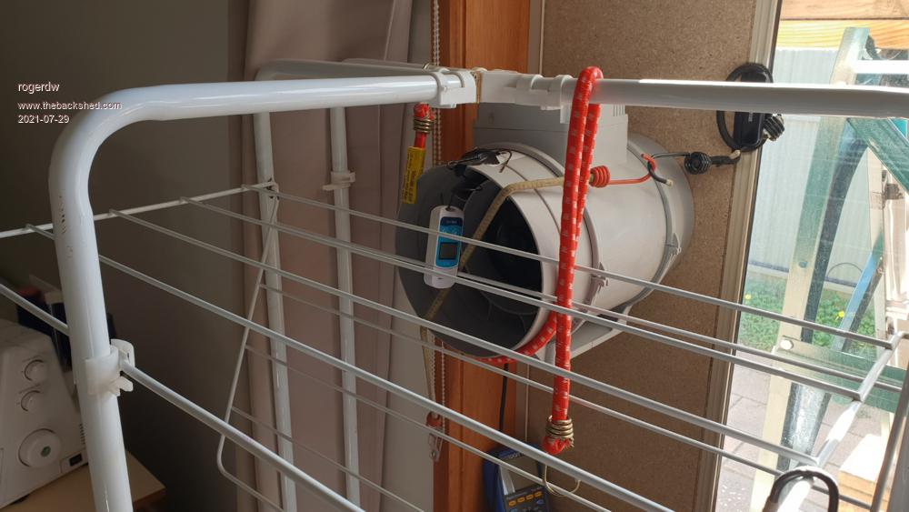

After the discussion this morning I decided to fit the 8 inch inline fan on the outlet to help suck the air out of the tubes  ...  while still keeping the original fan blowing air through.
You can clearly see the point that I turned it on at 12:22 because the temperature in the tubes nose dived as more heat was being sucked out.
There wasn't a corresponding drop in sun temperature  ...  so can't blame that.
The only issue is that at 13:22 I switched the fan to high speed  ...  and you cant really see any major effect.
It does seem that the inside temperature took a leap forward at that point  ...  though I do wonder if it was because I was mucking about fitting the fan and held it all back for a while  ...  and then once it was free to run  ...  it caught up quickly. Not sure.
The inside temp went from a low of 14.8 up to 20.9 degrees  ...  that's a 6.1 lift.
There was no cycling at the end of the day because the big fan was not connected to the differential controller  ...  and when I saw the output was down to 25, I turned it off manually.

Posted: 10:05am 29 Jul 2021
It seems more air is noticeably better.
It should make an even bigger difference with the larger system.

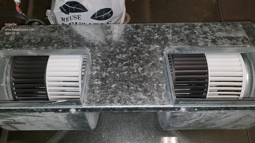

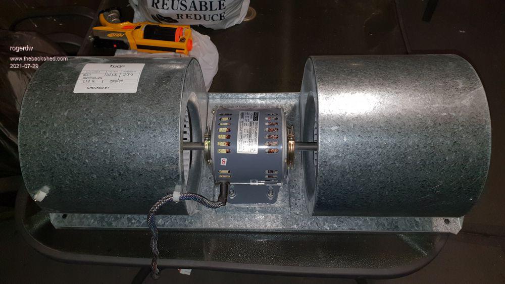

It's a real pity I wrecked that other 6" fan  ...  it would be just right to assist the other one.

So my 6" and 8" inline fans are not going to be a good fit  ...  and I will have to find something more substantial.
I have done a lot of reading over the last few weeks and was starting to lean towards a decent sized centrifugal fan to push a decent gale through the heater  ...  and then channel it to the different rooms at the other end.
Those ducts can be smaller of course  ...  probably 8 inch ducts.
I've mentioned my scrappee mate who wrecks lots of airconditioners  ...  well when I visited him last I spotted this really clean and nice looking dual fan assy  ...  and once I'd drooled over it, he said to take it home.
I can't see this one being a fit in my new system  ...  but I'll bet he has something a lot closer in his megapile of dead aircons. Of course, there's no point going through all his stuff until I have it clear in my mind, just what I'm looking for.

  Warpspeed said  At 6.3 m/sec I think the washing will be swirling around the room.
Enter with extreme caution, and hang onto your hat.
When I switched it to high  ...  it was 7.1 m/s  ...  plus started to sound like it was going to take off.
Cheers,  Roger

Something like this single entry blower might have roughly about the right proportions and should develop a usefully high pressure at not too high rotor tip speed to become really noisy. Just as Dave suggests, the classic "jumping castle" style of blower might make an excellent starting point.
A big fat double entry blower like this one, can shift a lot of air, but will be very lacking in pressure. Attempting to drive it faster to gain pressure will suck up a lot of Hp.
Going to the other extreme, this really skinny blower could develop phenomenal pressure at a very high (and noisy) tip speed, but would be seriously lacking in flow.
With a practiced eye, and a few figures its possible to tell just by looking the probable flow and pressure capability, along with the rating plate on the motor.
Edited 2021-07-30 01:45 by Warpspeed
That made me laugh!  Turn the whole room into a Clothes Drier and wouldn't they come out soft and Fluffy!  Hope the cat don't walk in there!
  Quote  When I switched it to high  ...  it was 7.1 m/s  ...  plus started to sound like it was going to take off.

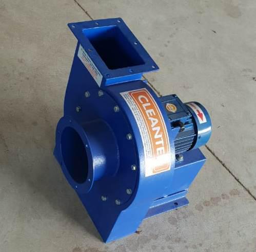

  Warpspeed said  Something like this single entry blower might have roughly about the right proportions and should develop a usefully high pressure at not too high rotor tip speed to become really noisy. Just as Dave suggests, the classic "jumping castle" style of blower might make an excellent starting point.
A cheap source of those I have found is Dust extractors.  I see them from time to time on Dumbtree and Market place etc going cheap. They are usually 6 and 8" so would size up well.  I have one I picked up outside a factory because it looked like someone kit the power lead with an angle grinder or something and they Chucked it. New lead, works perfect. The amount of air and pressure is terrific but it's also very quiet. The rush of the escaping air is far louder than the machine itself. Mine also seems really well balanced, runs like a Turbine.  I think Mine has a 1.5 Ho motor but could be  tuned to the flow and pressure Roger requires with a PMW.
I think if he could get hold of one at the right price and they often go cheap round here, that may be better than the Jumpy Blower.  Those things will Definitely take the hat off your head and your hair as well  especially if it's thinned like mine!
I have got pretty good at that now. You learn what they are going to do just by blade / impeller size and type.  I have one of those little Ducted fan motors and the amount of air and flow that generates is amazing but you can see from the blade shape and number it's going to crank air but the speed.  I also have a blower than came off a Church Organ.  That has a very large housing and is belt Driven from an induction motor.  The pressure on that is pretty substantial.  I Figured it was restricted when I got it but the way the thing spooled instantly so I got the plasma and enlarged the small inlet opening.  It increased the flow and pressure substantially and has slowed the thing a little as it has less of a high pitched wail now.
