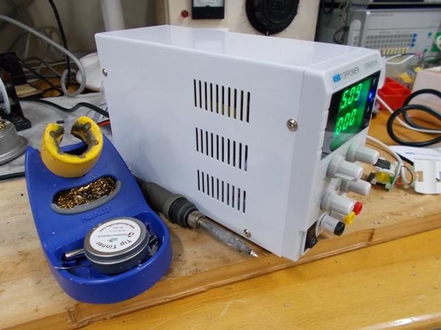

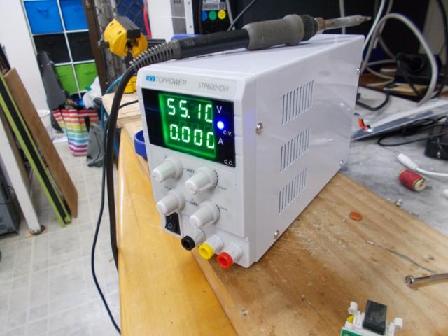

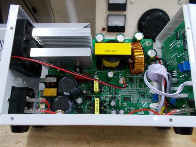

FYI: I'm sick of carting a Heavy Dual Tracking Supply over to the inverter when I want to safely power it with a current limited supply for tests or adjustments, or when testing various solar build devices on the bench that require up to 60V DC and current limited from a few mA to a few A.
This very small 0-60V, 0-5A 300W supply with constant current [0-5A] weighs just a couple of kg, 226mm x 82mm x 138mm.
It had no trouble starting and running the Inverter and switching loads of 280W. Don't know why I never grabbed one before, I couldn't make it for the price. $100 for the 3 digit version and $114 for the 4 digit version from Amazon au. Next day delivery.
I ran it for few hours powering the inverter with a 280W load and it runs almost cold, a "very quite" fan starts up with loads. The displays are quite accurate and not like the normal garbage I've tested.
An idea of the size. It looks and feels like a well made unit, even the case is thick metal and the fit and finish are spot on.
Edited 2023-08-23 15:46 by KeepIS

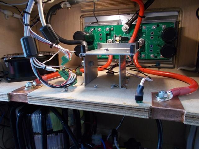

More info on the new controller board and the "ground plane" implementation in the inverter.
Wiseguys controller board has a PCB ground plane connection via one mounting hole on the PCB, the PCB ground plane is not a connection to the boards common 48v negative tracks or connectors.
The difference in noise on the 48V positive and negative supply tracks, connections and circuits on the board is significant, it's worth every second of the time it takes to get this connection right.
I was also aware the systems common negative connection to the aluminum ground plate would have to be at least 25mm copper, and no more then 150mm long to have any chance of working correctly. Testing showed a connection from the Inverters common Negative DC input mounting plate to the aluminum ground plane bolt was the most effective for reducing noise.
That connection is just above the controller board where the common negative DC input bonding plate is bolted straight through from the Top switch/Interface deck of the Inverter cabinet, thus allowing the shortest direct connection to the power board and now to the controller ground plane, obviously both are mounted in the middle Deck which houses the Power and controller boards.
Below: Aluminum Spacer with external Ground plate for mounting the PCB.
System common connection to the Ground plate is on the LH side of the Bracket.
BELOW: The New test board with those lovely big plug in connectors. Takes about 20 seconds to remove that board.
Mike [Wiseguy] pointed out that the hysteresis for the onboard dual Fan controllers would need tweaking, and I've spent a bit of time getting the values correct for my use, which is cooling the only thing that gets warm in the inverter, the Transformer.
This is such a huge heavy lump of iron, temperature sensors sit between the bottom two of the three stacked toriods, and are therefore sandwiched between their secondary windings, so normal hysteresis values for heat sinks are way out, very little hysteresis is needed, like around 2 deg, it's now working very well.
