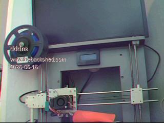

The camera works excellent with HDMIUSB. Colours look really good and natural and the picture is quite sharp with good Autofocus. Thank you for the improvements!
If it would work in terms of speed a buffer would make sense to me if PSRAM is present.
List system i2c works fine for me.
FM and its help look clear. When copying files the status of the copy process should be displayed immediately. I tend to wonder if I pressed the button correctly..
> option list
PicoMiteHDMI MMBasic USB RP2350B Edition V6.03.00RC20
OPTION SYSTEM I2C GP4,GP5
OPTION FLASH SIZE 16777216
OPTION COLOURCODE ON
OPTION KEYBOARD US
OPTION PICO OFF
OPTION RESOLUTION 640x480 @ 378000KHz
OPTION DISPLAY 30, 53
> mode 4 : camera open gp24,gp25,gp26,gp27,gp28,gp32,qvga
> do : camera capture : loop until inkey$ <> "" : save image "test1.bmp"
The picture on the HDMI monitor look also very nice in QVGA:
