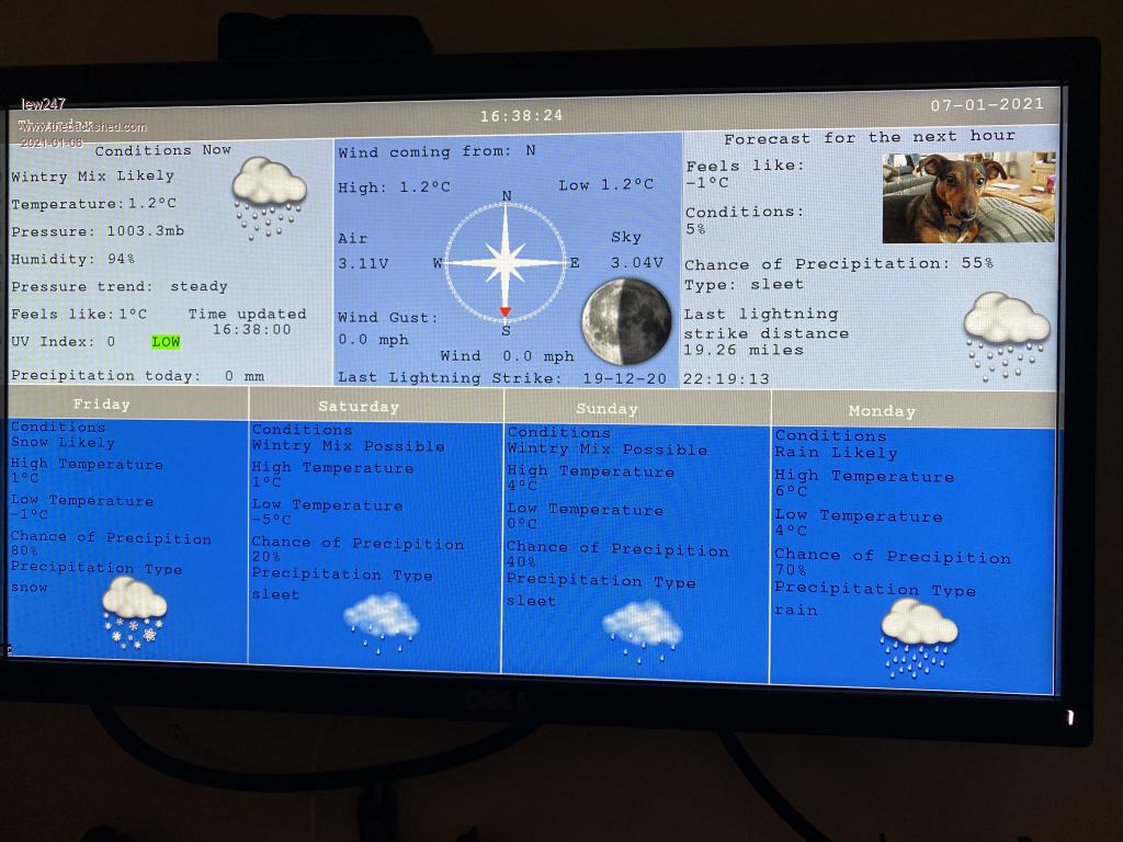

Posted: 02:31pm 07 Jan 2021
I'm pulling what little hair I have left out on this one
I've completely redone my code so it's all processed with a Pi 3+ now instead of a Zero and Esp32
I've got everything "I think" perfect other than this one thing
It's meant to place an image of the current moon phase on the screen
BUT it's not working
It only places Image 1.bmp on the screen
I've tried everything I can think of to try and figure out why it isn't working
Including reading the manual again and as far as I can see I have it correct and it should work
Can anyone see the stupid mistake I've obviously made?

Posts: 3885
Posted: 03:39pm 07 Jan 2021
Which image are you getting? What's the result of your print statement?
Can you replace the whole thing with this?
dim string sImage
sImage=str$(int(moonage+.5))+".bmp"
Load image sImage,910,270
print moonage , "Moonage", sImage
lew247
Joined: 23/12/2015
Posts: 1709
Posted: 03:58pm 07 Jan 2021
  lizby said  Which image are you getting? What's the result of your print statement?
dim string sImage
The result of the print statement at this moment is 24.03748008
What does sImage=str$(int(moonage+.5)) produce?
I can't work out what it means (sorry)
There are 30 images of the moon, titled 0.bmp to 30.bmp one for each moonpase as it appears
example at this moment it should be
but it's displaying
jirsoft
Joined: 18/09/2020
Location: Czech Republic
Posts: 533
Posted: 04:17pm 07 Jan 2021
  Quote  What does sImage=str$(int(moonage+.5)) produce?
It's just rounding number to whole number and convert it to string (and then later add ".BMP" to it, so for example from moonage=3.72 will be sImage="4.BMP"), but simpler is (CINT(x) = INT(x + 0.5)):
LOAD IMAGE STR$(CINT(moonage)) + ".BMP", 910, 270
Edited 2021-01-08 02:17 by jirsoft
Jiri
lew247
Joined: 23/12/2015
Posts: 1709
Posted: 04:37pm 07 Jan 2021
Thank  you both so much
That works perfectly and I actually understand what it's doing as well now

I know it's possible with the CMM2 but I can't waste one of those for this project even if I did have one
 dim cx% = 785
 dim cy% = 238
 dim wid% = 105
 dim ang! = 0.087266463
 Circle mm.hres/2,mm.vres/4 + mm.vres/32,90,2,1,RGB(WHITE),RGB(134,174,230) 'Centre
sub compass_rose cx%,cy%,wid%
     local a%
     for a% = 0 to 90
       line (cx%+15)+(cos(a%*ang!)*(wid%*.85)),(cy%+15)-(sin(a%*ang!)*(wid%*.85)),(cx%+15)+(cos(a%*ang!)*(wid%*.9)),(cy%+15)-(sin(a%*ang!)*(wid%*.9)),,RGB(WHITE)
     next
     text cx%+9,cy%-wid%+5,"N",lt,4,1,RGB(BLACK),RGB(134,174,230)'
     text cx%+9,cy%+wid%+5,"S",lt,4,1,RGB(BLACK),RGB(134,174,230)'
     text cx%+wid%+8,cy%+4,"E",lt,4,1,RGB(BLACK),RGB(134,174,230)'
     text cx%-wid%+8,cy%+4,"W",lt,4,1,RGB(BLACK),RGB(134,174,230)'
     circle cx%+15,cy%+15,wid%-16
     circle cx%+15,cy%+15,wid%-13
end sub
This is what it's like now (I've left the centre of the compass out of the code above as this would stay in position and not move
Edited 2021-01-08 02:41 by lew247
