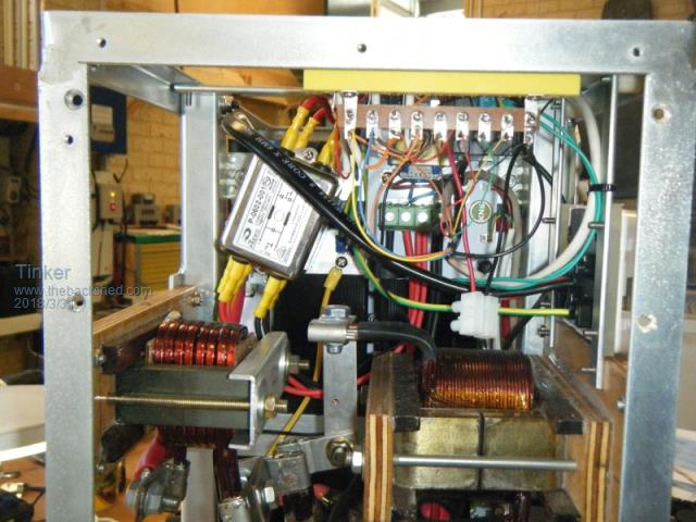

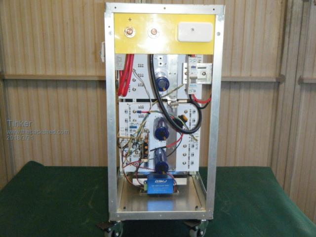

Its time to add another chapter to my long inverter building saga since inverter #3 had just passed its test.
No real surprise here as its a very close copy of that monster inverter #2 described on many previous pages of this tread.
This one has just a single 3KW Aerosharp core, rewound to my standards. And adding the extra turns paid off, just 19.3W draw from the battery at stand by. I like that.
The other difference was using only 16 x HY4008 Mosfets and only 4 of the big, expensive, screw terminal capacitors.
The cabinet is a little lower and narrower too as the smaller toroid took up less room.

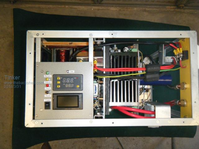

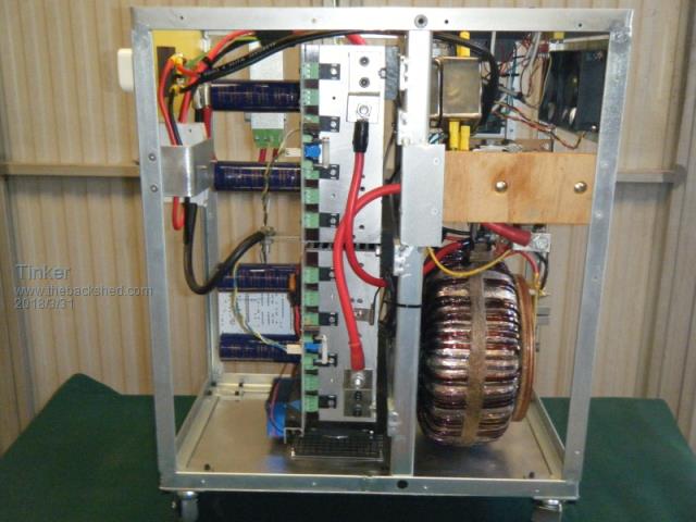

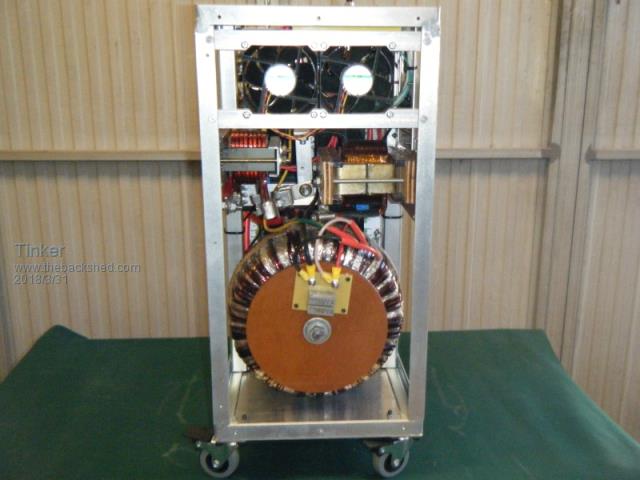

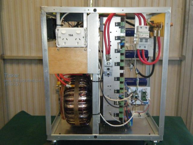

A picture gallery shown below, taken from all sides, might give other inverter builders some ideas.
Wiring under the top control panel:
Front side:
Left side:
Back side:
Right side:
View from top:

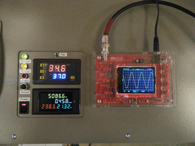

The test results did surprise me. As mentioned, it worked right away and required just adjusting of the AC voltage.
Then I started to load it up, here is a pic of the control panel at over 5KW, the trace does look acceptable too. That little brother to my two stack core inverter packs a punch!
Loading continued after this pic was taken to 6200W or so, no problems at all. But I started to worry then about pushing my luck with that 3Kw core plus the jumper lead clamp I used to connect to the battery got a bit warm from the 100+ amps.
I set the over current shut down to trip at 6KW, in use it should never see that load as this inverter is destined for light duty - literally - powering the lights in my place. Of course, it will serve as a reserve in case my bigger inverter, which powers the rest of my house takes a break for some reason.

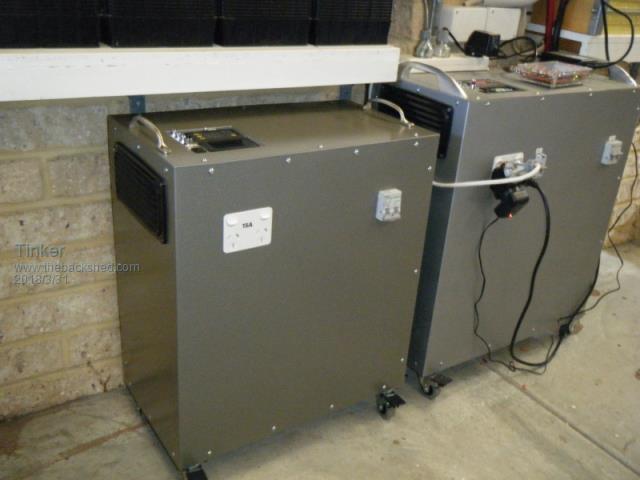

Inverter #1, my 8 (Chinese)KW PJ conversion is now retired, collecting dust on a shelf.
Here is a pic of my two inverters, #3 is on the left, not yet wired to the old LA battery bank on the shelf above. I will do a heat soak test tomorrow if there is lots of sunshine.
Boppa
Joined: 08/11/2016
Posts: 816
Posted: 05:27pm 31 Mar 2018
You seem to be going the route I am thinking about, low draw inverters for specific tasks
One thing I was thinking about, how hard would it be to 'stack' inverters (ie similar to grid ties in a way) where they are shut down until needed (like a low draw one that runs the 'night load', then as it hits its limits, another heavier one cuts in to pick up the slack, maybe another that cuts in when the heavy hitters like driers/aircons fire up
so that idling current is cut back to just the lowest level possible for most times, the heavier ones that draw more 'standby' current are actually switched off until needed
if that makes any sense?
Madness
Joined: 08/10/2011
Posts: 2498
Posted: 09:26pm 31 Mar 2018
I do something like that with GTI's, so long as the sun is shining. Getting offgrid inverter to synch is something that has not been achieved with these inverters AFAIK.
My big inverter draws 45W at idle and will run 8KW continuously if you have a decent battery bank the idle power is really not worth losing any sleep over. In my case overnight idle power draw is less than 1% of the battery capacity.

Posted: 04:56am 02 Apr 2018
Indeed it is a work of art, and there is a great deal there that many of us here could learn from.Edited by Warpspeed 2018-04-03

  Revlac said   I agree, Its a great bit of work there, I'm impressed With the output of that single core.
The secret is lots of copper sq mm in the windings IMO. The 16 HY4008 should handle that load easily.
When I did the heat up test, to see when the fans come on (set at 41 degrees) it took absolutely ages with a load of 3.3Kw. That load my battery & panels could maintain during the day without draining the battery bank.
Ambient was around 25 degrees in the shed and once the fans came on the inverter started to cool down. That is where the big cabinet pays off.
This time of the year I do not expect the fans to come on at all with the usual cycling loads at my place.
