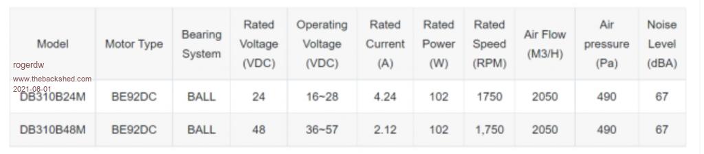

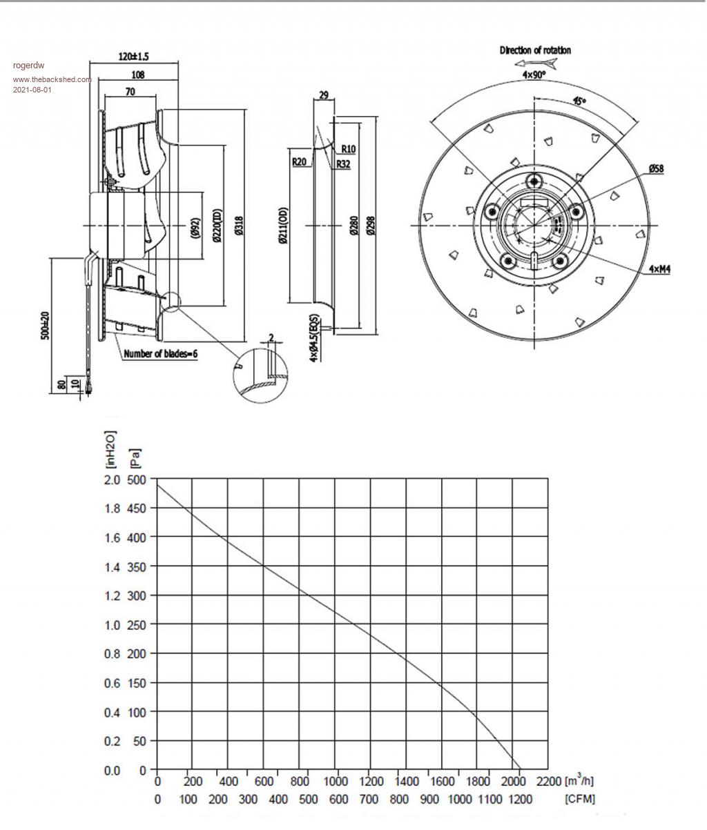

eg. my existing small 6" blauberg fan is ~50 watts and moves 500 cubic metres/hr with max pressure of 50 Pa
This fan here can move 3,434 cubic metres/hr at 633 Pa  ...
...  using 36-56V DC   5.8 A  278 Watts
So, 6.8 times more volume  ...  12.6 times more pressure  ...  5.5 times more power

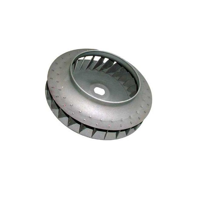

  Quote  Maybe you could do a treadmill motor on a Castle Blower but is it really worth the arsing around?
No definitely not.

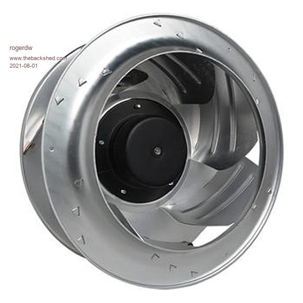

  Quote   I think a Centrifugal blower either in the ceiling or outside would be the way to go.
I was originally planning on inline fans in the ducts in the ceiling  ...  but now I'm leaning towards a fan at the end of the main duct out on the roof. Should be able to make up a housing that fits in with the unit and at least be fairly easy to get at  ...  even if it is out in the weather.
And I do like the idea of a filter as well  ...  would be an absolute pain having to dismantle the thing every couple years to clean it all out with a bottle brush  ...  no thanks.
  Warpspeed said  I have been looking at some of the specifications of those jumping castle type blowers, two things stand out, the developed pressure is not all that high, typically 1,000 pascals, about 0.145 PSi or four inches of water rise, and they are rather noisy 70db to 90db. The airflow is quite high though.
I think the next step would be to first make some measurements on your small system on a nice sunny day. We need to know the temperature rise, the air flow, and the pressure drop across the sixteen tubes, preferably using a simple water manometer.
From that we can estimate the required airflow and pressure drop for the big system, or at least come fairly close to a blower requirement.
When you suggest the developed pressure is not all that high, typically 1,000 pascals  ...  that's still 20 times higher than my existing fan. Do you think it needs to be that much more?

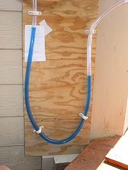

I've looked up how to make a manometer  ...  how do you attach it in my case  ...  does the end of the duct have to be blocked so the pressure can act on the end of the tube?  ...  or how/what?

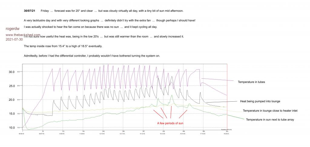

Todays results seemed a bit unusual  ...  and with the cloud we had I was surprised to see the fan run at all  ...  let alone cycle on and off all day.

The control system is working great, there may not have been much sun, but you still gained about four degrees in the lounge throughout the day.
  Quote  When you suggest the developed pressure is not all that high, typically 1,000 pascals  ...  that's still 20 times higher than my existing fan. Do you think it needs to be that much more?
Its very difficult trying to guess what your back pressure is likely to be, or what may be required. "High" is a relative term. An actual measurement would help a great deal.
A water manometer is a very easy thing to make. All you need is some clear plastic tube with some water trapped in it.
Any difference in air pressure forces the water to rise and fall. Pressure is measured in "inches of water" the difference in heights between the two columns.
In fact it's the most accurate way to measure very low pressures.
Just drill suitable holes in your two manifolds, and insert the ends of your plastic tube, its as simple as that.
The other thing we need to know is the CFM airflow that corresponds to that pressure measurement. With those two figures we can then come up with a reasonable blower requirement for your big system.

  Warpspeed said  The control system is working great, there may not have been much sun, but you still gained about four degrees in the lounge throughout the day.
Yes, I was surprised to see any activity at all, so have to be happy with the results.
Wasn't expecting much from today either due to the forecast  ...  cloud, rain, 90% chance of 5-20mm  ...  yet the sun is out and we've had half a dozen cycles already.
  Quote  A water manometer is a very easy thing to make. All you need is some clear plastic tube with some water trapped in it.
I watched a few youtube videos yesterday to get the concept, so that's under control  ...  but the holes we want are so we can measure the pressure near the start of the duct and also one near the end?  ...  or between the start and the end?

Thanks  ...  so one end of the tube open to atmosphere and other end into manifold.

First, the outlet duct has an internal cross sectional area of .1726 square feet.
By itself - the original 6" fan on High Speed
(Specs. 50W - 560 cubic mtr/hr)
Inlet Manifold = 5/8"
Outlet Manifold = 3/16"
Outlet Air Velocity = 14.0 ft/s
Added 8" fan (on Low) blowing into inlet manifold ... assisting 6" fan
(Specs. Low 76W - 805 cubic mtr/hr)
Inlet Manifold = 1-1/8" (one and one eighth inch)
Outlet Manifold = 7/16"
Outlet Air Velocity = 19.0 ft/s
8" fan (on High) blowing into inlet manifold ... assisting 6" fan
(Specs. High 108W - 1080 cubic mtr/hr)
Inlet Manifold = 1-5/16" (one and five sixteenths inch)
Outlet Manifold = 3/8"
Outlet Air Velocity = 19.35 ft/s
Cheers,  Roger

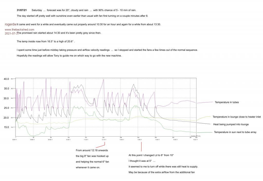

31/07/21       Saturday  ...  forecast was for 20 degrees, cloudy and rain  ...  with 90% chance of 5 - 10 mm of rain.
The day started off pretty well with sunshine even earlier than usual with fan first turning on a couple minutes after 8.
It came and went for a while and eventually came out properly around 10:30 for an hour and again for a while from about 13:30.
The promised rain started about 14:30 and it's been pretty grey since then.
The temp inside rose from 16.5 to a high of 20.6
I spent some time just before midday taking pressure and airflow velocity readings  ...  so I stopped and started the fans a few times out of the normal sequence.
Hopefully the readings will allow Tony to guide me on which way to go with the new machine.
It seems to me that the extra airflow through the system is extracting more heat from the tubes than normal  ...  and a couple times I thought that the fan turned off before it was necessary.
I finally woke up to the fact that the Ld was set to turn off when the outlet temp got to within 10 degrees of the room temp  ...  I though I had it set to 5 degrees.
Rather than make too big a jump, I changed it to 8 degrees and will watch how that affects things.
Cheers,  Roger

Hi Roger, I have been away most of the day but have just now returned.
O/k those figures are extremely helpful.
First looking at just the small 6" blower running at high speed.
Inlet manifold 0.625 inches
Outlet manifold 0.1875 inches
Pressure difference 0.4375 inches.
Output velocity 14 ft/sec multiplied by 0.1726 square feet = 2.4164 cubic feet/sec or 144.98 CFM.
The blower is rated at 560 cubic metres per hour (open flow) x 35.31 = 329.56 CFM.
So 0.4375 inches of back pressure reduces our flow from 329 CFM to 145 CFM about roughly half.
That is probably a pretty fair match between blower capacity and flow resistance, but two things stand out.
Our total airflow of 145 CFM is not really sufficient to pull all of the available heat from the tubes, the tubes still get pretty hot with the blower running continuously even on a cloudy day.  The second observation is that 0.4 inches is a pitifully low back pressure, but it is high enough to really challenge the flow capacity of that axial fan.
Now when you hook up the big 8" guy on slow speed to the small 6" guy, we get:
Inlet manifold 1.125 inches
Outlet manifold 0.4375 inches
Pressure difference 0.6875 inches.
Output velocity 19 feet/sec multiplied by 0.1726 square feet = 3.279 cubic feet/sec or 196.8 CFM.
The blower is rated at 805 cubic metres per hour (open flow) x 35.31 = 28,424 cubic feet per hour or 473.7 CFM.
The big blower is being substantially blocked by back pressure, 473 CFM drops to 197 CFM. Even on high speed the flow hardly increases any further as output velocity only rises from 19 Ft/sec to 19.3 ft/sec.  The blades are just cavitating and making noise.
Open flow at high speed is supposed to be 1080 cubic metres per hour x 35.31 38,135 cubic feet per hour, or 635 CFM.
The reality is that flow has increased from 145 CFM with the small blower to 197 CFM with both blowers going. That extra 52 CFM has made a noticeable improvement to performance, although the power and noise to get that improvement is not an efficient way to go about it.
But with 200 CFM+ I believe some further worthwhile gains in heat recovery are entirely possible.
When we go to the big 60 tube system the flow area will have increased by about 333%
And the larger blower all by itself will be much happier working against far less back pressure.
The open flow rating of the small blower is 329 CFM (high speed)
Open flow rating of the larger blower 635 CFM (high speed)
I would expect the actual flow with 60 tubes might end up about double, maybe 300 CFM or something.  But our heat input will have tripled, and our hot running tubes will reach even higher temperatures.
If 200 CFM+ looks about right for the small system, multiply that by 333% and something over 666 CFM would not be excessive for the big daddy system.
That is a LOT of airflow, but if its distributed between several different vents or rooms the air movement will be less objectionable.

Posted: 08:52pm 31 Jul 2021
Blowers are almost always rated for open flow with zero back pressure. The reason for that is the motor will be working at its hardest and drawing full load current.
So a blower spec might be X cubic feet of air per minute with a Y horsepower motor, and sometimes Z inches of blocked flow air pressure.
When the blower is working against some significant back pressure, obviously the flow is reduced, but what surprises many people is the motor power (and current) decreases with increasing flow restriction. Pressure goes up, but mass airflow decreases far more, requiring less total work.
If you find that difficult to believe, fire up the wife's vacuum cleaner and put your hand over the hose to completely block the flow. You will hear the motor increase in speed. And that is the exact opposite of what most people expect to happen.
Dave is quite right,the solar tube array restriction will not be that high with the full compliment of tubes, and ducting restriction will likely become a more significant proportion of the total flow restriction.  Its getting well beyond what any axial fan can handle, and you will find that all ducted heating and airconditioning systems use centrifugal blowers of one type or another.
Axial fans are at their best for exhaust extraction through a wall, and they work very well for that.
With a centrifugal blower the pressure (and noise level) will increase with the tip speed of the rotor. We can pretty much tell how much maximum air pressure a centrifugal blower can generate just from the rotor diameter and rpm. Vacuum cleaner motors develop phenomenal pressure, usually over 100 inches blocked flow with maybe only a two inch rotor, but they run at 20,000+ rpm and are extremely noisy.
Most commercial blowers use two pole induction motors that run at around 2,800 rpm (50Hz here in Oz) so we can pretty much guess how much blocked flow pressure a blower can generate just from knowing the rotor diameter.
So we can make a wild guess from our earlier measurements and say or working air back pressure for the blower might be in the region of perhaps one inch, and a blower that can develop at least two inches of blocked flow might set an absolute minimum requirement.
Now pressure is proportional to rotor tip speed squared. A slightly larger diameter rotor gives a larger increase in pressure  than you might expect.  Similarly a slightly smaller diameter rotor and our pressure falls right away very quickly.
So we need to estimate our required rotor diameter to generate at least two or three inches of blocked flow pressure with a 2800 rpm motor.
I know from personal experience that an eighteen inch diameter rotor develops about 17 inches of pressure. A nine inch rotor would develop about a quarter of that say 4.25 inches of pressure.  An eight inch diameter rotor (8"/18" = 0.444) (0.444 squared = 0.1975) (17 inches of pressure x 0.1975 = 3.36 inches of pressure.
So my best guess is we need at least an eight inch diameter rotor, preferably a nine inch diameter rotor with the typical two pole 2,800 rpm induction motor to be in our required pressure range. The jumping castle blowers and dust extractor blowers would likely fall into that range.  Leaf blowers have smaller rotors than that and will not generate enough pressure for us unless its an especially large diameter one.
Once you find a blower with a suitable rotor diameter, a good indication of airflow capacity will be the rated motor power. A larger motor and larger ducting can tell you a lot about flow capacity. Once the blower is loaded up against some flow restriction, the motor will be running at less than rated capacity, although the motor will be sized for continuous operation at open flow.  So don't be too put off by the motor amps on the rating plate, it will end up being less than that.
This is all based on past personal experience, I have not been seriously looking at what is out there right now, but I would expect something in the 3/4 Hp to 1Hp range to be about right, but if you can get some exact specifications from a rating plate for blocked flow pressure and open flow CFM rating that would be a much better indication.
You're right, it's not what I expected  ...  though certainly I've experienced blocking the hose and hearing the revs go up. Always expected that it was detrimental to the motor when that happens  ...  but obviously not.
  Quote  Dave is quite right,the solar tube array restriction will not be that high with the full compliment of tubes, and ducting restriction will likely become a more significant proportion of the total flow restriction.  Its getting well beyond what any axial fan can handle, and you will find that all ducted heating and airconditioning systems use centrifugal blowers of one type or another.
I am surprised at that, though it's a good thing because I can't do much about the restriction due to the tubes  ...  but I can fit bigger ducting, or use more sweeping bends etc  ...  all things to reduce the ducting restriction.
  Quote  so we can pretty much guess how much blocked flow pressure a blower can generate just from knowing the rotor diameter.
Wow, ok.
  Quote  So we can make a wild guess from our earlier measurements and say or working air back pressure for the blower might be in the region of perhaps one inch, and a blower that can develop at least two inches of blocked flow might set an absolute minimum requirement.
I hadn't recalled seeing any figures relating to "blocked flow pressure"  ...  but after looking again I finally see that when they supply a graph of Pressure vs Volume  ...  that at zero airflow (blocked) the pressure is at maximum. Is that correct?
  Quote  Now pressure is proportional to rotor tip speed squared. A slightly larger diameter rotor gives a larger increase in pressure  than you might expect.  Similarly a slightly smaller diameter rotor and our pressure falls right away very quickly.
Okay now  ...  I have seen fans with those sort of specs  ...  so maybe this won't be so hard after all.
  Quote  I know from personal experience that an eighteen inch diameter rotor develops about 17 inches of pressure. A nine inch rotor would develop about a quarter of that say 4.25 inches of pressure.  An eight inch diameter rotor (8"/18" = 0.444) (0.444 squared = 0.1975) (17 inches of pressure x 0.1975 = 3.36 inches of pressure.
Haha, so much better hearing it from you than so many other dubious places on the net.
  Quote  So my best guess is we need at least an eight inch diameter rotor, preferably a nine inch diameter rotor with the typical two pole 2,800 rpm induction motor to be in our required pressure range. The jumping castle blowers and dust extractor blowers would likely fall into that range.  Leaf blowers have smaller rotors than that and will not generate enough pressure for us unless its an especially large diameter one.
That's very helpful to see those numbers, thank you. I'd been looking all the time for the very biggest fan I could find  ...  and struggling to find anything over about 300mm  ...  but sounds like that's not needed.
  Quote  Once you find a blower with a suitable rotor diameter, a good indication of airflow capacity will be the rated motor power. A larger motor and larger ducting can tell you a lot about flow capacity. Once the blower is loaded up against some flow restriction, the motor will be running at less than rated capacity, although the motor will be sized for continuous operation at open flow.  So don't be too put off by the motor amps on the rating plate, it will end up being less than that.
Again, very helpful to hear. I kept discounting certain motors because of their high power rating.
  Quote  This is all based on past personal experience, I have not been seriously looking at what is out there right now, but I would expect something in the 3/4 Hp to 1Hp range to be about right, but if you can get some exact specifications from a rating plate for blocked flow pressure and open flow CFM rating that would be a much better indication.
Okay. I had been concentrating mostly on the DC motor driven ones, so will widen my horizons. I'll post some specs from one I've been looking at and get your view on that  ...  but also keep looking for AC ones.
Thanks very much for the tutorial, I'm learning something new every day.

Dave, I have been sitting here thinking about what might work, and just had a crazy idea.
What do you know about the old air cooled VW engines? I have never owned or worked on one ever, but from pictures the rotor size might be just about right for diameter and width.

Here's a graph from a random fan I had looked at.
Has a maximum unloaded flow of 1,200 CFM but a blocked pressure of 2"H2O
  Quote  Fan Type: DC Centrifugal Fan Backward Curved 24VDC 48VDC
DC centrifugal fans with backward-curved blades are used primarily for intake suction.
Since most of the pressure build-up takes place in the impeller, there is generally no need for a scroll housing. The centrifugal fans have very good hydraulic efficiency and are ideally suited for high pressures.
The centrifugal fans are used in applications such as central air conditioning units or building ventilation systems.
This model no. is DB310B24M/48M. It works with 24v or 48v DC voltage input. Diameter size is 310mm. Impeller height 70mm. Total height with motor base is 120mm. Impeller material is aluminium sheet.
Only has a power rating of 102 watts though.
Here's the page
Cheers,  Roger
