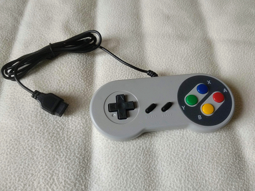

Posted: 04:32pm 06 Jul 2022
Hopefully another controller option for the PicoGAME VGA has just arrived from the Far-East:
4 directions + 6 independent fire-buttons + Start + Select
Reads like an NES controller except from a 16-bit shift-register instead of an 8-bit one.
Though whether you need all these buttons is debatable, the original NES version of Elite (not known for its limited number of controls) managed with just the standard NES controller.

Posts: 4410
Posted: 08:16pm 06 Jul 2022
Gave the "SNES" controller a quick smoke-test with @Volhout's NES PIO code and it reads the first 8-bits identically (same mapping) to the "NES" controller. I imagine reading the other 8 bits (only 4 of which are used) is simply a case of changing the PIO code to read 16 bits => 2 bytes of the FIFO after every pulse of the latch instead of 8 bits => 1 byte - Nice!

Posts: 6254
Posted: 05:37am 13 Jul 2022
  thwill said  Gave the "SNES" controller a quick smoke-test with @Volhout's NES PIO code and it reads the first 8-bits identically (same mapping) to the "NES" controller. I imagine reading the other 8 bits (only 4 of which are used) is simply a case of changing the PIO code to read 16 bits => 2 bytes of the FIFO after every pulse of the latch instead of 8 bits => 1 byte - Nice!
The PIONES 16 bit version would be like this (I cannot test since I don't have a SNES controller).So please understand this is untested code...

They are both reasonably accurate, Tom. One has a tendency to sometimes go a bit south-east rather than south, but the other is fine. UP isn't a problem on either of them. Will the joystick button moulding rotate round to a different position? I've not had either of these to bits.
Posts: 4410
Posted: 08:40am 13 Jul 2022
  Volhout said  The PIONES 16 bit version would be like this (I cannot test since I don't have a SNES controller).So please understand this is untested code...
Thanks @Volhout, I will try and give it a spin this evening.
  Mixtel90 said  They are both reasonably accurate, Tom. One has a tendency to sometimes go a bit south-east rather than south, but the other is fine. UP isn't a problem on either of them.
That's good; I'm glad I didn't send you a pair of EDIT: LEMONS, not MELONS .
  Mixtel90 said  Will the joystick button moulding rotate round to a different position? I've not had either of these to bits.
It will, but it didn't seem to make a significant difference when I played with it briefly last night. I need to give it a proper poke and also try mixing and matching parts between the working and non-working devices.
I'm currently thinking about how a program can determine what if any controllers are being used on startup - so that they can be used to navigate the game menus before the user has a chance to actually choose a controller type through the game.
- The hardware doesn't allow us to determine what controllers are attached, at least not without trying to read them and asking the user to try various input actions.
- Unlike the CMM2 the PicoMite firmware doesn't support flags to RUN so the user can't specify it that way.
My current plan, unless someone can suggest something better is that a PicoGAME VGA aware program should check for a file named "PicoGAME.ini" in the root directory of the SD card.
