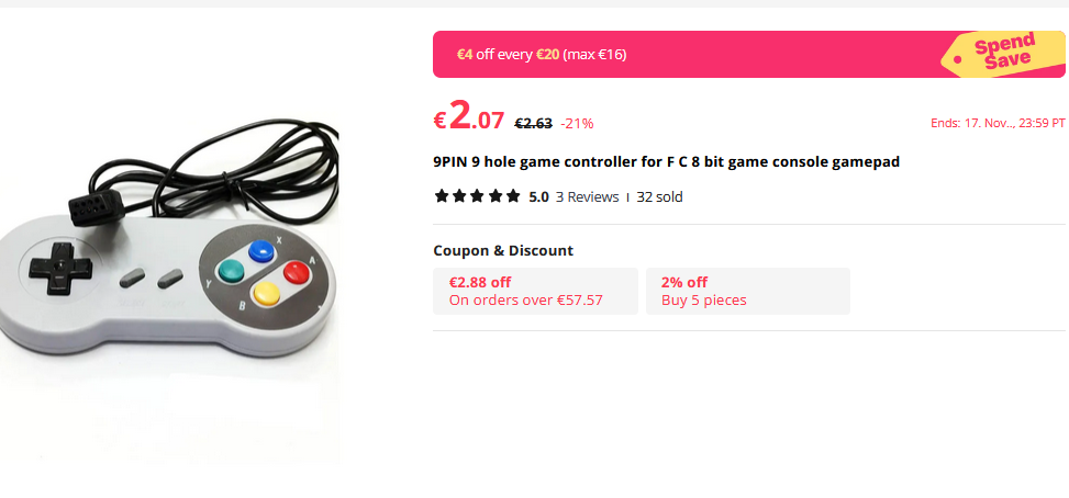

As you know I also use the PicoGAME VGA.
As I remember you also managed to get SNES Style Controllers to work on it.
I ordered a cheap clone with 9 Pin Dsub connection, which would be optimal for all controlls in this Game. Hope you can help implementing it

  Martin H. said  As you know I also use the PicoGAME VGA. As I remember you also managed to get SNES Style Controllers to work on it. I ordered a cheap clone with 9 Pin Dsub connection, which would be optimal for all controlls in this Game. Hope you can help implementing it
Oh dear .
Yes, I wrote code that will read a "proper" SNES controller, see https://github.com/thwill1000/mmbasic-sptools/blob/master/src/splib/ctrl.inc
Alas, the one pictured is unlikely to be a proper clone. I have a box of cheap controllers and never found a proper 9-pin SNES clone; though it is theoretically possible and I'm sure the Mick-collective could design a drop-in PCB for one of the "clone" enclosures.
Most likely the one pictured has NES internals and the extra buttons either duplicate A&B or use an oscillator to provide "autofire" A&B.
Another alternative that I have (though it may have a 7-pin connector that I was going to rewire) is that instead of containing the expected shift-register(s) it emulates them using a 5v microcontroller - that won't run off the PicoMite 3v3 supply.
Sorry to be the bearer of bad news.

So we may need a SNES clone with the original connector (which hopefully works with 3.3V) and an adapter that can then be used on dsub.
Like they built for the Atari Version(I think).
I'll wait to see what comes.
Thank you for the Link, In the meantime I can try to integrate my NES controller into the program (same button assignment as the GameMite).

This one is an electronic clone of a NES controller. It could probably be expanded to a SNES with an extra chip and made attachable to a NES interface though - it's the software that changes.

  Martin H. said  So we may need a SNES clone with the original connector and an adapter that can then be used on dsub. Like they built it for the Atari (I think).
Not necessarily.
I just went down to the "box of shame" and opened up a clone SNES controller with the "original" 7-pin connector. It contains an unmarked 16 pin IC and a handful of passives. It's not wired correctly to be a shift-register (and the pull-up resistors aren't present either). In an earlier discussion (12+ months back) @Volhout surmised it was a micro-controller emulating the original shift-register design and @Sasquatch tested a similar device and found it didn't work with the PicoMite, surmising it was a 5v device*.
* Note that the real NES and SNES controllers are nominally 5v, but fortunately for us the 4021 shift-registers they are built around (the SNES uses 2 x 4021 chained together or a single 20-pin V520B) will run acceptably at 3v3.

Note that none of the photos on the listing corresponding to the AliExpress image that @Martin H posted show whether this device has the shoulder buttons or not, and the listing says "Compatible Nintendo Model: Family Computer", which if accurate is the Nintento FamiCom, known to us in the "West" as the NES, not the SNES (Super FamiCom).
EDIT: I know far too much about Nintendo gamepads.
I'll be interested to hear what Martin ultimately has delivered.

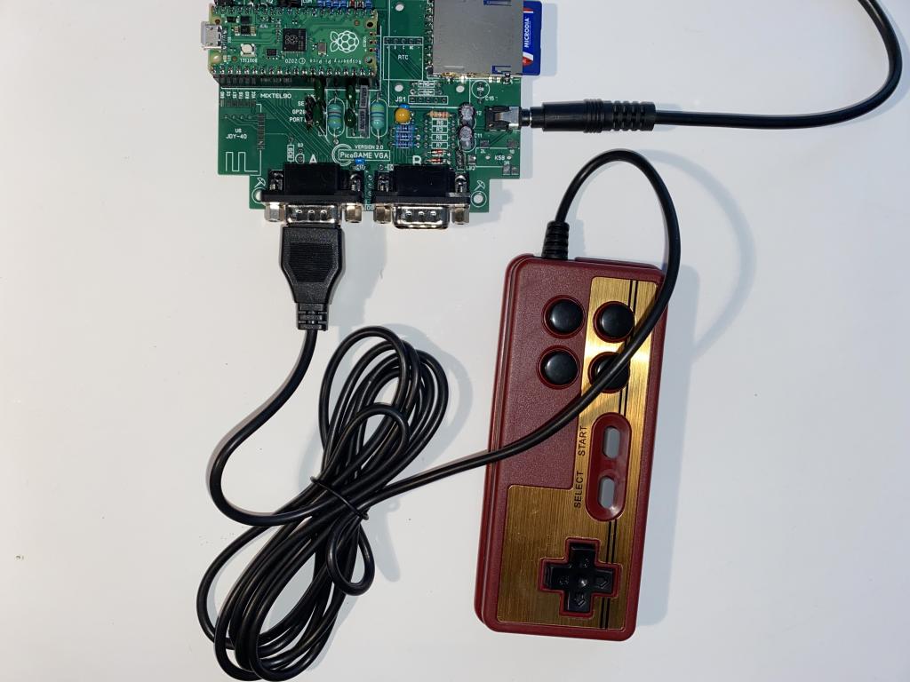

Thank you Volhout, Tom, Mick, Martin for your comments (above).
Hmmm. I'm not sure of which gamepad I have then. It's switched. See PHOTO below.
I bought it from Ebay Australia and it arrived in 3 days:
https://www.ebay.com.au/itm/355051578514
It works well with the PicoGAME board.
P.S. Many thanks to Mick Ames for the PicoGAME VGA design. I had fun making it.

That's the original Famicom controller design. It pre-dates the Super Nintendo NES IIRC.
I'm pretty sure it's the same internally.
Glad you like the board. :)
EDIT:
No, it's not the original Famicom. That doesn't have 4 buttons on the right. It looks more like a Famicom clone of some sort. There's a few pics almost half way down this page.

Thanks Mick for the info regarding the Famicon controllers.
Your Wikipedia link here with images:  https://en.wikipedia.org/wiki/Nintendo_Entertainment_System#Accessories
