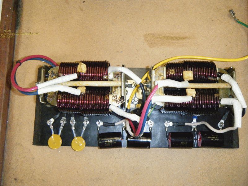

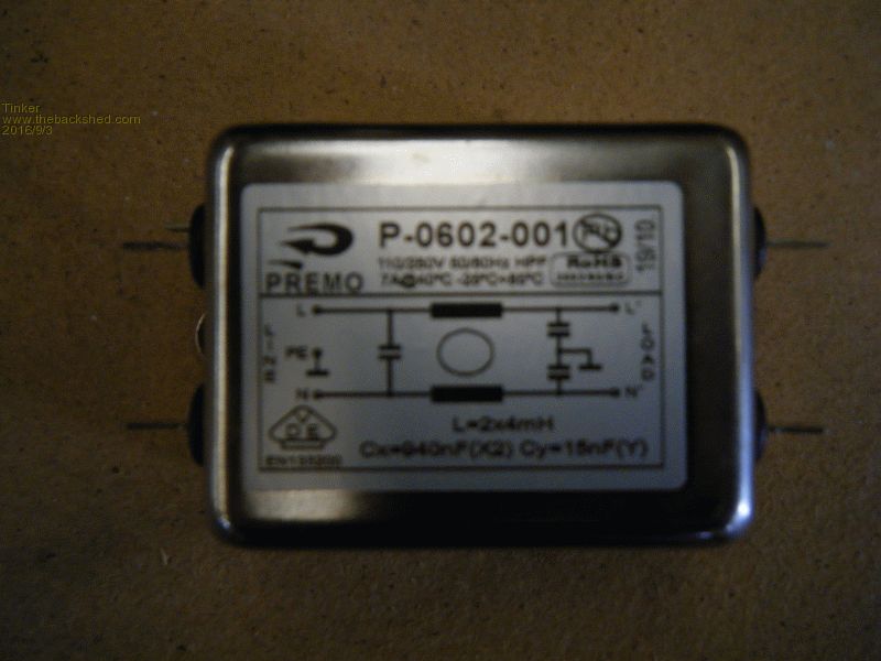

  Tinker said
I used the big chokes from 2 Aerosharp units to make a mains filter. I know there are those filters:
But they are only good for 7Amps so I would require 4 in parallel.
What I did is reproduce the filter circuit with other salvaged parts:
Since my double stack transformer was wound with 2 identical 230V secondaries I can connect one winding to each filter so the 2 chokes share the power between them.
The 230V are paralleled after that, at the input to the Voltage & Current sensing board.
I do not know yet how that filter will perform.
are you still using those filters ?
I was planing on doing the same thing and reusing the ones from my 3kw aerosharp's

  MasterCATZ said
tinker no longer posts here but I have it on good authority that these home made filters did not perform well and the fully sealed type with a 20Amp rating are used (they look the same as in the picture).
