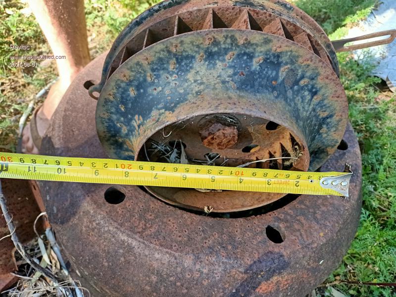

Another way to do it would be the cooling rotor from an old air cooled VW engine fitted to a 2800 rpm induction motor. I just found some info on that here:
http://offroadvw.net/tech/wes/fan.html
It says the inlet diameter is 150mm so going by the picture the outside diameter must be at least eight or nine inches, so the developed pressure should be fine.
According to the graph of measured airflow, at 2800 rpm flow should be around 500 CFM+ with the wider rotor.
This still involves building a housing, but the motor and rotor should cost just about nothing.

Posted: 02:47am 01 Aug 2021
VW Fan, just checked the one down the back, yes 150mm ID, 230mm OD and about 75mm deep.
Cheers Aaron
Off The Grid
Posted: 02:52am 01 Aug 2021
Perfect !!
Thanks Aaron.

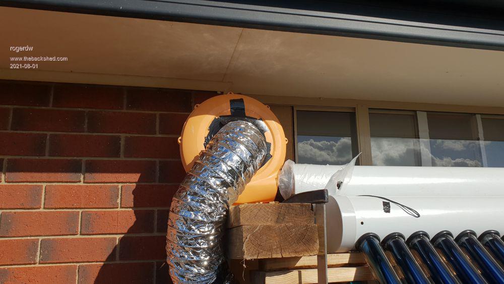

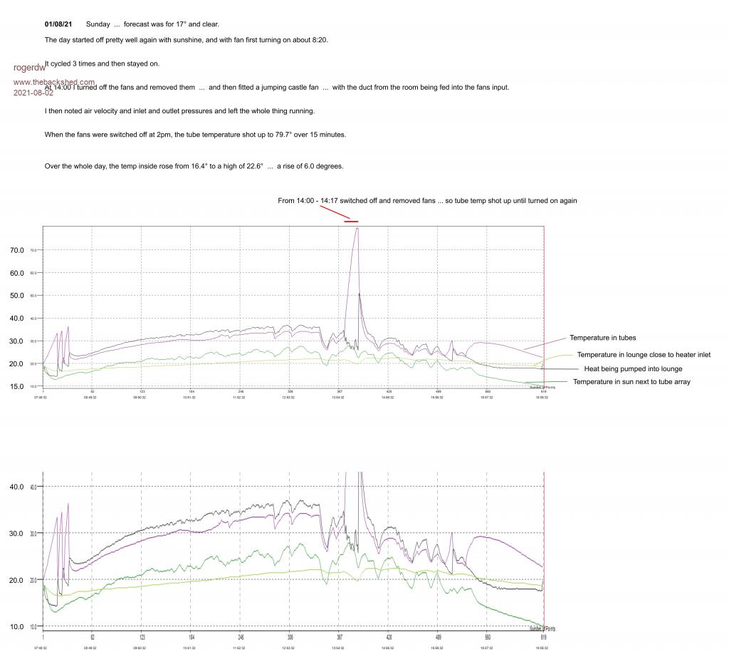

I do have some further news  ...  it's been a brilliant day for the machine today  ...  but at 2pm I switched it off, ripped out the inline fans and plugged a jumping castle fan directly into the end of the cold manifold.
Took just over 15 mins and was back on the air.

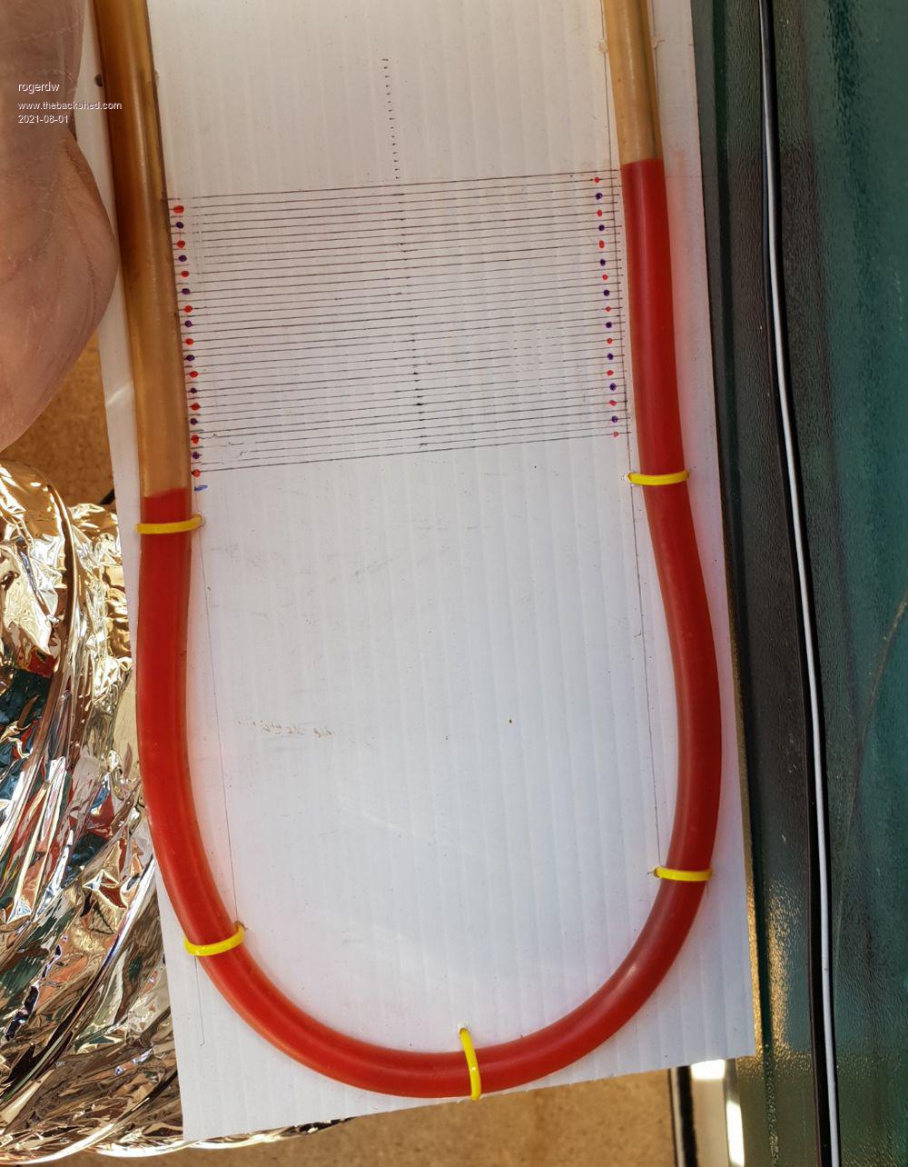

Anyway, I was able to take some readings, so hopefully they can give you guys more insight.
Removed all other fans and added jumping castle fan directly into cold duct  ...  plus fitted the duct from the room into the inlet of the fan
(Specs.  430-450 W  ...  ?? cubic mtr/hr)
Inlet Manifold = 2.1875"
Outlet Manifold = .6875"
Outlet Air Velocity = 28.34 ft/s
Power = 363 watts (when I blocked inlet, dropped to 205 watts)
I had to laugh when I took the inlet pressure  ...  just off the scale!!!
Cheers,  Roger
Posted: 06:40am 01 Aug 2021
Wow !
28.34 Ft/sec x 0.1726 = 4.89 cubic feet per second = 293 CFM.
A really big jump possibly more than needed, but we shall see what the tube temperatures look like in a nice clear blue sky.

Thanks, was pleased to see the result  ...  and Dave was right all along, it was definitely worth a try.
The fan is noisy, but being outside helps a lot  ...  it is the air rushing into the inlet duct in the lounge that makes the most noise from inside. But overall, much quieter than having the 8" fan running inside.
I also reduced Ld from 8 degrees down to 5, which is what Tony suggested right at the start.
As I've watched the system switch on and off, I've decided it is ok to have air pump in in the low 20's when the room temperature is only 16 or 17. We'll see how it goes.

Posted: 10:09pm 01 Aug 2021
Very nice Roger, the tubes are now running at less than ten degrees hotter than the house and you have pretty much reached the point of diminishing returns of heat recovery.
With more tubes and less flow restriction, that blower should do very well, even with extra added ducting length.
A six degree rise is excellent, and pretty amazing.
As the days get longer, things can only further improve.

Today's a bit of a write off. Sun started nicely this morning but just before lunch the cloud came over and the rain set in. It's freezing now  ...  well by SA standards anyway.
  Warpspeed said
If you decide to go with the dc motor, and I can see good reasons for doing that, a different control strategy then becomes possible.
We run the blower speed up to keep and hold a constant set temperature difference between the tubes and the house. In crappy cloudy weather the blower will run much more slowly, but more importantly it will not be cycling on and off, but running at some suitable speed and gracefully accelerating and decelerating.
That may be much less annoying than having vast blasts of air starting and stopping.
That was my intention at the beginning so I could do the soft start thing and not having it blasting away  ...  but I started to sway the other way once I got the differential controller and it was a matter of on or off.
But I do think that variable speed would make more sense in the long term for the times when it needs to ramp up a bit or throttle back  ...  and like you say, would be less annoying than vast blasts of air starting and stopping.
At the moment there are no complaints because we are in development mode  ...  but I don't think I could live with the noise of the thing at its loudest. Lucky my wife is very tolerant too.
The interesting thing with the style of fan I linked to on the previous page, is that they claim to be variable speed  ...  Control input: 0 to 10V DC/PWM  ...  which takes care of quite a bit  ...
...  though they are of course DC motors up around 36-57V  ...  so needs a healthy dc supply.
I will then need to have a more sophisticated control  ...  but that's not insurmountable.
Cheers,  Roger
