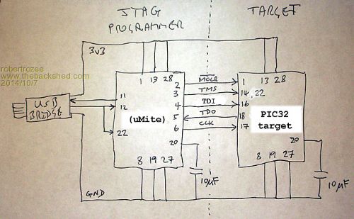

attached is some code that may (in theory) work.
2014-09-27_133809_adapter-bitbang.zip
this is set up to talk to the JTAG interface of the target pic32, and requires a micromite attached between serial port and target running the following short basic program to decode single-letter instructions from pic32prog, and to respond with the state of TDO where required:
SetPin 2, DOUT ' MCLR, connect to pin 1 on target
SetPin 3, DOUT ' TDI, connect to pin 16 on target
SetPin 4, DOUT ' TMS, connect to pin 14 and 22 on target
SetPin 5, DIN ' TDO, connect to pin 18 on target
SetPin 6, DOUT ' CLK, connect to pin 17 on target
SetPin 7, DOUT ' status LED (via 1k resistor to ground)
Pin(2) = 0
Pin(6) = 0
' the following code needs to be fast
start:
B = Asc(Inkey$)
If (B = 0) GoTo start
If (B > &h40) Then
Port(3,2) = (B And 3)
Pulse 6, 0.010
If (B < &h60) Then Print Chr$(&h30 + Pin(5));
GoTo start
EndIf
' the following code can be slow
If B=Asc("2") Then Pin(2)=0 ' set MCLR low (target in reset)
If B=Asc("3") Then Pin(2)=1 ' set MCLR high
If B=Asc("4") Then Pin(7)=0 ' turn off LED
If B=Asc("5") Then Pin(7)=1 ' turn on LED
GoTo start
the reason i've proceeded in this way is simply to get something working - initially i didn't realise that pic32prog didn't talk via a 2-wire PGC/PGD interface. this code here is very much a test to see what happens. it is quite possible that along the way i have got TDO and TMS swapped over, MCLR inverted, or other small errors. but it is a start. once i've got this part working, then the plan is to move back to a 2-wire interface using PDC/PGD and no MicroMite in between.
i would much appreciate any feedback. if requested i can post a compiled copy of pic32prog.exe but would much prefer if people could set themselves up to compile it themselves - allowing you to make alterations to the open source code.
pic32prog expects a parameter -dCOMn, where n is the number of the comm port. the code will only compile under windows right now. someone needs to suggest a widely used serial port library that allows reading and setting the comm port's status pins that is cross-platform.
rob :-)
(edited to fix bug in basic code)Edited by robert.rozee 2014-09-28

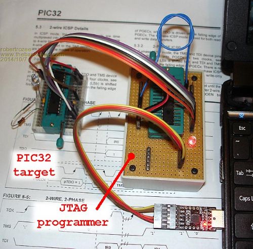

good morning, afternoon, or evening (as the case may be) to all.
attached is a zip archive containing a modified version of pic32prog that will operate with a micromite programmed as a 4-wire JTAG programmer. there are a couple of small issues still present, but these do not prevent the programming of an mx150 with the micromite (or any other) .hex file.
2014-10-07_043037_pic32prog_bitbang_JTAG_version_BETA_01.zip
the archive contains the following files:
* adapter-bitbang.c
source code for the 'bitbang' interface. this is the only code that has been altered from the r98 release of pic32prog on the code.google.com site. note that this version will, at this time, only compile for windows. someone might care to perform the translations to achieve dual windows and linux source compatibility

* MicroMite JTAG interface v4.bas
basic program to be loaded onto the micromite that will be doing the programming. this interprets single-letter commands as per the explanation in adapter-bitbang.c
* pic32prog.exe
compiled .exe of pic32prog including the adapter-bitbang.c extensions. note that all other functionality is still present and completely unaltered, for example programming using a pickit2/3
schematic for the programmer hardware. not much more that a couple of pic32's:
the time taken to program micromite basic into an mx150 is approximately 15 minutes, with the PE loaded in the first 20 seconds. note the RxD/TxD LEDs on your usb to serial bridge while programming the actual code - very little time is spent actually transferring data. usinga an arduino pro mini (around $3 on ebay) instead of a micromite would speed up the process considerably.
note that a status error is printed at the beginning of programming, and there is a checksum failure at the end. these can both be ignored for the moment. the verify of the last 4-bytes programmed fails because 'code protection' is not being correctly turned off - as indicated by the status error report at the start. this is a problem in the routine serial_execution() that remains to be fixed.
fyi, this is what my own setup looks like:
i would very much appreciate feedback before proceeding any further. plans are, if there is interest, to look at moving from using 4-wire JTAG to 2-wire ICSP, as well as using a non-programmed interface to the target.

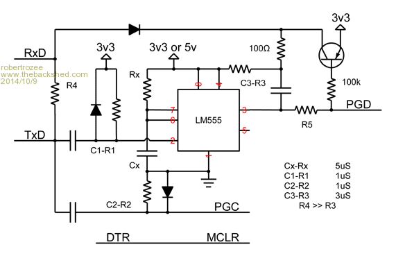

over the last few days i've been trying to rework my LM555 pic32 programmer circuit to allow reading back PGD via the serial port's RxD line. i believe i now have a solution that should work:
essentially, TxD is now looped back to RxD on the usb-to-serial bridge indirectly, via a resistor. this allows for the characters being echoed back to be modified on the fly. we take the falling edge of the monostable output, and turn it into s shortish negative going pulse (3uS). this, via a diode, inserts one or two zero bits in the middle of the bitstream. but, if PGD is being driven low by the target (after the 3rd clock pulse) then the PNP transistor will already be turned on, which suppresses this negative pulse.
so the programming procedure consists of sending TDI, TMS, chr$(255), 4th pulse. TDO will be encoded into the 3rd character returned in the sequence. if it is read back as chr$(255) then TDO = 0 (transistor turned on). if it is a lesser value then TDO = 1 (transistor turned off).
experiments with pic32prog and a micromite as JTAG programmer have shown that good throughput can be achieved via a serial port provided one works with (not against) the buffering within the operating system. the OS is happy to buffer up data coming back, so one can stream out data to be written to flash at high speed, then at leisure read out the response.
i believe programming in just a few minutes may be possible using a generic serial port bridge. feedback, please?
rob :-)Edited by robert.rozee 2014-10-10
