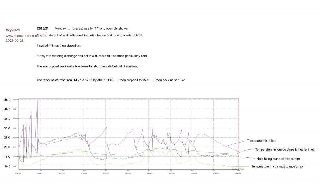

Todays results were mixed, with a great start but then a cold change came through late morning and cramped my style.
You can see the results on the chart of reducing Ld on the differential controller from 8 to 5 degrees  ...  the temperatures on the chart all appear much closer together.
The jumping castle fan is still being used.

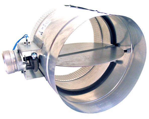

Thinking about it, those motorised dampers may have an application in not only directing the air from room to room, but limiting airflow to a particular room to raise the air temperature.
I have zero experience with adjustable air dampers, never even seen one,  and the motorised ones sound expensive ?

I used to simply put a restriction on the inlet, usually a bit of stiff cardboard or some Tin over the inlet but I thought using a PWM was more " Professional".
It's certainly easy to Dial up a number on the PWM to match to the Fuelling rate to get a set output but that said No reason a better restrictor plate could not be fashioned  and marked to do the same thing.  Couple of my blowers draw through the motor side and have a grille around it so I was reducing them just by laying some rag around them  which was a bit heath Robinson even for me.
Might go back to showing the restriction concept in my next Vid with a power meter attached to show people that they DO reduce output when the flow is reduced.
A throttle body comes to mind that could be regulated on the intake for the conventional Blowers that draw through the centre of the impeller. I'll have to look up how they are Controlled.  If there was an easy way to control their opening with a 0-5V signal or whatever they use, that would be good. Could use them intake or output.
Might be a bit small for Rogers application but then again, the wreckers probably don't even bother taking them off blown engines so should be cheap to get multiples thereof.
As far as I'm aware, the motorised AC dampers are pretty run of the Mill and not exy. Seen my mate Chuck out loads of the things.  Rogers mate should be able to hook him up with some.
From memory, The things can be set to part opening mechanically to effect air balancing in a system. Ironically, I have done that in my house just by cutting out some bits of cardboard and sitting them up above the Grilles. They can't be seen unless you look for them, ( be even harder to see if painted Black) but they do the job just fine.
Not really controllable on the fly though.  I usually have the spare room blocked off completely unless I am doing a shoot or someone is staying and then I just reach up, lift the grille and slide the cardboard out. Also tend to put some in Daughters room in summer to reduce the cold air flow so it maintains her preferred 30o c temp level.

This is all quite educational, I did not know such things even existed.
Its just a geared motor and a potentiometer, rather like a drive by wire automotive throttle. I can see that if such a thing were mass produced, it need not be all that horrifically expensive.

I didn't either until we moved here, our place has half a dozen and most have stopped working. We were quoted something like $240 each for new motor gearboxes for them  ...  and for once, I have not been able to fix them myself or find equivalent motors from China.
The motors have a built in gearbox with plastic gears and they have just been so hot that they go hard and brittle and fall apart or jam up. These also have a pair of limit switches so the motor stops and can reverse  ...  so while the tech is simple enough  ...  finding a replacement has been the issue.
Having said that  ...  I may simply be better off pulling out each complete damper assembly and fitting new ones with a different type of motor.

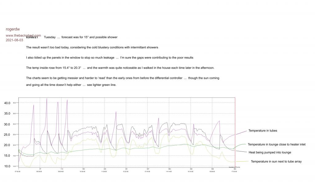

Here's todays results. Cold, blustery and intermittant showers  ...  but also intermittant sun.
Cheers,  Roger
Posted: 10:07pm 03 Aug 2021
There is more now happening, and the temperatures are closer together, so the charts will look a bit mote tangled than earlier.
But the overall slow steady heat gain in the house is definitely there.

  Warpspeed said  There is more now happening, and the temperatures are closer together, so the charts will look a bit mote tangled than earlier.
Yes  ...  really have to look closely to see what's happening  ...  but the end result with a higher inside temperature is good to see. Always looking for more and quicker, but that's human nature.
I was a bit slow getting going this morning and the fan started before I got out there, trying to suck the blind through the duct!!! Lucky I know now that it wasn't going to burn up my motor  ...  and in fact it was saving power.
It was a joy to see the dataloggers respond quickly to changes, but I think that even the bulk of the heatshrink and the tiny bit of silicone on the legs slows them down a little bit  ...  but they need some sort of physical protection or they'll be wrecked in a week  ...  especially seeing they have to be handled a lot for checking and downloading etc.

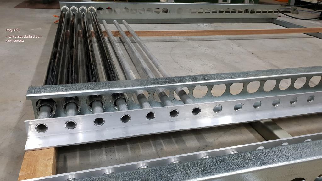

My 'how can I save effort/time' or I like to call it my 'lazy' gene was trying to kick in this morning when thinking about the aluminium tubes.
I was thinking that because the tubes are going to be horizontal and with no real force on them  ...  why can't I just assemble it on the roof and simply glue them in.
If I used high temperature silicone, something like Selleys RTV  ...  that should be enough to hold in place and provide an airtight seal  ...  and it should be able to cope with the extreme temperature too.
When I did my apprenticeship, and they still used to fix stuff like that  ...  we used RTV silicone to seal the soleplates on irons  ...  and it coped perfectly well with high temperatures, steam and pressure.
Anyway, it's just an attempt to get out of what I know I need to do and that is weld them all in. The only way I can see to do it is to clamp them all together vertically  ...  then set up a platform or something so I can reach to weld them around the top.
It's going to be difficult enough to do the job without trying to do vertical welds  ...  I need to get them so the weld action is horizontal.
Get onto your AC mate Roger. He should get them regularly from upgrades and probably just chucks them like my mate. Even new he should be able to buy the whole Duct for about $60 or so each wholesale.
All you do is untape them from the duct and put the new ones in. They are double layered, the inner duct that carrys the air, the insulation layer and then another duct to hold in the insulation that goes over the top.
3 turns of tape on each duct sleeve ( which your mate will have  boxes in stock of) re connect the wires and that's it. They may have to start in the open or closed position for the controller but other than that.... Done many of them myself and it's an unskilled labour Job.... which is why my mate takes me along to help.... :0)
Whoever quoted $240 ea was having a big lend of you unless that was supply and fit but even then....
That was how I imagined you'd be doing it all along.
I thought you would do the frames, get that up on the roof then put the tubes in on the roof and couple it all up.
Alternately, How were you going to get the assembly up on the roof?
Can you get the tractor to the back of the house and lift it with that?  If the bucket won't go high enough, You could easily make up a Jib crane for the 3 Point  hitch.
I just put mine between the Top link on the tractor and the top link on a receiver hitch Frame I have so the thing is an offset Lever.  Goes from horizontal to nearly vertical and with a bit over 3 M length, has some good lift  height.  Can make it even longer by just extending the  boom. I just bought some of those weld on ball ends and put along where the Implement would  pin and the other on the end to pivot on the tractor where the adjustable link normally goes. I used the adjustable link to measure out where the one along the jib goes. Spose if you brought it in closer the thing could get a bit more lift but mine is near vertical now and I don't want anything hanging over the top of me. I also thought to make up a  bit of a dog leg so I can get more height and push the load back a bit but that's going to start taxing my little toy tractor over anything beyond about Hundred KG but might be good for lifting panels on the roof.
I don't imagine this is too heavy so should be easy enough for your  tractor to lift.
Before I had the little Kubota I used an engine crane with an extended Boom. You have to counter weight a setup like that though so I just ratchet strapped a 44 on the back and filled it with water so that was good for as much as the thing would lift on the ram anyway.
You'll need a smooth surface to roll it on though like plywood or something if you have to get back onto grass or pavers.
Yes, that is what I plan to do. Drag up the basic frame first, then each set of 30 tubes, then the ducting sections and covers, and last the glass tubes.
My comments related to using Selleys RTV Silicone to glue the tubes into the centre duct  ...  rather than weld them in before I lift them on the roof. It was a dumb idea really, just being lazy.
Maybe if I blow too many holes in the tubing as I weld them in, I can use the silicone to fill the gaps.
  Quote  Alternately, How were you going to get the assembly up on the roof?
The heaviest part will be the main frame, but if I was desperate, I reckon I could get it up there by myself  ...   but to save the paint on the gutters and risk to tiles and stuff, I'd be able to do it with an extra person easily enough.
The rest I'm sure I could also get up there safely enough on my own if need be.
I had thought about a front end loader, but mine is really old and doesn't have one. It does have a jib for the 3 point linkage, but it still wouldn't be high enough.
  Quote  Before I had the little Kubota I used an engine crane with an extended Boom. You have to counter weight a setup like that though so I just ratchet strapped a 44 on the back and filled it with water so that was good for as much as the thing would lift on the ram anyway.
It's amazing what you can achieve with a bit of thought and planning  ...  though I can see why you might upset the safety sissies.
