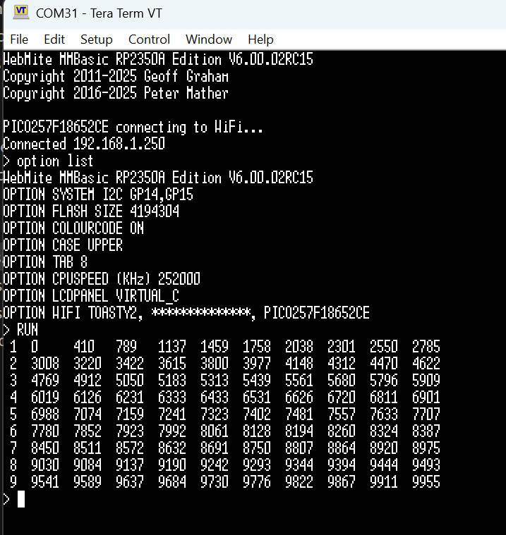

This was a problem in WebMiteRP2350V6.00.02RC14 and is still a problem in RC15. When I run the logtable below, the processor reboots at about 9955.
110 LET W=0
120 FOR X=1 TO 9
130 PRINT X;
140 FOR Y=0 TO 9
150 LET Z=(10*X+Y)*.1
160 IF ABS(10^W-Z)>.001 THEN 210
170 LET T=INT(10000*W)
190 PRINT TAB(6*Y+4);T;
200 GOTO 230
210 LET W=W+.0001
220 GOTO 160
230 NEXT Y
240 PRINT
250 NEXT X
260 END
Here's my OPTION LIST:
WebMite MMBasic RP2350A Edition V6.00.02RC15
OPTION FLASH SIZE 4194304
OPTION LIBRARY_FLASH_SIZE  34000
OPTION COLOURCODE ON
OPTION CASE UPPER
OPTION TAB 8
OPTION KEYBOARD US
OPTION CPUSPEED (KHz) 252000
OPTION LCDPANEL VIRTUAL_C
OPTION WIFI MySpectrumWiFie0-2G, **************, PICORP2350
Edited 2025-04-16 03:59 by toml_12953

Posts: 12249
Posted: 06:12pm 15 Apr 2025
  Quote  Another problem I'm having is that, when I left-click my mouse, I get this:
Those are the escape sequences the mouse is generating. Did you reboot while in the editor? Enter the editor and then exit cleanly and it should then be OK
  Quote  When I run the logtable below, the processor reboots at about 9955.
Put some diagnostics in and work out which command is causing the problem and what the variables are at the time - then report. Sounds like a overflow or divide by zero or similar that isn't being trapped
Can't replicate
Edited 2025-04-16 04:26 by matherp
toml_12953
Joined: 13/02/2015
Posts: 746
Posted: 06:39pm 15 Apr 2025
I'm using a Dell wireless mouse connected to my Core i9 ASUS motherboard. The PicoMite 2W is connected via a USB 3.0 port.
When I turn TRACE ON, before the processor resets, I get the message:
Error: Invalid address - resetting
If I change line 170 to
T=INT(99*W)
the program completes. If I change it to INT(100*W), the crash occurs.
W=0.9956, x=9, y=9, z=9.9, t=99
In the statement
170 T=INT(nn*W)
Any number, nn, over 99 makes the crash occur.
Original program:
110 LET W=0
120 FOR X=1 TO 9
130 PRINT X;
140 FOR Y=0 TO 9
200 GOTO 230
210 LET W=W+.0001
220 GOTO 160
230 NEXT Y
240 PRINT
250 NEXT X
260 END

toml_12953
Joined: 13/02/2015
Posts: 746
Posted: 07:05pm 15 Apr 2025
  matherp said  V6.00.02RC15 is available on
Thanks to bleep finding a very strange performance issue in his bubble universe code I've been able to track down an underlying day-1 inefficiency in the MMbasic memory handling. This release optimises around that and should give a performance improvement for most applications. The code change is very small and doesn't affect any functionality. I believe it to be robust but if you see anything strange please report your findings.
NB: there are known issues in 800x600 and 848x480 resolutions in RP2350 VGA and HDMI versions. I'm looking at this.
UPDATE Fixed at 18:05 UTC
Reboot problem discovered!
The problem was that I had
OPTION ESCAPE
SUB MM.END
 PRINT "\n\nEND PROGRAM\n"
END SUB
in the library. I don't know why that should cause a program crash but when I removed it from the library, the logtable program stopped crashing.
When I put that in the program itself, it crashed again.
Even a null sub with no print statement in it
SUB MM.END
END SUB
will make the program crash.
Edited 2025-04-16 05:12 by toml_12953

Posts: 12249
Posted: 08:46am 16 Apr 2025
  Quote  This was a problem in WebMiteRP2350V6.00.02RC14 and is still a problem in RC15. When I run the logtable below, the processor reboots at about 9955.
This was a bug that I've now fixed and will be in the next version. I asked Cortana to rewrite your code in "modern" Basic and this is the result
