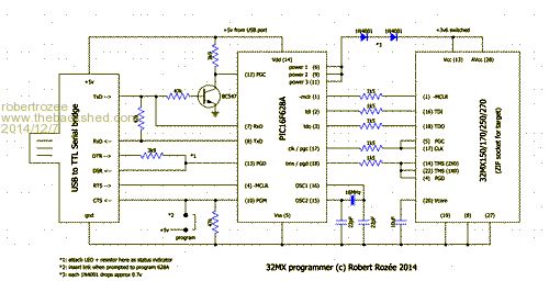

Posts: 2556
Posted: 04:15am 28 Oct 2014
am in need of a second opinion or two, regarding using ICSP just to erase the flash in an MX150.
one of the final hurdles to getting pic32prog usable through the bitbang interface is that released versions of the mmbasic .HEX file have the JTAG ENABLE bit cleared. this poses a slight problem - ic32prog's bitbang unit was originally written with JTAG in mind, but we have no JTAG access.
the solution i've been working on is to simply place code in the JTAG head unit (currently a micromite) to perform an ICSP flash erase. in theory, quite a simple process which doesn't even really need the micromite to read anything back from the target.
following the microchip datasheets didn't work, so i generating a trace from pic32prog, see below:

the letters d, e, f, g in the above trace encode TDI and TMS, with TMS = bit 0, and TDI = bit 1. the sequences match up to the constant labels in the source.
i've recreated what should be the essential sequences in the following micromite code (partial listing), but it still fails to achieve the desired outcome:

Posts: 2556
Posted: 06:09pm 06 Dec 2014
for the few hundred folks who have been following this thread, the discussion is continuing in the below thread:
Topic: simplest PIC16 ICSP
with pic32prog (a modified version thereof) now able to talk using an "ascii JTAG" command set, the new thread is centred around getting code into a standalone programmer based around an NPN transistor and a blank PIC16F628A. a schematic exists that looks like it should work - the new challenge is to create a 'firmware uploader' for the PIC16F, then write an 'ascii JTAG' firmware for it.
rob :-)
