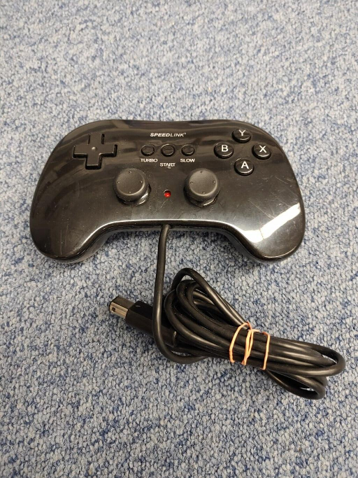

Any reason not to look at the Wii classic. Easy to interface (only two pins) with and if appropriate I could copy the CMM2 drivers into the PicoMite. Then any cards would just need a Wii edge connector like the CMM2

  matherp said  Any reason not to look at the Wii classic. Easy to interface (only two pins) with and if appropriate I could copy the CMM2 drivers into the PicoMite. Then any cards would just need a Wii edge connector like the CMM2
The only reason is, I don't have one here, so I can't build that in. (still waiting for my SNES Controller and, I think i have to Order another one with original plugg)
Just googled, you talk about something like this?
That would have even more controllers and buttons than we need for the game.
It would certainly be a nice addition, but you don't know how many people actually use it or are willing to use it on the Pico.
But if we can include the option in the selection of controllers, it makes the whole thing more flexible.
