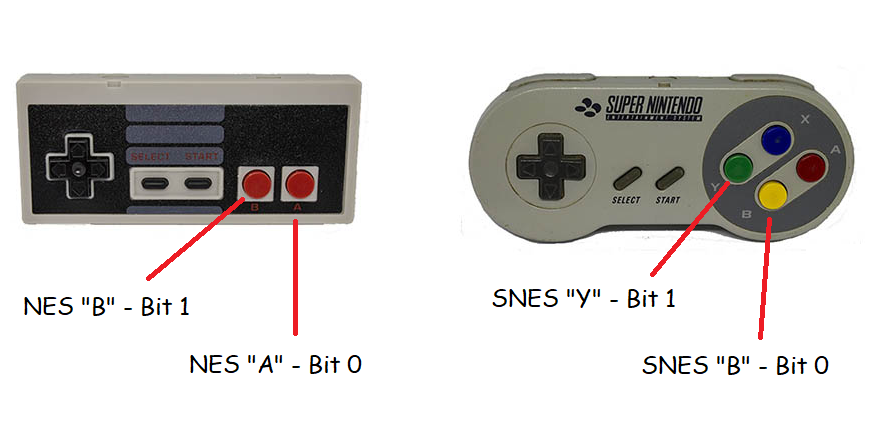

Does any of this explain why for the standard NES behaviour on those controllers it is necessary to pulse the clock after reading bit 7 and before pulsing the latch ?
  Volhout said  According [to] Tom's documentation there is another mismatch between the NES and SNES data. The A, B and Y button do not show up on the same bits.
That's not as nuts/inconvenient as it might seem:
Note that Y & B on the NES are positioned similarly to B & A on the NES controller. As a right-hander NES/A and SNES/B are comfortably the primary fire buttons and NES/B and SNES/Y the secondary fire buttons - I suspect the fact that they set (actually clear) the same bit is a piece of considered design by Nintendo.
  Volhout said  But looking at the MMbasic equivalent Tom made (simple and easy to understand), using the (for most people abracadabra) PIO may not be the best solution for game development.
That's my feeling too, especially since with every controller I've tested you only need a 1 microsecond latch/clock pulse rather than the 12 microseconds that the real NES hardware apparently used. Nevertheless thank you for your efforts @Volhout, hopefully the controllers I sent are some recompense.
  Mixtel90 said  That's very interesting! Thanks. I wonder if the change to the shift register input (and probably the swapped buttons) was a mistake in copying an original controller or a deliberate ploy by Nintendo to prevent the use of a "wrong" (i.e. cheaper or cloned) controller? Not something we're likely to ever find out.
As above I think it was a well considered decision and not even a nuisance for us except with regards play documentation. It's interesting that Nintendo didn't try and lock out 3rd party controllers (they went to considerable effort with regards 3rd party cartridges). Note also that the real NES and SNES have 7-pin connectors (different from each other) and not the DE-9/DB-9 the clones and the PicoGAME use.

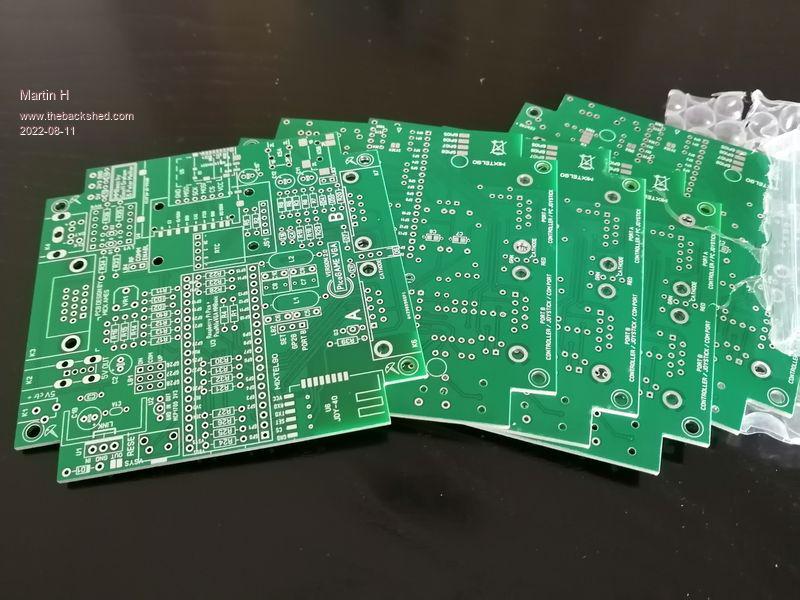

today it arrived from PCBWay
so, you got me
Total products amount (USD) $5.00
Total Freight cost (USD) $11.44
Bank fee (USD)     $1.19
VAT fee (USD) $3.35
Total (USD) $20.98
EUR 20.37
todo:
Resize the template for my 3D-printed "SNES Style" Case to fit the PCB in
Edited 2022-08-11 20:14 by Martin H.

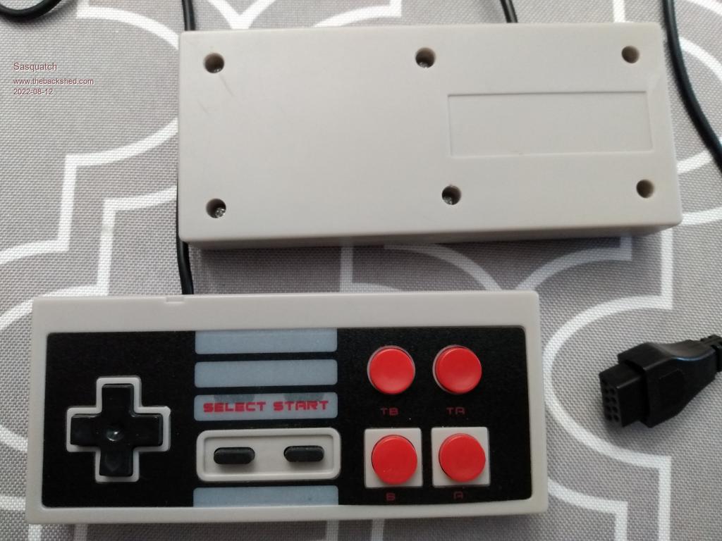

Unicorns do exist!
I bought a NES Clone 500 in 1 game at a Thrift Shop (Charity Shop, Opportunity Shop) for $12.99 USD.  It came with two NES style controllers.  These controllers have 9pin D plugs, do not exhibit the Right=129 issue, and the Dpads aren't wonky!
Unfortunately there are no identifying markings on either the controllers or the game console. Not even a date or "Made in Taiwan".  The epoxy-blob PCB inside the controllers is labeled with "8bit-2"
There are several characteristics that might help identify similar controllers:
1.  The "center" 2 screws on the back are slightly offset.
2.  There is a "notch" on the front bezel corresponding to the position of the connecting cable.
3.  There are translucent areas just above the select and start labels, as though made for LEDs to shine through, but there are no LEDs inside.
4.  The 2 rows of fire buttons are spaced farther apart and only the lower A and B buttons are outlined in gray plastic squares.
5.  The select and start buttons are thin and black not gray.
Unfortunately, a quick scan of AliExpress did not find an exact match.  These controllers on AliExpress seem like the closest match I could find thus far:
https://www.aliexpress.com/item/3256802078199613.html
Please note that I have not purchased or tested the controllers from the above link.  They are NOT an exact cosmetic match to the ones I have tested, they are just the closest match I was able to find quickly on AliExpress!
I did order two of these:
https://www.aliexpress.com/item/3256802759223064.html
And two of these:
https://www.aliexpress.com/item/2251832801091116.html
I really like the shape and feel of the SNES controllers and I figure it should be easy enough to swap the cables.  I'll let you know how it goes when they arrive in the next few days.
Edited 2022-08-12 10:16 by Sasquatch

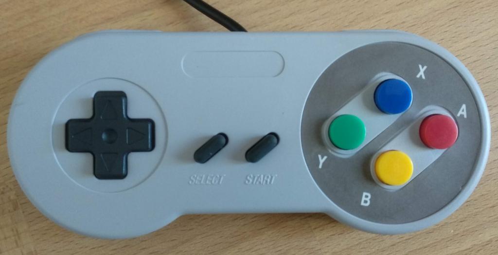

@Sasquatch my "SNES gamepads" which I believe were ordered from the same listing as yours have arrived, and do not match the picture on the listing ROFLOL.
Whether it actually works will have to wait a few days until I find time to rewire it with a DB-9 instead of the bespoke 7 pin linear connector.

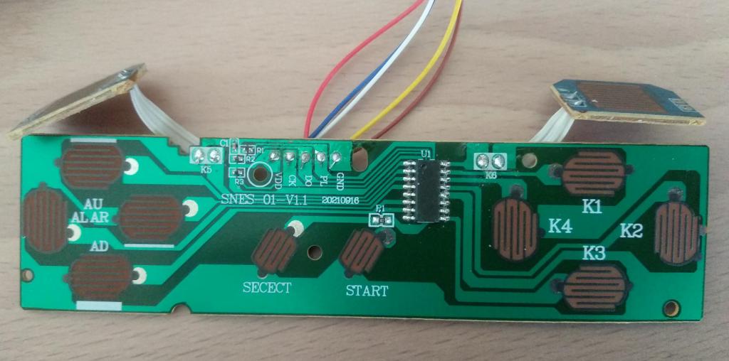

In the meantime I've opened one up and it is interesting inside, there is a discrete 16-pin SMD IC (unmarked) rather than an epoxy blob, and that's not enough pins for a 16-bit shift register, though each button (except SELECT) is attached to its own pin so it isn't an NES gamepad in disguise either. There also aren't the 12 pull-up resistors you would expect.
I guess it must be a micro-controller, but it seems to have VDD on pin 5 and GND on pin 12, that's unconventional isn't it ? Also if it is a micro-controller then is it probably a 5V one and thus unlikely to run off the PicoGAME's 3.3V controller supply line ?
16 pins isn't generally enough as you've got 12 controller buttons + LATCH, CLOCK, DATA, VCD and GND = 17, to overcome this SELECT appears to be connected to the same pin as the DATA line but via a 1K resistor ?
Pin  Function
1    Left Bumper
2    Up
3    Right
4    Left
5    VDD
6    Down
7    Start
8    Clock
9    K3
10   Select/Data
11   Latch
12   Ground
13   K2
14   K4
15   K1
16   Right Bumper
Edited 2022-08-12 22:37 by thwill
Posts: 6254
Posted: 01:44pm 12 Aug 2022

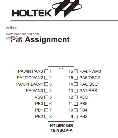

It is a MCU, most likely a Holtek one. In the early days of the Microchip PIC microcontrollers Holtek made similar devices (copied ?) that where quite a bit cheaper (at that time $0.22 for a MCU, where a similar Microchip PIC16F84 was 2 dollar). And they had (at that time) faster chips. So a real thread for Microchip.
This particular chip could be have been used (1k OTP memory, 8 bit core).
Posts: 4410
Posted: 02:02pm 12 Aug 2022
  Volhout said  It is a MCU, most likely a Holtek one ...
Thanks @Volhout, though it looks like VDD and GND are the wrong way around for it to be that MCU unless I managed to massively confuse myself ... or the silkscreen on the board had them reversed ... that might make rewiring the connector fun.

Hi @thwill,
My AliExpress SNES controllers arrived today.  I decided to do some testing before I swapped the cables.  I can confirm that the ones I received have the same PCB and unmarked SMT chip as yours, and they don't match the previous 2 that I ordered about a year ago.  Sigh....
First, I like the positive feel of the buttons and particularly the front bumper switches have a nice firm feel.
Second, these things are S..L..O..W at least at 3.3V they are.  I had to increase all the pulse duration and loop delays to get consistent results.  This kinda makes sense if they are using a small 8 bit micro-controller as opposed to a shift register.  It may actually work faster at 5V as it was probably designed for.
Third, the "Select" button reports all zeros.(inverted to ones in software)  It's pulling down the data output too low.  I see there is a pull-up resistor on the Data Out and a resistor in series with the select button.  This was also likely designed to work at 5V.  Otherwise, the controllers seem to report all 12 bits correctly.
I'd like to do some testing on these with a 5V power supply and check the timing with a O'Scope, but I would need to use a different test platform as the Pico pins aren't 5V tolerant.
In summary, for use with the PicoGameVGA, I'm afraid these things are a BUST!

Would it be worth putting a level shifter in them (or in line to the plug)?
If these controllers don't use pin 6 on the PicoGame then the two resistors and transistor that connect to that pin could be removed and a wire run from pin 6 to 5V to power it.
If you need to retain compatibility with controllers that do use pin 6 external supply may be needed.
Plan "B" for 5V, a boost converter. The very simple sort used in solar garden lights might work. Dirt cheap.
Or the chips used to get 5V from a lithium cell would definitely work.

  Sasquatch said  Hi @thwill,
Thanks for reminding me Sasquatch..
The NES controlllers I received from Tom work correctly with a pulse duration of 1us (0.001) up to 1ms (1). Outside this window they start to make errors of respond with 0xFF (255). And they work fine with PIONES(8/16/32). So they are  usable for the VGApicoGAME platform (1.4).
Edited 2022-08-13 15:33 by Volhout
Posts: 9329
Posted: 07:21am 13 Aug 2022
Phil: You can set GP14 (or GP15) high to allow the controller to draw more current. That might help. It's still 3V3 though.
We have to be careful as any on-board level shifting would have to be on all the pins, including GP28 as this is used as a digital pin, unfortunately it is also used as an ADC pin. An external adapter might be simpler to implement but getting 5V out of the DB9 is fraught with difficulties!
