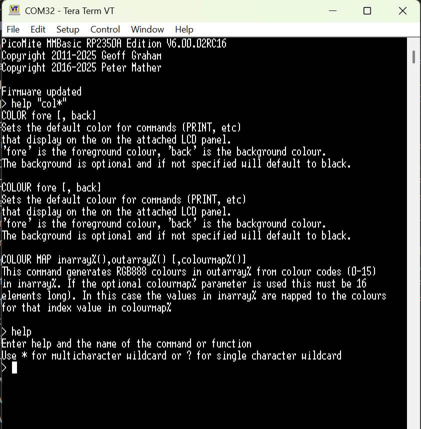

I've change the filespec slightly. Filename is "help.txt" - lowercase. Everything should be on different lines. Below is my test file and the result.
  Quote  ~COLOR
COLOR fore [, back]
Sets the default color for commands (PRINT, etc)
that display on the on the attached LCD panel.
'fore' is the foreground colour, 'back' is the background colour.
The background is optional and if not specified will default to black.
~COLOUR
COLOUR fore [, back]
Sets the default colour for commands (PRINT, etc)
~COLOUR MAP
COLOUR MAP inarray%(),outarray%() [,colourmap%()]
This command generates RGB888 colours in outarray% from colour codes (0-15)
in inarray%. If the optional colourmap% parameter is used this must be 16
elements long). In this case the values in inarray% are mapped to the colours
for that index value in colourmap%
~DO
DO <statements> LOOP
Loops while Loops while 'expression' is true (this is equivalent to the older
WHILE-WEND loop).If, at the start, the expression is false the statements in the
loop will not be executed, not even once.
~DO WHILE
DO WHILE expression <statements> LOOP
Loops until the expression following UNTIL is true. Because the test is made
at the end of the loop the statements inside the loop will be executed at least

Posted: 03:23pm 18 Apr 2025
V6.00.02RC16 is available on
Fixes bug in GUI GAUGE
Fixes bug in SETPIN n,ARAW
Removes OPTION FAST TRIG ON/OFF as there is a bug in the Pico implementation of the C functions cosf and sinf so this is not reliable
Implements HELP [search_pattern$] command. See above.
HELP without a parameter just outputs the text:
"Enter help and the name of the command or function
Use * for multicharacter wildcard or ? for single character wildcard"
This looks for a file on the A: drive named "help.txt"
This must be formatted as follows:
~searchable_string
text line - recommend this is the command syntax e.g. COLOUR fore [, back]
text line
text line
~next_searchable_string
text line
etc.
There can be one or many text lines for each searchable_string. It is highly recommended that text lines do not exceed 80 characters in length
in the "search_pattern" use * for multicharacter wildcard or ? for single character wildcard
The command will output all sections (between the matching searchable string and the next searchable string) where the search_pattern matches the searchable_string
Edited 2025-04-19 01:23 by matherp

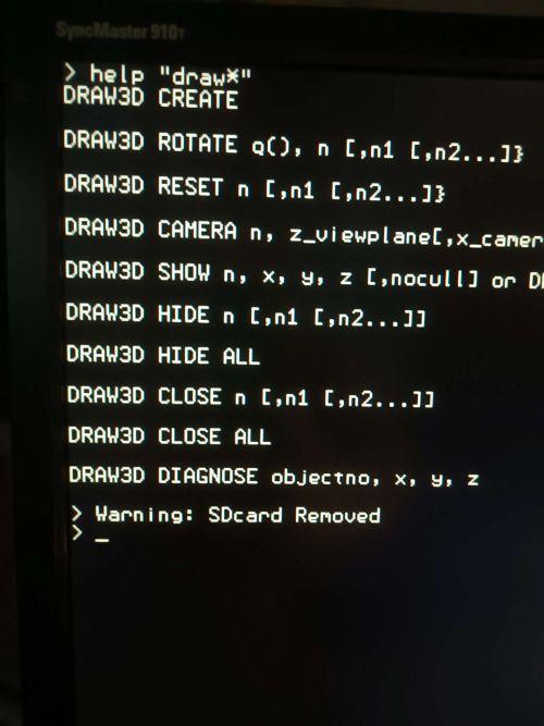

Posted: 05:42pm 18 Apr 2025
Draft help.txt 'build' here
help.txt.zip
Edited 2025-04-19 03:47 by electricat
