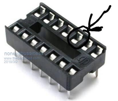

Hi John, are you using the 16 pin sockets?? I had a project that would work intermittently. . Turned out to be one of these pins had broke but remained in the socket. It was not obvious, and only after replacing the did i find out.
It really sounds like something is intermittently mis firing and with a toroidal core that is usually fatal to the mosfets..

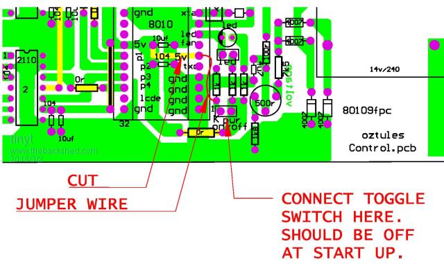

I remember oztules saying something about pin 6 for startup. I checked the control PCB gerbers and it looks like it is hard wired to +5V. I don't know if this is the PCB you are using.
I would try cutting the copper trace and then jumpering pin 6 to the resistor as shown. You would need a toggle switch connected as shown.
It should be OFF at startup. Then after a few seconds turned ON. This ensures that there are no pwm signals from the 8010 at startup. Then when turned on, it will do the soft start.

Pin 6 needs to be switched between ground via 1k and 5V with a SPDT switch.
tinyt
Joined: 12/11/2017
Posts: 564
Posted: 02:18pm 02 Mar 2018
As Madness says, you have to use only two terminals of the toggle switch and make use of the 1K pull down resistor.
If you use all 3 terminals of an SPDT, with the center terminal connected to Pin 6 and one outer to +5V and the other one direct to ground, Pin 6 will float during toggle contact transfers and might create problems.

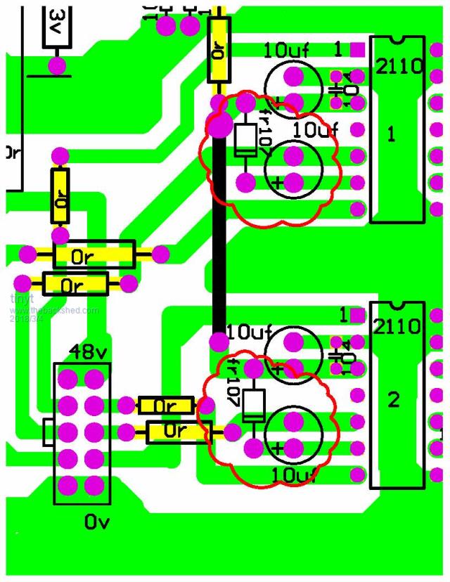

This is just a wild guess.
Check the diodes and capacitors red lined in the picture.
Check for solder connection, proper polarity, values, etc. If polarities are correct and the diodes are good, I am guessing the capacitor(s) have changed.

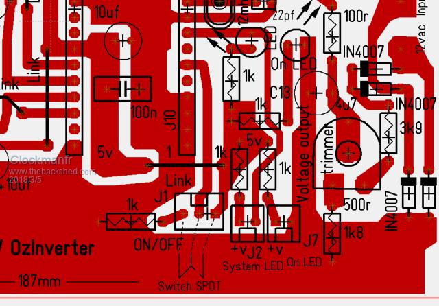

On Off switch....
This is the latest OzControl No12 board.
I think its self explanatory.

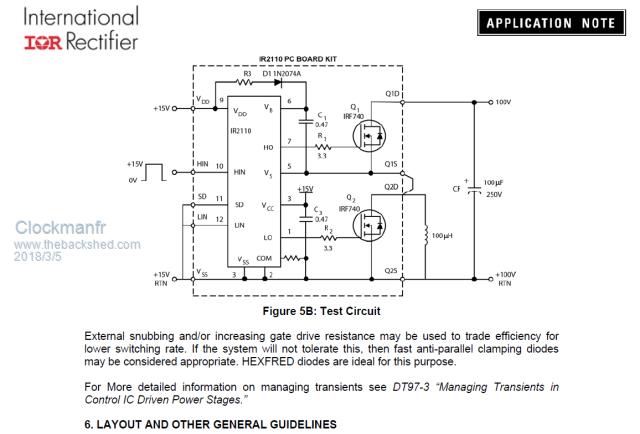

Regards the driver chips IR2110, ... It seems there is a lot of junk out there.
I recently saw an advert where you could choose the specs/quality grade depending on price. whatttttt !!!!!!!!
My originals were International Rectifier branded with a 2.5amp handling capability, but does not like going below 10v.
So I think its a good idea to pay a little extra for genuine branded IR2110 drivers.
Heres a test circuit..... for the hardy folk?
Edited by Clockmanfr 2018-03-06

Posted: 09:00am 05 Mar 2018
Notice that in the test circuit Clockman posted above, the chips run on 15V.
We run ours on 12V! Worth experimenting with?
Madness
Joined: 08/10/2011
Posts: 2498
Posted: 09:12am 05 Mar 2018
Oztules and myself are using 18V.
Posted: 11:52am 05 Mar 2018
  Madness said   Oztules and myself are using 18V.
Oh, I was not aware of that. Mine run fine on 12V, chosen because the fans are also of the same 12V DC/DC converter.
Did oztules change up from 12V or always used 18V? I'm sure in the past he used a similar DC/DC converter than I am using.
