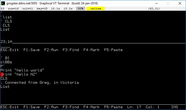

here is an example of what i'm seeing. i just typed EDIT with what is currently saved on the mite, then scrolled up and down until something interesting happened:

I just tried via the ddns path, and that works fine in the editor too. I thought perhaps it was the ddns path that was screwing with the escape sequences or something, but both the LAN and WAN connection paths work fine for me.
EDIT: Ahhhhhhh! I see the problem now. I was using PAGE UP and PAGE DOWN - no problems there. If I use the arrow keys, I am seeing odd things too. That was via ddns path. I will now try LAN path, but expect it is the same......yes, it is.Edited by Grogster 2018-03-01

It might be caused by timings in the sending and receiving programms. What probably happens is that data is send in very small packets. If the data is not 100% correctly 'reassembled' at the receiving end it could be that partial data is processed and if that is some VT100 command that gets screwed up then the display will also.
TCP/IP on the lower level guarantees that data is given to the higher level in the correct order, it does not guarantee that the amount in each packet is the same.
In other words a packet of 4 bytes and a packet of 5 bytes is being send can result in a packet with one byte followed by a packet with two bytes and a packet with 6 bytes.
If the receiving end in this case processed the one byte first and does not account for more data coming in then you get corruption.
If you want to be absolute sure then use a program like wireshark to monitor exactly what is being send/received.
