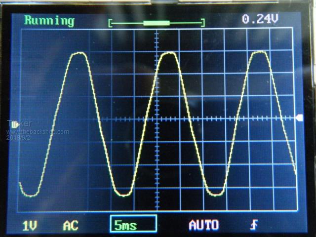

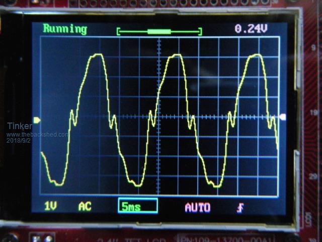

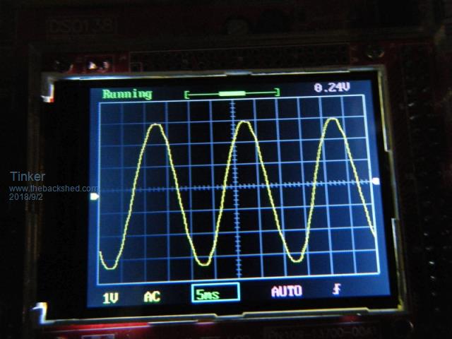

Posted: 10:11am 02 Sep 2018
Mad, my screen name is tinker - I like tinkering and no, it does not keep me awake at night.
Part of learning is to know why things happen as they do with these inverters.
Now, as to sine wave distortions, here are three I photographed today:
First one is running a 2KW shredder motor (idling).
Next one is running my cheap 700W microwave.
Last one is of my induction stove, set to 1KW.
So you see its not just any inductance....
BTW, all appliances ran fine.
It will be a while until I can tackle that odd blackout symptom, something else keeping me bust ATM.

I wonder if it would look like that on a proper cro? My little one showed funny things the big one doesn't.
Cheers Caveman Mark
Off grid eastern Melb
Posted: 12:51am 03 Sep 2018
Remember the little CRO only has eight bits of vertical resolution, which is what puts all those jagged little steps on the waveform. They are not really there.
But the larger bends and kinks will be there, but even the grid can look pretty horrible at times and everything still works fine.

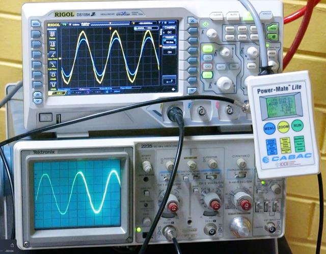

MY experience with ferrite alone can be seen below.
Yellow is AC current.
Blue is AC voltage.
This time, my Tektronix 2235 makes an appearance, just to show that the Rigol DSO does not lie. The 2235 is showing AC voltage.
This is running a load over 2kW.
Here is a video, where you can observe the not-too-bad-to-my-eyes sine wave as I switch
in 800W, 1600W and then to full 2kW+ of the heater, then switch back to 1600W, the 800W then "idle" which is also running the household loads of approx 300W.
You can hear my switching of the radiator in the background.
If you view it at 720p full screen you can observe the Powermate's readouts of power, power factor etc as I switch in and out more and less load.
The inverter is a straight forward 12 HY4008 aliexpress board with EG8010 controller, with a 3kW toroid, and a ferrite choke of about 50uH. The same board and toroid combo that failed within hours running one of the aerosharp chokes.
In my view, ferrite works fine and does the required job.
I have posted already a comparison of ferrite v iron cored chokes for anyone interested in the detail behind my opinion on this matter.
