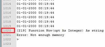

CaptainBoing
Joined: 07/09/2016
Posts: 2171
Posted: 02:55pm 25 Sep 2018
Hi Peter.
same error at the same spot - sorry.
always on the 1020th attempt if that helps, odd because it isn't doing anything spectacular.
The below is simply a tight loop to print the Now() return value, no delay
01-01-2000 00:19:44
01-01-2000 00:19:44
01-01-2000 00:19:44
01-01-2000 00:19:44
[219] Function Now(opt As Integer) As string
Error: Not enough memory
I have pared the code right back to just the following:
do
Print now()
loop
If opt=0 Then
Now=Date$+" "+Time$
Else
Now=Right$(Date$,4)+Mid$(Date$,3,4)+Left$(Date$,2)+" "+Time$
EndIf
End Function
