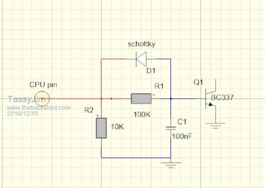

I know little about Arduinos either but I agree with Bill, decent capacitor on the power supply as well as a 0.1uF for HF suppression.
To negate the short pulses I would use something like this:
Having a capacitor directly connected to the CPU pin only overloads the CPU and wouldn't do much for spike reduction. It would draw a lot of power unnecessarily.
R1 C1 do the filtering. I haven't looked at the timing of your spikes but I would uses 100k and 0.1uF as starting points.
R2 is there if the CPU pin goes high Z when in sleep mode.
The diode discharges the capacitor quickly when the CPU pin goes low. Schottky is needed to get the voltage below the transistor torn on level.
You may not need any diode.
This should stop the short spikes turning the transistor on but I would not be comfortable putting the system into service until I know the cause of the spikes.

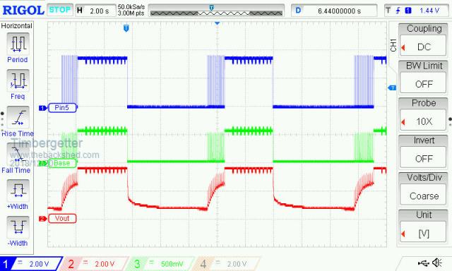

Moving the 47 µF cap from the HC-12 supply to the supply feed to the MosFet did reduce the number of pulses from 10 to between 2 and 3 but did not eliminate the pulses nor reduce their amplitude.
Traces-04a
This trace shows two and bit cycles of the device waking, sending readings then going into sleep mode. I think you can see that the commencement of pulses is synchronous with duty triggered by the sketch. (Note that I have changed the sketch so that it is now sending 10 packets of data during each wake cycle, thus the 10 blips on the traces during the wake period)
Traces-04

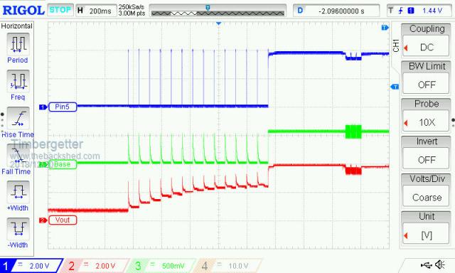

This shows 13 pulses on DP5 before the MosFet turns on. The MosFet output (Vout) is pulsing in sympathy with the DP5 pulses with its voltage ramping upwards as it advances from pulse to pulse.

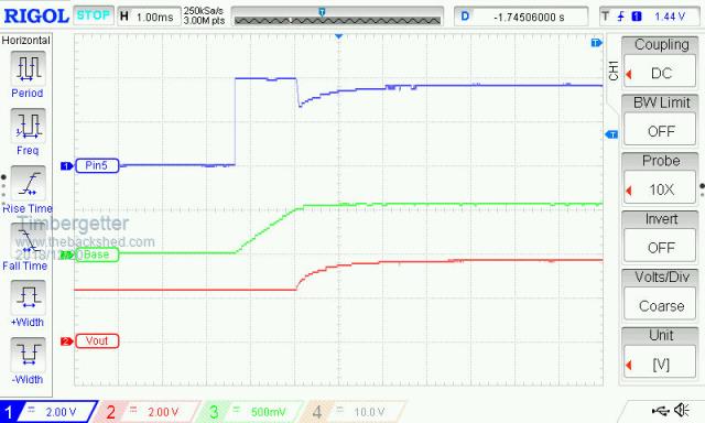

This trace zooms in at the time when the MosFet turns fully on.

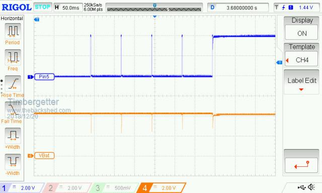

For this trace I powered the device from battery. It shows negative pulses on the supply line from the battery in sympathy with the pulses on DP5. (Powering the device with my el cheapo bench supply gives a similar result).

I still think Rob's suggestion is close to the mark. There does seem to be some 'motor boating' going on. It looks like the supply is dipping to nearly 2 volts if I am reading your trace correctly. That may be causing the DP5 output to drop too low and turn the transistor off and therefore the FET thus reducing the load on the power supply allowing the voltage rise again and so allowing the DP5 output to rise again. This dipping of the supply is probably causing the processor to eventually lock up. If your circuit is correct and checked with a multimeter I would try more capacitance on the supply. Maybe heavier wiring to the supply?
