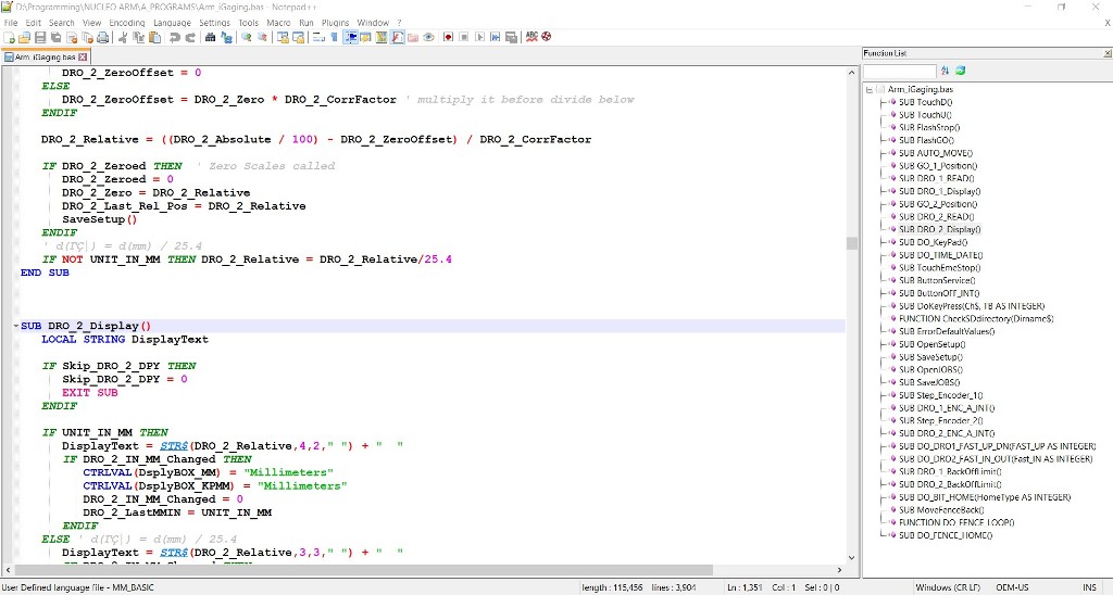

I had a play with trying to get a Function List working, I got close.
I've got a full SUB() list working.
NOTE: You can only use this if you have all of the code unfolded, otherwise you can't jump to a SUB().
Could be handy if you're changing/jumping around a lot of code in various subs.
In NP++, click View and then select Function List.
A list of every SUB is shown on the right, click on a SUB to jump straight to it in the editor code.

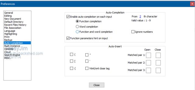

Posts: 3885
Posted: 11:01pm 13 Jan 2019
Auto completion now is working for me. I missed the part about having to go in to Settings, Preferences Auto-Completion and clicking Enable.
But I am unable to type in the field "From 1 th character". I type a "2", which appears as blank, and hit enter, and it still says "1". How did you change it to "2", Jim?
Thanks for this--it's helpful.

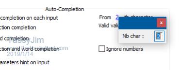

Posts: 6624
Posted: 01:35am 14 Jan 2019
Two things to observe.
Yesterday I updated my version of N++ to 7.6.2
They did mention that there are some folder changes but everything seems to work.
This morning auto-completion didn't work.
I now have MM_BASIC.xml in:
"C:\Program Files (x86)\Notepad++\autoCompletion\MM_BASIC.xml"
and autocomplete works again.
To set it to two characters before showing, click on the "1", enter 2 into the box and press enter.
The box will disappear and the setting is updated.
KeepIS
Joined: 13/10/2014
Posts: 2281
Posted: 01:39am 14 Jan 2019
No not in mine, it reverts to 1 any number input is not shown in the box, box closes and 1 is redisplayed.

Posts: 6624
Posted: 02:05am 14 Jan 2019
  Quote   Search "triggerFromNbChar=" (1 hit in 1 file)
C:\Users\Jim\AppData\Roaming\Notepad++\config.xml (1 hit)
Line 73: <GUIConfig name="auto-completion" autoCAction="1" triggerFromNbChar="2" autoCIgnoreNumbers="no" funcParams="yes" />
You might be able to edit the config file directly.

Posts: 2281
Posted: 03:23am 14 Jan 2019
Yes that works, set it to 2 and you still can't change it from the settings.
Mike.
KeepIS
Joined: 13/10/2014
Posts: 2281
Posted: 10:10am 16 Jan 2019
Got the new NUC PC going and everything setup, first thing I did was get the Function List showing Functions AND Procedures.
New Download:
Function List
Mike
EDIT: Well almost, it won't list a sub or function name with a "$" char in it,
e.g. SUB Remove$(...) Dam so close. Edited by KeepIS 2019-01-17
Chopperp
Joined: 03/01/2018
Posts: 1139
Posted: 05:44am 20 Jan 2019
Hi Mike
I'm only getting 4 of the 30 or so Sub routines listed in the prog I am testing. None have a "$" in the name.
Tried another prog with 10 subs. Nothing coming up at all.
Brian
ChopperP
KeepIS
Joined: 13/10/2014
Posts: 2281
Posted: 06:09am 20 Jan 2019
  Chopperp said   Hi Mike
Brian
My Procedures and Functions all use parenthesis after the name for clarity: Could that be the reason?
I have 37 Subs / Functions in one file, and lust loaded a small program with 4, all show up perfectly.
Mike.
