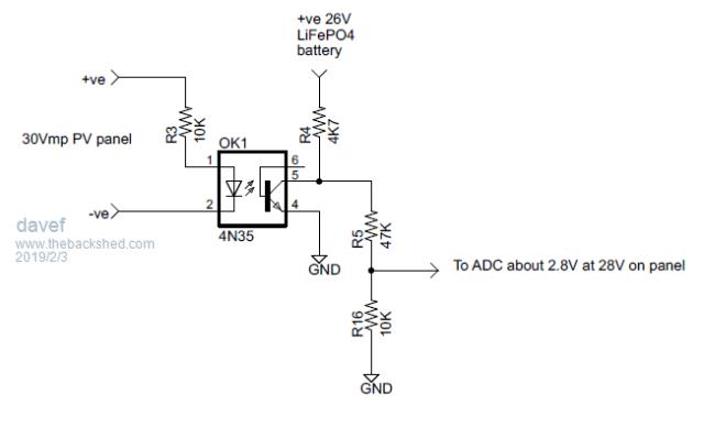

THANK YOU for these nice schematics! Your handdrawn picture was easy to read as well.

2. WHY use an opto like that? A resistor divider should work just fine since there's no isolation between the opto input and output
3. Obviously I am missing something and I NOTICED you subtly isolated input ground and output grounds, but why?

2) There is isolation between the opto input and output.
3) Because the SMPS Vin -ve and Vout -ve are separated under fault conditions and some PV controllers have separate Vin -ve and Vout -ve. One loses your ground reference when measuring PV panel voltage for instance.

I made a mistake in the opto-coupler circuit. R4 goes to my 26V battery not to the PV panel. Probably wouldn't change the other resistor values but it would mess with the curve of Vadc versus Vpanel.

OK. I was wondering why you said the opto was isolated on both sides where they clearly had +ve tied together.

Corrected opto circuit.
Another correction:
- R4 should go to a regulated supply, ie 15Volts in my case
The divider resistors will need to be changed. Suggest 3mA thru the diode and about 3mA through the photo-transistor at a nominal panel voltage of 30V. The divider resistors are adjusted so that when the panel input is zero, which makes the photo-transistor collector the highest, that the highest voltage presented to the ADC is 5V. That is for a 5V ADC reference.
