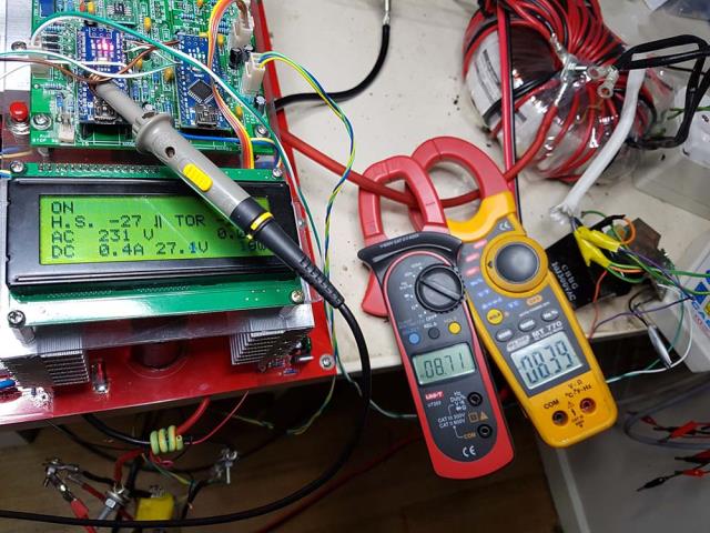

  wiseguy said   ... I believe what we are seeing is the charging up current for the AC capacitor on the rising voltage waveform and then recovering that energy back into the supply for the falling part of the wave form.
I beg to differ, I think it is the magnetising of the toriod core one way, then the other, as the 50 Hz waveform (probably about 90% to saturation) is driven by the inverter.
My idle current is 0.39A at 27.3V or approx 10.5W
This represents the losses which include but are not limited to
- Rds(on)
- I2R losses on the primary winding and the choke.
- toroid core's hysteresis
- powering the nanoverter (about 0.02 A at 27V, about 0.5W)

poida
Joined: 02/02/2017
Posts: 1507
Posted: 11:31am 01 Jun 2019
The 240V cap is 10uF.
Using an AC clamp meter (with unknown frequency response)
on idle shows 8+ Amps AC, with a primary voltage of 12.6V AC RMS
when driven with the 27.3V supply.
I prefer to use the current sensor and DSO to determine this current
since it is not fussed with frequency or crest factor within the limits of
my test scenarios.
The 240V cap I believe does not present much of a load on the inverter,
it continually takes and gives energy each 1/2 cycle. There are some losses
from ESR and other capacitor real world imperfections but it's there
to do a job which is be part of the LC filter.
I place 6A DC across the choke and primary winding, I see 100mV
This is 17mOhm DC resistance.
Edited by poida 2019-06-02

Ok now if you clamp one of the 240V AC capacitor leads and tell us what the capacitor current is - I am expecting around 1A.
And it would be that current increased by the turns ratio that we are seeing on the primary. But I agree & have stated it is of little concern because almost all the energy put into the capacitor is returned back to the supply each cycle.
There are 2 components to the story, yes there is magnetising current and there is capacitive reactance, but I am confident that the capacitive reactance is the major part of the primary current we are seeing on the unloaded inverter output.
Don't get tempted to disconnect the capacitor, the inverter might get angry with you.
To add clarification I am not suggesting the capacitor is a problem or that it shouldnt be there, it was a philosophical comment about the 10A Toroidal primary idling current and that the FETs are a little busy given there is no load.
FYI Carefully plug the 10A capacitor on the Power-Mate Lite socket (death lead) and check the idling power at 240V probably less than 0.5W true power now look at the current on the meter screen and then tell me it doesnt load the inverter - if there is less than 0.7A I will be very surprised. The VA should show you ~ 170VA (I will indemnify your meter against damage....)
Edited by wiseguy 2019-06-02
Cheers Mike
poida
Joined: 02/02/2017
Posts: 1507
Posted: 01:31pm 01 Jun 2019
I just now removed the cap, measured the power when I apply 240V AC to it.
I saw 117VA. After careful discharging it from 320V to zero, the LCR meter
shows 6.2uF.
(The marking has "10J300VAC", no worries. Maybe it's 10 Joules at 300V.
What's that mean in capacitance? Joules = 0.5 x C x V x V,
so given 10 Joules, 300V, whats the capacitance? 55uF..hmm the marking is Joules not uF? )
Xc = 1/(2PI x 50 x 6.2 x 10-6) = 513 Ohms
current then should be 240/513 = 0.47 A
VA might now be 240 x 0.47 = 112 VA
Close enough for me.
So that's what I am seeing when I see phase difference between primary current and AC output voltage. It's due to the cap, not inductance. What a dill I am.
Thanks for leading me to the truth, again.
By the way, this 0.47A times the turns ratio (230 / 12.6) = 8.6
Which is what the 2 clamp meters see.Edited by poida 2019-06-02

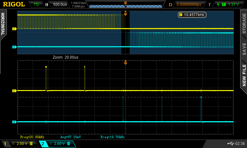

Poida can I ask for a little more detail about the inverter software with regard to the peak of the sinewave. What is the maximum duty cycle of the PWM output? Can it ever become 100% ie upper FET fully on during a whole 25kHz period (or more) and by deduction Bottom FET fully off for a 25kHz period (or more)? This question relates to the nano adjusting its gain higher if it senses AC out low and attempts to correct it.
If it is limited to say 98% or some arbitrary value, what was the max duty cycle limit chosen? If you could provide actual minimum off time and max on time it would be most helpful - I know this is also related to processing & the nano clock f.
Is the rest of the calculated values also proportional to the max duty cycle (if limited) at the peak ? I am assuming they would need to be as the sinewave would otherwise become distorted if only the maximum on time is controlled at the peak but for the rest of the sinewave it could still adjust duty cycle.
If this is a dumb question I apologise in advance. This has implications for charge pump bias generation on the high side drives amongst other things.Edited by wiseguy 2019-06-09
Cheers Mike

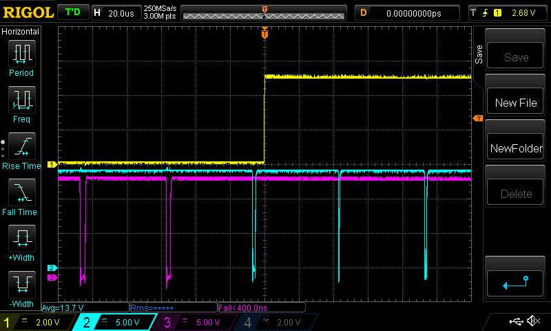

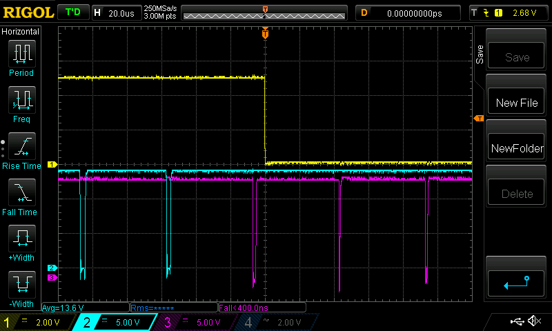

poida
Joined: 02/02/2017
Posts: 1507
Posted: 09:04am 08 Jun 2019
Mike,
the duty cycle is a nominal 800 clocks, at 16Mhz.
This means a 20kHz PWM cycle.
I can, on a 20kHz cycle by cycle basis, alter the duty % as needed.
From memory if you use a duty cycle of 1, you get a one clock pulse high
with a 799 clock low. If you choose a duty cycle of 799 you get 100% on with zero clock periods off. This is a particular behavior of the ATMega328.
In the code block "loop()" it runs once each 1/2 cycle of the 50Hz.
i.e. 100Hz at zero crossing time, I determine the correction needed to obtain the required AC output voltage. This voltage is directly proportional to duty cycle %.
I determine the required "power" value, and then ensure it does not fall below 0.01 or above 0.99, then multiply it by 800 and that is now the duty cycle in clocks.
So, a power factor of 0.01 is equivalent to 0.01 x 800 = 8 clocks.
This 8 clocks is the minimum duty cycle ever output to the gate drive ICs.
And 0.99 x 800 = 792 which is the maximum duty cycle, in clocks, ever output.
So the gate drive ICs will see a square wave, 20kHz, with duty cycle ranging from 8/800 to 792/800 clocks, at 16MHz.
That is, 0.5uS ON, 19.5 uS OFF for the floating point power command of 0.01 and
19.5uS ON and 0.5uS OFF for a command of 0.99
I ensure there is some significant amount of ON/OFF, at the 20kHz base frequency
to keep the charge pump circuit functioning.
With dead time and slow rise and fall times of the total gate drive circuit, this 0.5ms pulse does not amount to much ON time for a MOSFET.
Since we all here understand how DC is converted to an AC output, we size the primary windings appropriately to ensure we never need 0.99 power level.
I sized my 24V primary to be 12.6V AC (which is of course 17.8 V AC p/p)
yielding ample headroom for droop due to resistance.
My duty cycle % would be approx. 17.8/27.4 (27.4V is my usual test voltage on the bench) so it's about 0.65, or 520 clocks at the peak of the waveform.
How I modulate power output:
Already we see I need a power output of 0.65 for 230V AC
My soft start operates from a start point of zero power output (of course, brought up to 0.01, to ensure charge pump operation), and each 1/100 second, the following occurs:
if AC output is less than set point, add 1/300 to power, convert to duty cycle clocks and move on...
If AC output is greater than set point, subtract 1/300 from power, convert to duty cycle..
When soft start period has run, switch to PID closed loop, which derives a new power setting from the previous AC output and set point. This new power setting is again converted to clocks of the 800 clock base PWM cycle, and injected into the PWM timer.
The above is talking about obtaining ONE number. This number represents the duty cycle at the peak of a sine wave.
Scaling a sine wave is done as a linear operation.
So I use the above number (power x 800, where power can range from 0.01 to 0.99)
to scale the sine wave at all of the points I use along the wave.
I use 200 points for the positive part of the sinewave, and 200 points for the negative part.
The nano code produces an approximation of sine wave output by outputting a 20kHz square wave of varying duty cycle, with 200 separate points in the half cycle where I can define the appropriate duty cycle %.
The ATMega328 has easily enough processing power to calculate quickly the needed amount of duty cycle %, when given how large the maximum point of the wave must be (the power calculation parts, in loop()..)
So, every 20 kHz, the nano code is given - for this half wave only - a scale factor
for each of the 200 pwm cycles of this half wave. The nano scales the sine wave's duty% value to the required power output and puts it into the timer registers.
At startup, I create a table of sine wave values, scaled to 16 bit integer.
This saves a huge amount of time in the 20kHz interrupt code block.
The table contains 16 bit integers ranging from near zero to 64K,
corresponding to the sine function of a 1/2 wave, ranging from 0.000... to 1.0 and back to 0.000
I obtain the duty cycle % value from the appropriate entry in the sine table, multiply it by the integer scale factor and then divide it by 64K (16 bits..)
Very fast and it retains plenty of resolution.
I can modulate the output AC by one part in 800. This means at 230V with my 12.6V primary and 27.4V DC supply, the output voltage can only range in 0.44V increments.
In practice I find voltage control good enough to prevent lights flickering etc.
To get finer control over AC output, make the primary winding a higher voltage.
..within loop() I obtain some value for pwr, a floating point variable.
if (pwr > 0.99) pwr = 0.99; // clamp. Do math in floating point to prevent any integer overflow
if (pwr < 0.01) pwr = 0.01; // it's slower. We could do clamp after conversion to int but it's your mosfets...
vpwr = (int)((float)PPWM * pwr);// finally apply required PWM duty power factor to vpwr
here I determine, at the present point in time of the 200 points of a 1/2 wave
the required duty % lpcount is used to define the point in time of the 0-199 values of the lookup table of the 1/2 wave.
The code generated from below does not do any shifts, it just copies the top 16 bits of the 32 bit result to the low 16 bits. 2 clocks for a 16 bit divide.
c = (l[pcount] * vpwr) >> 16; // scale sine wave by vpwr, 32 bit integer calcs. 16 bit shift fastest of all
depending if it's one or the other 1/2 wave to be driven we apply this duty cycle, in processor clocks, where the PWM clock frequency is 800 clocks
OCR1B is the duty cycle register for pin 10
OCR1A is the same for pin 9 (or arse about, I can't be bothered to look at the cpu manual)
v1low is the flag to determine if we are driving one or the other of the 1/2 wave parts.
if (v1low == 1) // alternate between 2 output compare pins. Get a full 50Hz waveform
OCR1B = c; // 1/2 out this pin
else
OCR1A = c; // and then 1/2 out this pin.
Other code in "ISR(TIMER1_OVF_vect)" is mainly related to the mains sync
with the needed bit to switch from one to the other 1/2 cycle which is to toggle "v1low" from 1 to 0 and back.

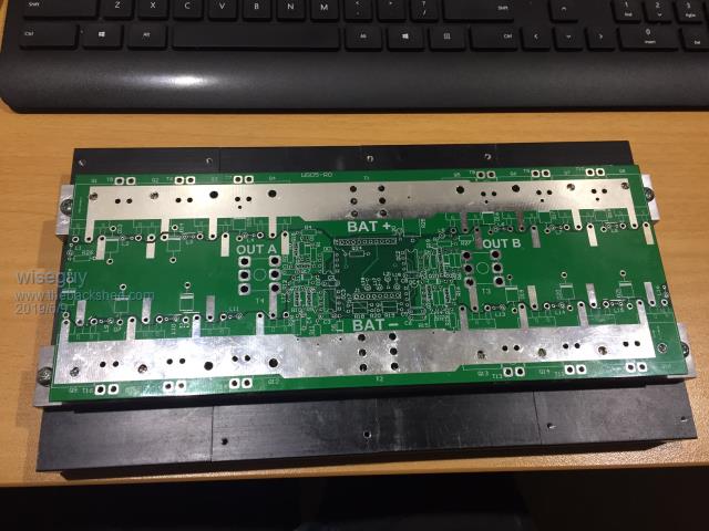

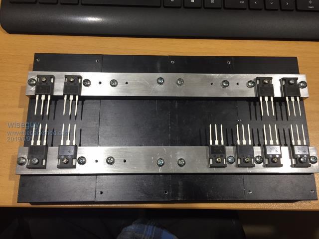

Sorry for the belated reply I have been busy since yesterday, bashing the metalwork into shape which had to be done before I start to populate the PCB. Here is what Ive been up to - and I ran out of FETs until my slow boat from China arrives
The FETs are mounted on a 25mm x 10mm Aluminium bar, the FET legs will be bent up to go into the PCB, the screws holding the FETs are temporary and will finally go through the PCB and sandwich the FET between the PCB & heatsink.
The 4 heat sinks were left over from an old project seemed like a good way to use some up...
I have not had a chance to open the variac nano code yet - it will come in very handy for testing purposes & I appreciate you taking the time to comment it for me - should be a great help in following and understanding.

Finally today I hooked up a large toroid and a 30V 5A supply to begin testing my inverter.
Everything is working essentially as expected and it even ran a Makita hand drill (only ~ 140V out), but it all works a treat.
However looking at the pulse trains for the sine-wave generation I noted the following behaviour of the Toroidal drive
First pulse      ~ 1.65uS    + 48uS delay
Second pulse    missing     (50uS delay)
Third Pulse      ~ 940nS     + 49uS delay
Fourth pulse    ~ 1.65uS    + 48uS delay
Fifth pulse       ~ 2.44uS    + 47uS delay
Sixth pulse      ~ 3.24uS    + 47uS delay
Next I checked the same pulses strait from the nano and got the following results
First pulse        ~ 1.6uS     + 48uS delay
Second pulse    ~ 70nS      + 50uS delay
Third Pulse        ~ 910nS    + 49uS delay
Fourth pulse     ~ 1.6uS     + 48uS delay
Fifth pulse        ~ 2.4uS     + 48uS delay
Sixth pulse      ~ 3.2uS      + 47uS delay
The last 3 pulses from the other end of the half sine waveform were
Third to last pulse     ~ 3.2uS  + 47uS delay
Second to last pulse  ~ 2.4uS  + 48uS delay
Last Pulse                ~ 1.6uS  + 49uS delay
The other half sine-wave phase gave the same results.  The second pulse (70nS)is too small to get through the FOD3182 opto-coupler that is why it disappeared from the FET power drive to the toroid.
Poida, I suspect that the two half sine-waves have essentially the same shape and probably deliver equal energy content albeit with some slight distortion.
There does appear to be something strange occurring though especially with the first and second pulse being 1.6uS and then 70nS respectively, they should be getting bigger not smaller. Also I would have expected the first few and last few pulses to be the same.
I am only bringing this to your attention as I suspect there is something going on that you may not be aware of.  Why can we resolve in ~ 800nS steps starting from zero on the up (ok starting from 1.65uS then zero) but on the way back, the final 2 pulses are 2.4uS and 1.6uS - I would expect the first two pulses on the up to be 1.6 then 2.4 ?
Note: This is an open loop result where the AC feedback is currently too small to regulate, so the gain of the nano has gone to maximum.  I have found in the past that when something is happening that is not fully understood other things may be occurring or affected that may have the potential to behave in a negative manner (bite you in the ass later....). Having symmetrical drive either side of the 90 degree peak gives lowest distortion & having symmetrical positive going and negative going half sine-waves are highly desired (essential?) to eliminate flux walking.
In an ideal world I believe the best results might come from a look up table of a single 90 degree sine portion that drives a sine wave to 90 degrees and then reverts from max back to zero using the same steps in reverse and the next 180 degrees for the other drive is derived exactly the same as the first 180 degrees. The gain would be constant and uniform for each whole 360 degree cycle. Read the feedback dc level and then use it to create the next (gain compensated) 90 degree look up table for the next 360 degrees.  This would ensure each complete cycle, once started would finish with exactly equal energy content and symmetry for both half sine-waves.
I am not suggesting the look up table contents actually has a fault or bad values but that something is causing some unexpected results to occur.
I do have the beginnings of an inverter showing promising signs of potentially working - albeit - so far not at full output yet - a quick clip showing a messy bench and a Makita hand drill being driven Here .  Idling power at 30V in is ~ 185mA (5.5W)
Edited 2019-09-30 00:23 by wiseguy

Mike,
I did a quick hack of the nano1 code to obtain how long V1 and V2 are switched on for.
Let V1 and V2 be the inverter outputs for the 2 half bridges.
When V1 is on for longer than V2, we will see a DC current appear on V1 compared to V2. I will see a unbalance in the duty cycle count totals if this is the case.
The hacked code sums the PWM duty (in cycles) for both V1 and V2.
I only start summing V! and V2 total cycle counts when the ramp up is complete.
In my test, there is no inverter present, no Vfb so the ramp up continues to
100% power and stays there.
I printed the difference in duty cycles for V1 and V2 at the time when v1low = 1
and uf = 1, that is some fixed time in the 50Hz output.
I see a constant value of (V1-V2) which in this test is 12 cycles.
The 12 cycles difference is likely due to one half cycle not quite being at 100% when the soft start completes.
The important thing is that this difference does not increase or decrease.
It stays constant after the soft start completes.
It stays at 12 cycles...
this means there are exactly the same number of clock cycles switching V1 ON
as there are clock cycles switching V2 ON. The V1 waveform has the same form as V2,
down to the clock cycle.
But this is when there is no voltage feedback.
This condition is important. Vfb might end up causing one 1/2 cycle to become larger than the other at some undefined time, and then Vfb might require the 1/2 cycle to become smaller at some other, later time. The magnitude of the changes might not exactly add up to 0.0000 at any time we chose to measure.
Nano1 code uses the same lookup table for duty % for both 1/2 cycles of the 50Hz output. One output pin is driven low and the other is driven by the PWM sine wave.

The ATMega328P offers near perfect timing and it's programmable and we can control it with OUR programs. (not like the EG8010 which is fixed in function and has some drawbacks)
I see with the current nano1 code the PWM is not optimal.
pin10 = OC1B
pin9 = OC1A
v1low = 1 when pin10 is SPWM and pin9 is pulled HIGH
Yellow = v1low (v ONE low)
Light Blue is inverted pin10 low side gate drive
Pink is inverted pin9 low side gate drive
Here is the zero crossing where v1low drops from 1 to 0
and here is when it rises from 0 to 1
We can see in both cases there is a PWM pulse that should not be there
The pulse about 5 uS before the yellow trace changes state.
Maybe no so much "should not be there" as it's the wrong pulse out the right pin.
Also there could be an "out by one" error with the pwm table counting.
Maybe I never get to the entry numbered 200.. and then it's time to switch over to the other 1/2 bridge.
I could fix this, maybe. I doubt it though.

Peter, thanks again for a very detailed explanation. I do not believe we are anywhere remotely close to requiring a FPGA to generate our wave-forms. The pulse you said should not be there for either waveform is what started me off in my post. It is essentially I think the same width as the (second/third ? ) step in the table depending on whether you start from zero. How is this 1 pulse being output just before the zero crossing (I assume the change of state of the yellow is zero?)
I believe the first two pulses should probably not be there. The first pulse is ~1.6uS wide the next pulse is 70nS wide. The third pulse is ~900nS wide. At the other end of the table, coming back to zero the final pulse is 1.6uS.
To my software challenged eyes I will describe what it looks like to me. The waveform is reading the whole table, but shifted to the left by one location. If it was shifted to the right the last pulse should (could) be around 900uS, the first pulse on the table would then be ~ 70nS (close enough to zero) and all would agree with your table ?  The first genuine pulse after zero would be ~ 900nS, the last would also be 900nS and all would be well ?
I have seen >= or <= or > or < usage cause tables to be read shifted by one by choosing the wrong one in lieu of another. I am not trying to find fault with your software or nit picking but it never sits well with me when I see different behaviour to what I expect.  My highlighting the anomaly is purely in the cause to achieving the best results going forward.
I think it unwise to output a 70nS pulse - it is unlikely to get through most drive circuits and if it did make it through it is an undesirable width in my opinion.  Perhaps any location in the table that will output a pulse less than 500nS should be set to zero ? If this is already being done where does the 70nS pulse come from?
The last query is that I interpreted that you said the minimum pulse width output generated is 750nS. But it appears that if I ignore the 70nS pulse, the narrowest one I see is ~ 900nS and the increments from that appear ~ 800nS (maybe 750) it is not causing me to lose sleep but should this 900nS be closer to ~ 750nS ?
Below I tried to relate what I saw at the beginning and end of the pulse train to your table - maybe this is not the right way of looking at it ?
                                                      Measured result
index ?  -> 24 cycles ON ? ........1.6uS ?  This is the first pulse output in the train
index 0  -> 0  cycles ON.............70nS (1cycle on?)(very close to zero)
index 1  -> 12 cycles ON........... 900nS
index 2  -> 24 cycles ON........... 1.6uS
index 3  -> 37 cycles ON........... 2.4uS
index 4  -> 49 cycles ON........... 3.2uS
index 198  -> 37 cycles ON......... 3.2uS  above we get 2.4uS for 37 cycles
index 199  -> 24 cycles ON......... 2.4uS  above we get 1.6uS for 24 cycles
index 200  -> 12 cycles ON......... 1.6uS  above we get 900nS for 12 cycles
1.6uS is the last pulse I see in the train - there is no 900nS (750nS) pulse before zero ?
To try to clarify, the last pulse I see (index200?)is 1.6uS. Was this read from location 200 (I expected that from 199), or was the wrong information in index 200 ? If there are 12 cycles at index1 and index200 the first and last pulses should both be ~900nS ? Did we truncate at 200 and then it was never output ? (I havent confirmed that there are actually 200 outputs in a string.......) Sorry to labour this I only just noticed you were suggesting similar in your last reply - I missed it.
A colleague I used to work with would sometimes exclaim that some issue was of monumental inconsequence - maybe this all falls into that category......
Edited 2019-10-01 19:38 by wiseguy

I've played with the code a little,
it removes the initial too wide pulse at the start of each 1/2 wave.
I'm at work and only have the 2 channel DSO, so we can not see the v1low trace
but imagine the transition from low->high is at the centre of the screen.
Is this what you are looking for?
It's likely some sort of "out by one" type of error, but with minor consequences that alter the shape of the output waveform a little.
this is the code that produces the above:
nano_1_v7_no_bessel_mike.zip
that final pulse of the Yellow trace is about 1.0uS wide.
Dead time function will place approx 0.5uS dead time on both sides of
(this pulse width - 2x dead time) which will be about zero effective pulse width.
This is when using the IR2184 which inserts a constant 0.4-0.5 uS DT
Edited 2019-10-02 08:53 by poida

"it removes the initial too wide pulse at the start of each 1/2 wave"
Is this really the beginning of a half wave?
Should this really read - it removes the initial too wide pulse at the end of the previous 1/2 wave that appeared on the wrong output pin (that should have remained at zero) - just before the zero cross ? This is an innocent question but I am playing devils advocate to highlight the inner meaning - I might not be getting something.
It appears the pulse is now skinnier but again - I am software challenged & make no bones about it - I would have expected the ports for pins 9 & 10 are only enabled after the corresponding zero cross has occurred.
I am looking at the traces above - not ideal - the narrow pulse seems to now occur twice, once just before zero cross, once after at the beginning of the pulse train.
This will probably have no detrimental affect overall - but for my interest how does a 70nS pulse occur when it should have been either zero or 12 pulses wide? BTW my hardware can drive the FETs from ~ 150-200nS pulses from the uC.
Edited 2019-10-02 09:20 by wiseguy
