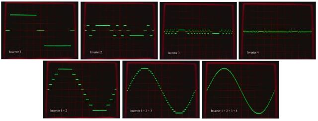

Posted: 11:53pm 11 Mar 2019
Klaus,
The top four waveforms are the secondary voltages of the four inverter transformers shown in correct amplitude relationships.
The lower three waveforms are the voltage produced when these transformer secondaries are connected in series.
Posted: 11:59pm 11 Mar 2019
This is a larger picture of the final waveform.
Edited by Warpspeed 2019-03-13

Posted: 12:11am 12 Mar 2019
Thats the picture I was looking for but could not find.

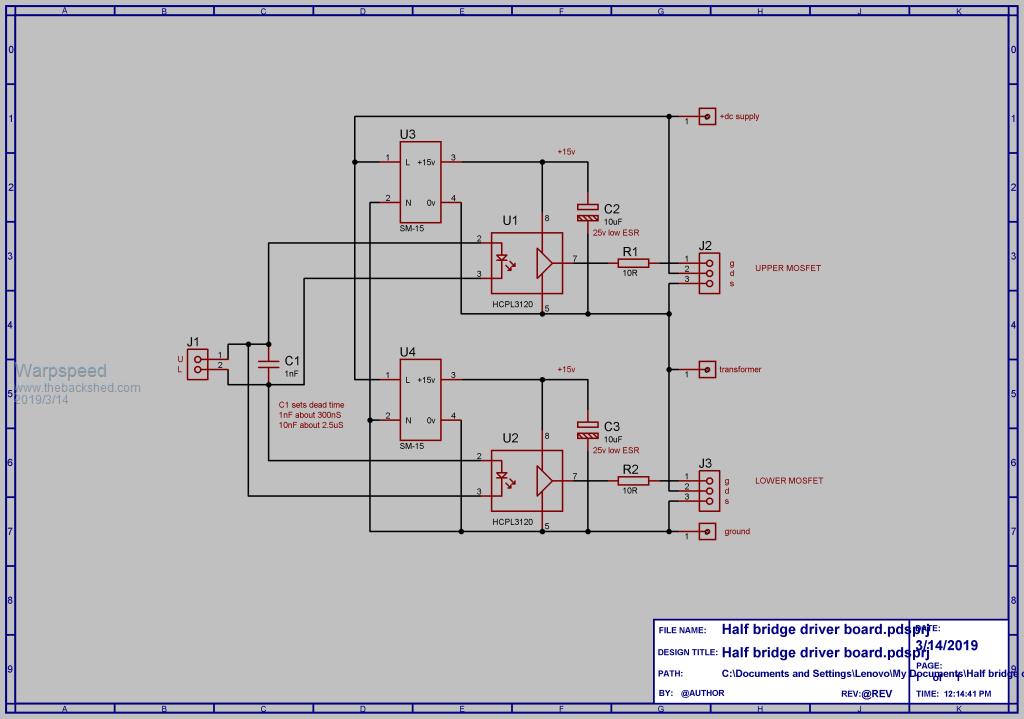

Posted: 12:49am 14 Mar 2019
Here is the schematic for one (of the eight) half bridge driver boards:
This deceptively simple circuit has a few very valuable features that go a very long way towards making the whole inverter pretty bullet proof.
The U/L twisted pair from the control board dives a pair of opto isolated mosfet gate drivers, and the LEDs of these are connected in inverse parallel. This makes it impossible for both upper and lower gate drivers to be on simultaneously. This provides very simple and effective cross conduction protection under any conditions.
To turn one opto isolator off, and the other on, the U/L drive voltage must slew through zero, where both opto isolators will both be off. The symmetrical dead time produced will be about 50nS, but we can increase that by any amount by fitting C1.
These opto isolators provide extremely high noise immunity, and also prevent any blowups from propagating back into the control board.
The HCPL3120 also has an internal undervoltage lockout to prevent any misbehavior during power up, and power down, or brownout.
As we are only switching at a very low cycle rate, the HCPL3120 can easily drive multiple very large mosfets or IGBTs with ease through suitable gate resistors.
U3 and U4 are small five watt isolated switching power supplies of postage stamp size. If very lightly loaded, as they are here, they will start up and run from about 30v, and operate safely up to around 400v dc input.
In my inverter I have seventeen of these small supplies. One on the control board, and sixteen on the eight half bridge driver boards. The combined running power of all the electronics in the entire inverter (with the transformers disconnected) will be 5 watts.
