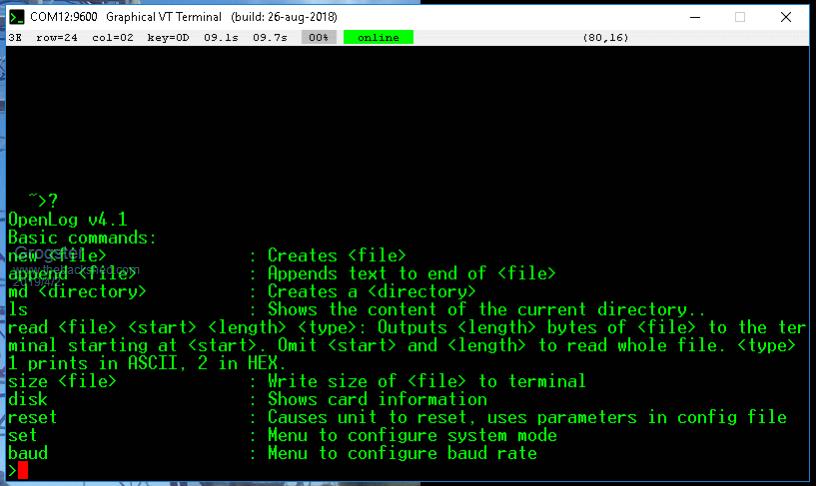

If you power-up the openlog with a sd card in the socket it will create a config.txt file if it doesn't exist already. The config file is only two lines of text and can be edited easily.
If there is a config.txt on the SD card the openlog will read that and set its
configuration accordingly.
So I set the option so that it starts in command mode, and i/o at 115200.
Once it is in command mode you can feed it commands directly, via
serial i/o eg manually with teraterm etc or from an external micro.
As you say, the commands are already available for practically all of the suggested list, eg for creating a file as ascii or binary etc.
Grogsters link above leads to a page with a command set link which has the info.
I have had a play, using the same i/o pins as the MM uses I think, and it seems pretty straightforward. 115200 is still not very fast but pretty useful.

I ordered from the same supplier as Grogster. Mine was also ready to use (it has firmware OpenLog v4.1).
Tested with PuTTY and it seems to behave as described in the earlier posts. I used a 1GB SD card. Not yet tested with Micromite. Do anybody have some simple MM program examples where OpenLog is used?

OpenLog is a cute little thing, and incredibly easy to use.
Out of the box, it is setup to automatically create logs and save anything you throw at it at 9600 baud.
Connect the OpenLog to one of the MM serial ports, and you can log things as simply as using the PRINT command. For example, if you put the OpenLog on COM1 and the port has been opened at 9600 baud, you just PRINT #1,"Hello world." - simple as that. The OpenLog will buffer the data and write it to the file on the SD card for you, all you have to to is send the data out the COM port.
When you first power up the system, the OpenLog will create and open a new file on the SD card and save all data to that file. When you cycle the power, another new file will be created, so it is pretty effortless to work with.
