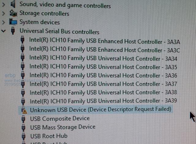

Hi,

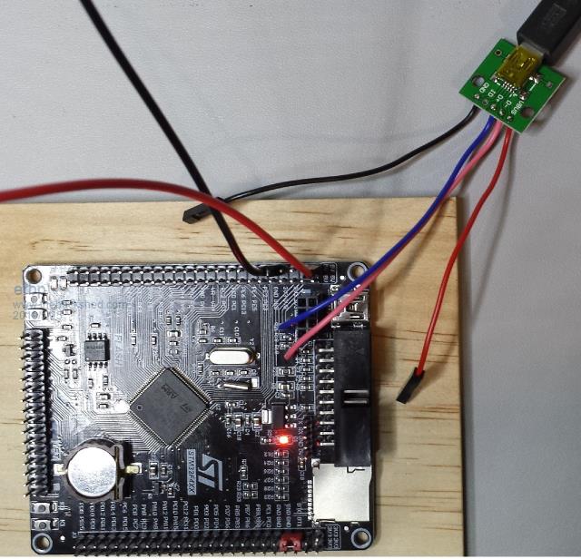

Got my board (and LCD screen) yesterday and have been trying to got it to work today. I got the firmware loaded ok after also experiencing some problems with the flaky USB connector as others have previously reported. But I cannot get Windows to recognize the Virtual COM Port after removing the BT1 jumper and changing BT0 to connect to GND. All Windows will do is report an error - see image below:
Initially I thought this was also due to the flaky USB connector but I have tried two computers and multiple USB cables (most known to work) all to no avail. I have even gone to the extreme of adding a replacement Mini USB connector - see below:
This arrangement has given a rock solid USB connection, and I have re-loaded both the original firmware file (2019-05-03_050415_ArmmiteF4.zip) and the updated one (2019-05-06_013740_ArmmiteF4) without any connectivity issues. Windows is quite happy to see the STM32 BOOTLOADER when the BT0/BT1 jumpers are set for firmware loading, but as soon as they are switched to just BT0 connected to GND - no USB connection!
I have also tried using an external 5v power source (actually connected when the above image was taken) - no difference there either.
I am thinking there must be something wrong with the chip or at least the parts that drive the non-bootloader mode USB.

BTW: If anyone is having trouble with the flaky Micro USB connector on the board and decides to add an outrigger one like I did (see the image in my first post on the previous page), there is an easier way than having to solder a couple of fly leads to components on the PCB. The USB D+ and USB D- signals use PA11 for D- and PA12 for D+ and these exist as pins on the J3 (right-hand side) connector - so you can just connect to them there using dupont connectors - no soldering required (well maybe at the replacement USB connector end).
