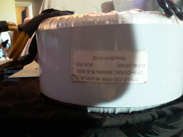

The picture above on top of this page looks just like a power Jack Transformer
I would almost bet they're made by the same company
The transformer in this picture is out of a 8000 Watt 48 volt Power Jack
And I am guessing it weighs 25 to 30 poundEdited by BenandAmber 2019-05-24
Mine was built in the southern hemisphere its the right way up lol. I do agree that if they didnt come from the same factory I would be very surprised. - I also liked your analogy of a swing to an AC resonance circuit - you are starting to get this electronic stuff, keep it up !

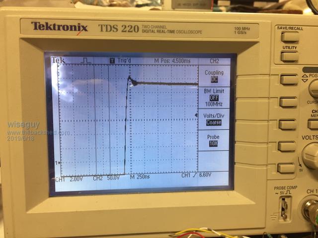

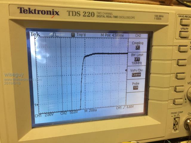

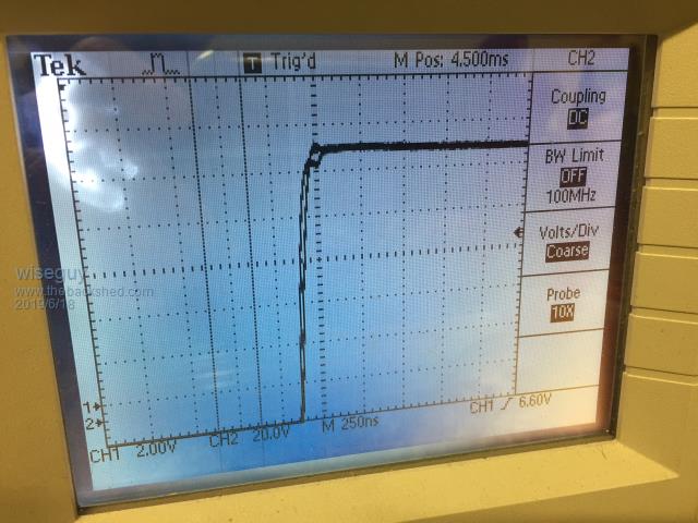

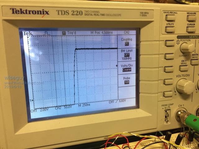

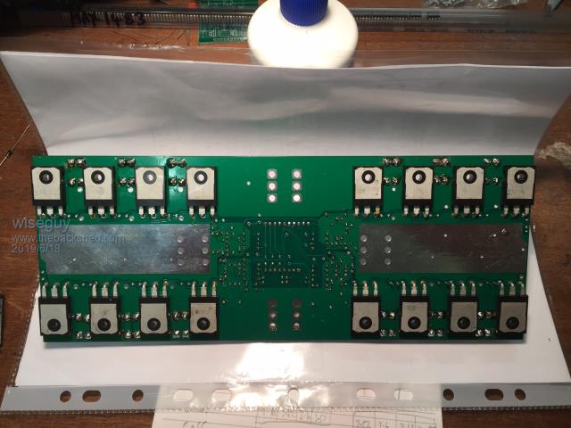

Quick update to my inverter build, boards are all coming together with no unsolvable issues yet. Gate drive circuit with negative bias also seems to work very well. I have a few jobs on the go so, my inverter time is limited at the moment.
A few pictures to show effects of gate resistor. . I found the suggestion of how to choose the correct value from an application note I found.
Please ignore the CH2 volts - I had bumped the probe to x1 so 4th image CH2 is actually 2V/Div not 20. Also note the negative 5V idle bias to ~ +12V drive swing.
Too low (1 Ohm) overshoot
Too high (3.3 Ohm) undershoot
What appears to be optimum (2.2 Ohm)
The last picture chows the 2 x drive waveforms, 1 straight at the buffered output and 2 the actual gate waveform after the gate resistor, all gates being driven (4) It looks pretty promising so far.
PCB with FETs mounted.
Next job is to fit the ferrite beads and select the dead-time capacitor and more testing.

Posted: 01:20pm 18 Jun 2019
Interesting, that low gate resistor value. All of mine are twice that or more. Have to try a smaller 2R2 resistor next time.
Just out of interest, are you bolting that board to a single heat sink with using Mosfet insulating washers or are you using 3 heat sinks? I suppose the ground plane keeps the top of the MosFets cool or the PCB warm .
wiseguy
Joined: 21/06/2018
Posts: 1336
Posted: 01:46pm 18 Jun 2019
You are correct I could use 3 heatsinks but I have chosen one for this assembly.

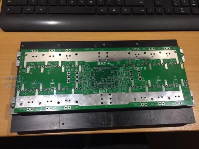

The ground planes are on both sides of the PCB. Here is the front side of the PCB, all current carrying planes are actually double width (& area) to what you see on one side. The silver areas are just a part of the total area so I could increase current capacity by soldering extra copper conductors where possible.
Due to the fast switching I need ferrites between each drain connection and the external connections, so connecting the drains directly to the heatsinks would not allow that.
If your inveter is working ok I dont advocate to change the gate resistor to 2R2, this suits my fast buffer and PCB layout for fast switching. It may cause other unintended issues to appear on different circuits and layouts.
Using a good fast CRO on the bench when not driving a load is the best way to see the effect of changing the gate resistor values - but it might cause oscillation issues to appear too.Edited by wiseguy 2019-06-19

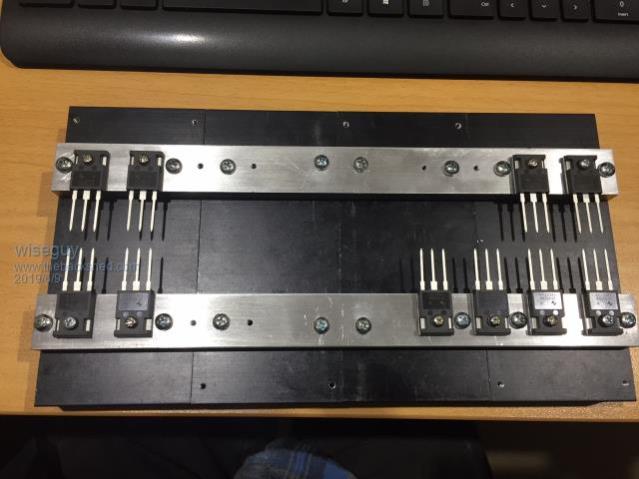

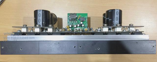

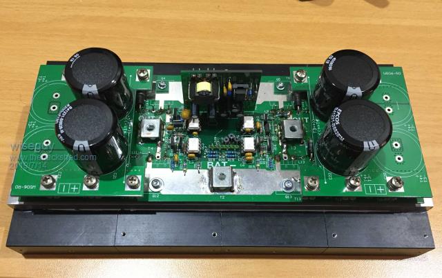

Time for an update on my inverter. Had some surgery to my finger a few weeks ago and haven't achieved a lot one handed since....
Have fitted all the Mosfets, insulating pads and ferrite beads. I wasn't sure when I designed the PCB whether I would have a fully isolated heatsink or connect it to Battery Neg. I decided to ground it to Bat neg & used the lower FETs mounting screws to achieve this via the PCB ground-plane. The upper row of FETs required an insulating shoulder washer so the Batt+ ground-plane was not shorted to ground also.
The Enphase solar battery I recently acquired was only a 24V LiFePO4 not 48V so my testing will soon move to a 24V inverter configuration. By having a fully isolated gate power supply & opto drive I can use any input voltage to the Power board from 0 - 60V, I only need to change the transformer and choke. Obviously voltages below 12V are very useless except for initial power up & anti-smoke testing.
Running from a 30V 3A bench supply it all actually appears to works very well so far with an 18V primary transformer.
Today I might have bagged a good bargain on Ebay, it is a 10KW 3Phase to 48V @ 210A rectifier unit. They claim brand new never used for $75!. All in a 3u High ~ 5" rack module @ 32kG lol. I used the buy it now button - just need to figure out how to get it to SA as its in Sydney & he wanted collect, no postage. For interest here is the brochure :2019-07-14_141706_PFM10kW.pdf
That should help with testing my inverter and later I can use it as a fast charger when I eventually get batteries.

mackoffgrid
Joined: 13/03/2017
Posts: 460
Posted: 05:18am 14 Jul 2019
Well done on the rectifier
Your inverter is looking very impressive, very neat.
Would you mind posting a few photos with the capacitor boards removed.
I hope your finger is mending well.

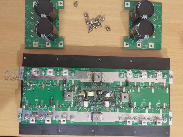

wiseguy
Joined: 21/06/2018
Posts: 1336
Posted: 06:05am 14 Jul 2019
Dammit Andrew the capacitor boards are hiding a stuff up !
Q2's gate was not supposed to be unmasked - it was supposed to be the drain....the perils of copy paste.
Ok here is a picture opened up - not sure what kinky parts you wanted to see. If you want the PCB off its only another 16 screws....
The Lower FET drains are passed through a ferrite bead and solder directly to the underside choke ground planes, that is why the holes are empty - I wanted to try it without beads first to prove that they are required. The upper FETs drains also required beads. Pardon the high rel uncleaned soldering......
Why are the jpgs so poor what picture file format gives the best results?
PS thanks, the finger is slowly mending.Edited by wiseguy 2019-07-15
Cheers Mike
mackoffgrid
Joined: 13/03/2017
Posts: 460
Posted: 09:31am 14 Jul 2019
I think PNG format is probably the best but I'm no expert in this regard. I just like how you've put this together. I forum seems to reduce the resolution and size of the photos. I like to see the photos like you have done but if you like, upload a zip file of better resolution photos.
I'm still trying to see how the bottom board and mosfets are fixed to the Heatsink. I'll re-read the thread and I'm sure my light globe will light up

wiseguy
Joined: 21/06/2018
Posts: 1336
Posted: 11:09am 14 Jul 2019
The FETs are sandwiched between the PCB (face down) and an aluminium bar that has an adhesive insulator to the FET faces.
The bar is threaded for all the FETs and a single screw through the PCB for each FET rigidly retains it all. The Bar is held by two separate screws to each of the 4 heatsinks - I had plenty to use up!
The screws for the high side FETs are all insulated from the positive plane with a small TO220 mounting bush also with a little square pcb spreader washer. The lower side screws are not insulated and connect the Batt- to the heatsink.
Here are the zipped up pics for better clarity. My viewer has every format except PNG - like me its old....
2019-07-14_210604_PWR_Pics.zip
I dont have my allen keys handy but I will dismantle it & take a few more pictures and post them soon.

mackoffgrid
Joined: 13/03/2017
Posts: 460
Posted: 10:45pm 14 Jul 2019
Your Zip photos were good thanks.
I look forward to more photos after you dismantle it.
Would I be right in saying you don't need the aluminium bar if you had one big heatsink? Or do you require the clearance?
