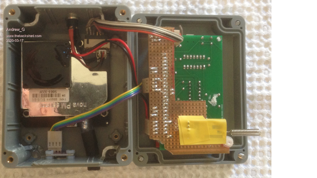

Hi Phil (et al),
My CCS811 arrived last week too but I couldn't play with it until yesterday.
It worked straight out of the box - Geoff certainly is a Wizard! (such nice colours too)
It is not yet 1/2 way through burning in.
I have it in the same box as a SDS011. My plan is to isolate the two by poking a say 4mm thick gasket all around the CCS811 so that it only sees the outside air (otherwise it would also see dirty air from within the enclosure - including that sucked in by the SDS).
(I too am seeing higher temperatures - my guess is that it is contributed to by the LCD and the other electronics in the box. I see this in my 6 other DS18B20s (with 1.8" LCDs). I reckon it is as much as 4+ degC with the 2.8" touch and about 2.5 for the 1.8"s).
I now have all my DS18B20s poke outside the box but they are still compromised.
One "test" I did was with a 1.8" LCD in a thermally stable room (bathroom with tiles and terrazzo all around). After I turned it on the temperature rose by 2.5 deg over 15-20 minutes then stabilised - I now can adjust the temperature readings at each station by sending an adjustment via HC-12.)

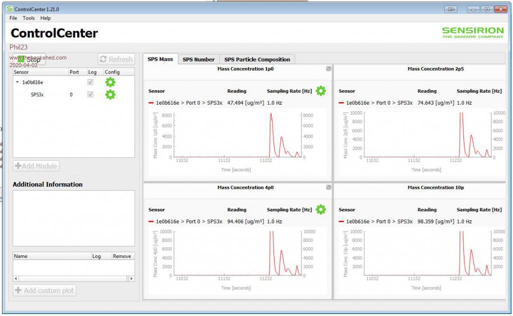

Stumbled across another sensor of interest just a while ago.
Caught my eye as the name Sensirion is familiar to Davis Weather station users.
Big thing that jumps out of the spec sheet is the life expectancy.
>8 years with 24/7 operation.
The 5 pin interface can be either UART or I²C with the Sel pin pulled low.
RS's price is $84.00 (or a bit over $56 if you get a tray of 56).
Might be an interesting on to play with down the track.
24/7 would be a bonus in the fire smoke monitoring situation mentioned above.
I can just see myself smelling smoke & knowing I'm only getting 5 min readings as per Jim's previous suggestion.

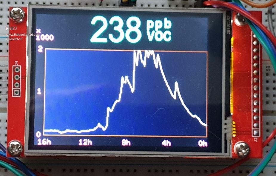

Out of interest, this is Geoff's monitor after it spent the night in the bedroom again.
The 12 hour mark corresponds to about 7:15pm & I called it quits a bit after 9:00.
Was up about 2 hours before the graph ends.
Was up around the 1:00am mark & noticed an 1800ish reading & wonder if that's what disturbed me.
Can't quite figure yet why the value rises so dramatically overnight.
It's a 4x7m room with 3.2m ceiling.
Renovated with new wall linings, paint & carpet about 10 years ago.
All furnishings outdate that time frame.
Phil.

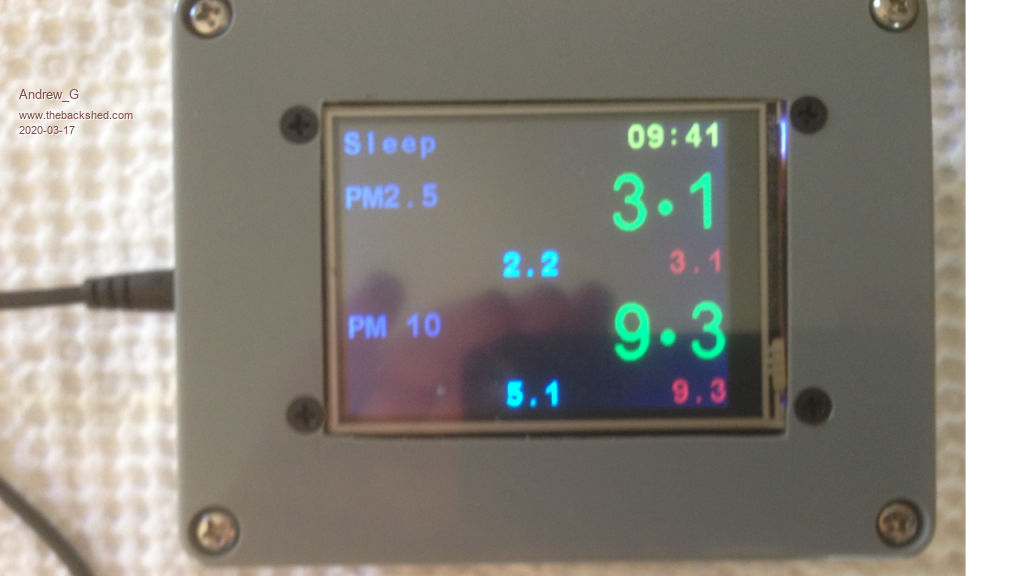

Phil,
Here is my "code" (FWIW). I'm happy to explain if you need it.
(and I'd really appreciate feedback, "why did you do that?" included)
- this is just for the SDS011 (I have a separate program based on Geoff G's for the VOC (same hardware)). I'll get round to combining with the two sensors in due course).
- the guts of it is Tassie Jim's work I just massaged it for my HC-12 network
- my network has a GPS up a pole with the weather station sensors - this sends sentences via HC-12s
- the Time and Date are updated every 2 hours (with a $AGD_T" sentence) or when any site sends a "$AGFST" sentence
- it uses two serial comms ports
- you'll need to change the TEXT fonts (the two Geoff G ones are from his VOC Monitor in Silicon Chip or on his website).
OK?
Andrew
(Edit - I've left the typos/formatting errors in my code for your amusement)

Andrew_G
Joined: 18/10/2016
Posts: 873
Posted: 11:33pm 16 Mar 2020
Hi Phil,
Thanks for tidying up my "code" - I guess that is what the "Code" button is for??
(Jim's MMEdit formats things to look better so the typos are less apparent.)
Here are two pictures:
The display shows current P2.5 and P10 values, in larger font, and the minimum and maximum values to date (Cyan and Red). The grey word "Sleep" changes to a green "Awake" when the sensor is working.
The top left time is from my HC-12 network as described above.
There is no graph (yet) but I graph all my HC-12 inputs on my PC.
The other pic shows you can just fit both sensors, an HC-12 and a LCD BackPack in the box. There is a bend in the tube feeding the SDS011 (and its covered in black heat shrink) to reduce the light getting to the sensor. I've enlarged the 4 holes at the back of the box to exhaust air from the SDS fan. I have yet to isolate the VOC sensor from the air inside the box.
OK?  Andrew

Andrew,
Good to see the pics & particularly the assurance that I'm not the only one that still uses strip board.
I'm sure I could learn to do my own PCB's, but work has me sitting behind screens enough in a day, let alone learning another PC based task.
Still trying to get my head around the graphs module here, but will get back to it.
Phil.

  Phil23 said  Andrew,
Phil.
Strip board ist gut!!!
B

Phil,
For such a simple circuit - yes!
I'm hanging out for a 3D printer that can do simple PCB-like boards. Now that would be good
Andrew

Hi All,
Received the Sensirion SPS30 I ordered a week or so back.
First stumbling block was that it's interface connector is a ZHR-5.
1.5mm pin spacing....
Received the plugs & pins from RS today & managed to get it connected to a USB port via the CH340 USB-Serial adaptor that came with my SDS011.
Sensirion's Evaluation software was quite happy to connect to the device & read it regardless of me not having their USB device.
Won't do too much with it of the SDS011 just yet as I'd like to get my head around Geoff's graphing code first so I can add more traces.
