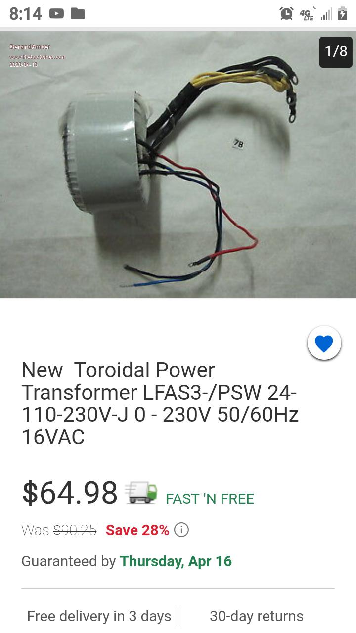

Posted: 12:09am 13 Apr 2020
There is a S3 power jack Transformer on ebay
I think it is 69 bucks that includes shipping
In 2014 powerjack used the s4 in 8000 watt inverter
Thay now use the S4 for the 8000 watt inverter
Warpspeed "one of the greats"would tell you that that S3 is good for somewhere around 2,000 Watts continuous
I have seen the  s3 run at over 3000 Watts
If you love your family I would go with warpspeed
He was designing inverters before I was born "unimaginable wisdom"
That Transformer is listed as 24 volt  low side primary is easy
Maybe you could use it in your first smaller inverter
it could be your back up inverter
I put two large 18000uf caps on mine
and built up the traces
It has had no problems it is suprising what it will start!
It would be asome if you could get another 3000 watt core and stack them together for your next primary inverter
It will be a little easier to wind that 10g wire
My wife had to help me I have very little filling in left hand and it is weak
You take it outside and wind by pulling wire through without a shuttle
it takes a while and lots of walking
but it is easy to get it straight and tight
It can be spread out little at a time over several days so you dont get burt out on winding
Less or no solder joints also!!
Once you get fist one done you will be ready to build a bigger one
This stuff is addictive and with these prebuilt boards you don't have to be a expert
As long as you can get some advice for a great when you need it
Cant wait to read about your success
I have lots of Parts if I can do anything for you just let me know!!

3) The toroid dimensions are:  ID - 91.5mm, OD - 183mm, H - 51mm (or if you prefer the Queen's language:  OD - 7.2", ID - 3.6", H - 2")
based on the material used and the calculator the seller provided, the TPV is 2.2.
Thanks a ton for your help!
