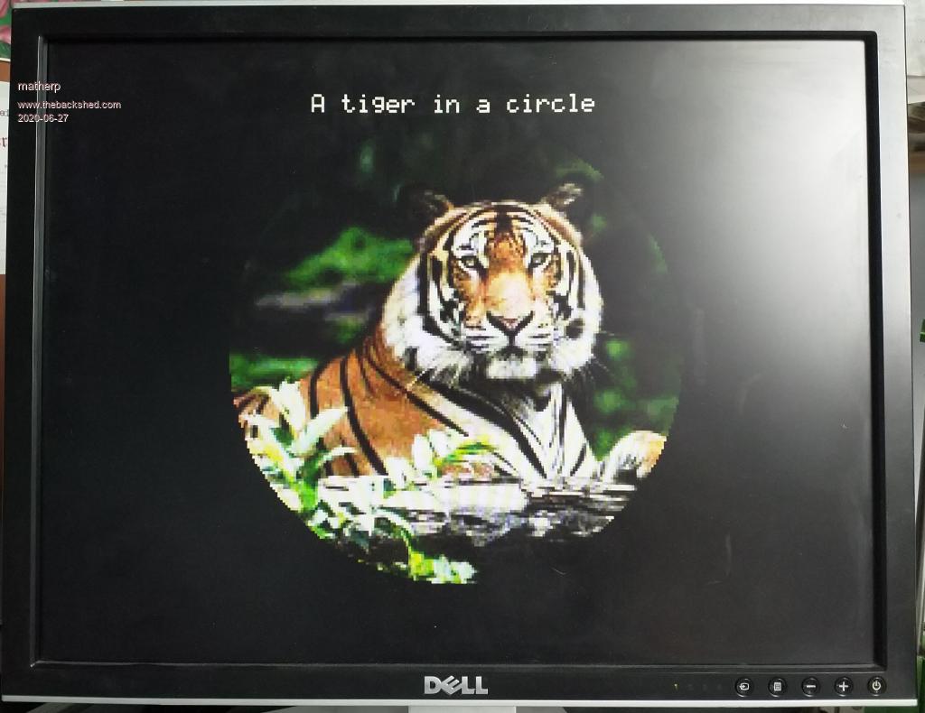

  Quote  May I put in a request for clipping regions?
To do this in a generic fashion comes into the "too hard" category but I've been thinking about this one and have a fun answer
Try the simple program below. You can substitute the LOAD JPG with any output you want clipped.
mode 3,12
page write 1
cls rgb(black,15) 'set the page to solid black
text mm.hres\2,0,"A tiger in a circle",CT
circle mm.hres\2,mm.vres\2,90,,,rgb(black),rgb(black) ' draw a circle in transparent black
page write 0
load jpg "tiger-320"
do:loop
I'm also thinking about implementing a chroma-keyed BLIT which could allow some interesting effects
