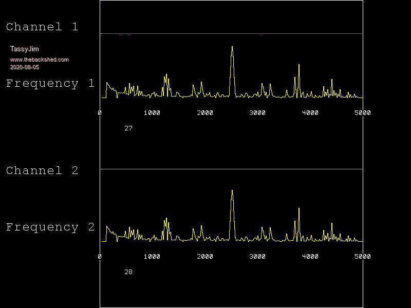

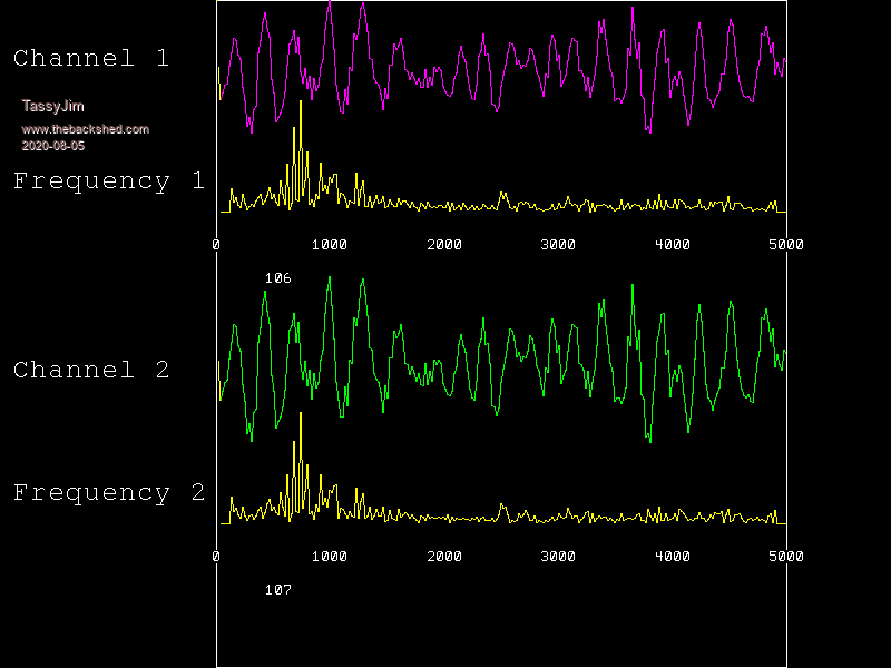

Another question:
Does this noise relate to SD card activity?
B
Posts: 6632
Posted: 07:08am 05 Aug 2020
I know you have checked the wiring but can we do a test.
 Connect the audio left and right audio to pins 7 and 8
 It doesn't matter which go where at this stage.
 Run this program:
 SETPIN 7, AIN
 SETPIN 8, AIN
 DAC 1, 0
 DAC 2, 0
 PRINT "Left  ";STR$(PIN(7),3,2);" Right ";STR$(PIN(8),3,2)
 DAC 1, 1.65
 DAC 2, 1.65
 DAC 1, 3.3
 DAC 2, 3.3
 DAC 1, 1.65
 DAC 2, 1.65
 do:loop
 The output should be similar to this:
Left    0.02 Right   0.03
Left    1.66 Right   1.65
Left    3.29 Right   3.29
If not, there is a wiring problem.
Next, using Peters FFT demo, slightly modified.
Run this program with the audio pins still connected to pin 7 and 8

Pressing 'P" will grab a copy of the screen and end the program.
Playing the audio from your MP4, gives this output:
Once the audio has stopped, this is what I get.
The FFT (yellow) is auto-scaling so any background noise is dramatically amplified when there is no audio playing.
The number below the frequency scale is the amplitude of the spectrum.
Some of the spectrum is due to artifacts, some will be actual noise, none of which I can hear.
Post a coy of your results.
