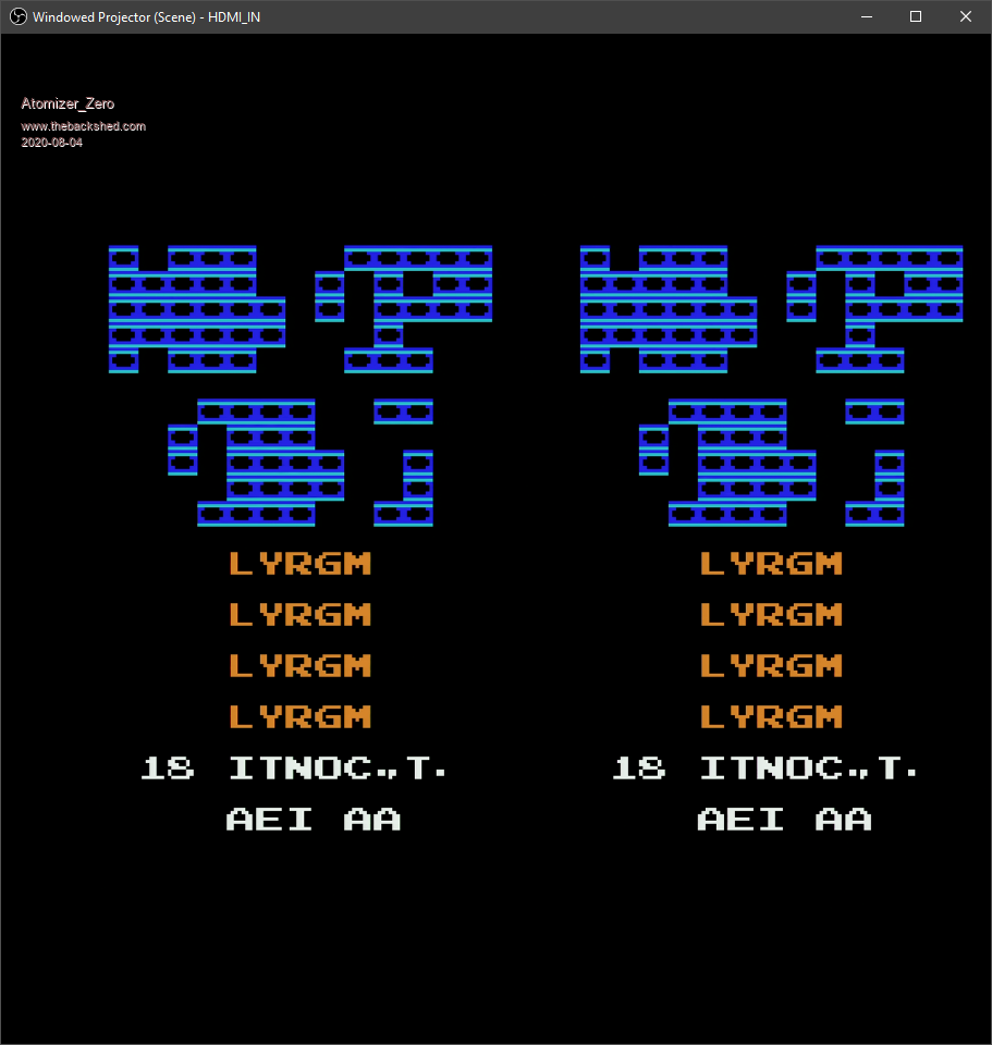

Posted: 09:03pm 03 Aug 2020
so... i rewrote the ppu logic...
Colours are working properly now but... well thats supposed to be the donkey kong title screen.
also, mode 6 works great. I need to figure out a way to offset the position of the rendering to the left by 16 pixels or so... any ideas?

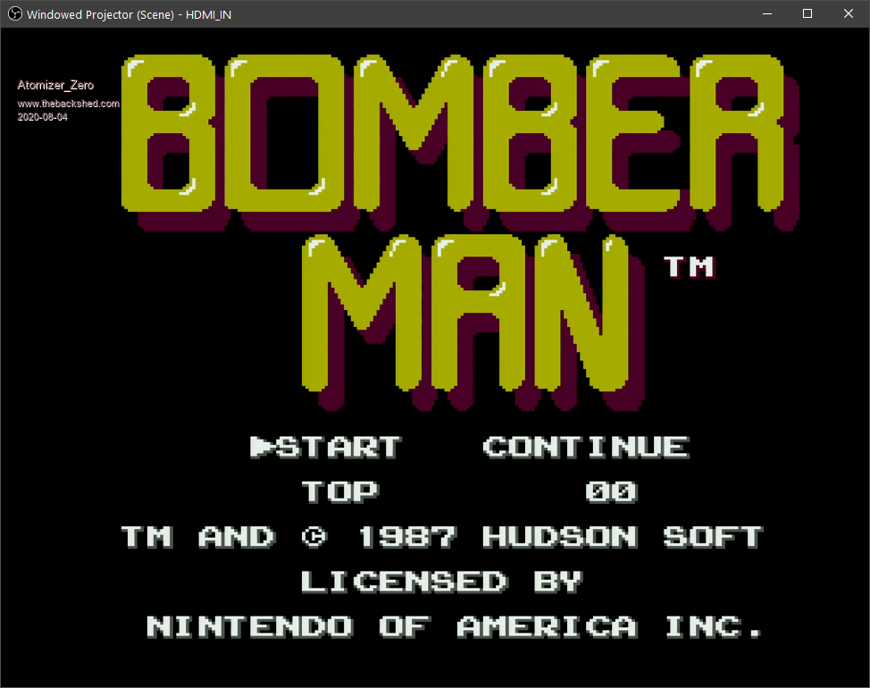

Posted: 10:11pm 03 Aug 2020
FINALLY!
But of course, still a problem. No Sprites are loading. The little Selection sprite icon isn't there.
But this is a win in my book. its running about 2 scanline a second, which is unplayable, but still a nice proof of concept.

Posted: 04:11pm 05 Aug 2020
I dont believe it. I've found the error.
I had a typo. Basically, one variable name instead of another. It was enough of a problem that all sprites were being drawn transparent.
This OF COURSE AS USUAL introduced another bug. The sprite data is garbled. It's wrong and just wherever it wants to be on the screen. I think I know the reason for this though.
Hopefully I'll be able to show a screenshot of game with actual sprites on soon.
The question is though.... from there, what next? Its obviously too slow to play, so.. maybe we can work together (if there's any interest) and try to slim the code down and do some clever tricks and things to speed up data manipulation?
Rewrite some of the code to be csubs? we already have one for byteflipping. I'm open to suggestions, critisism and whatever else.

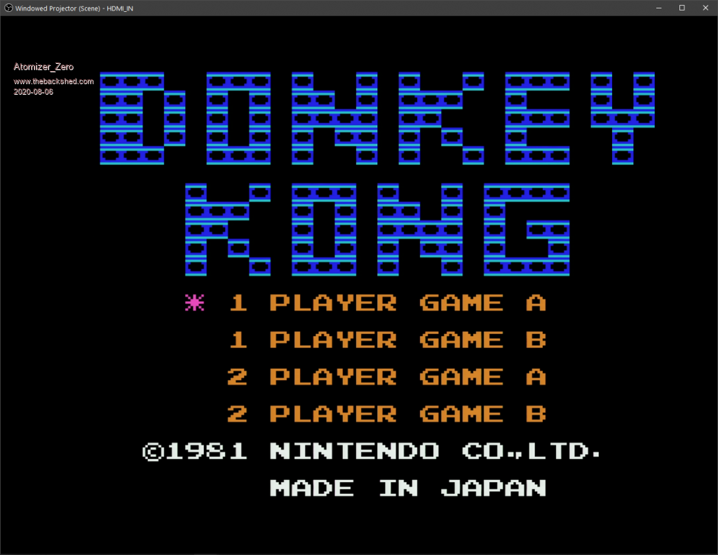

Posted: 04:19pm 05 Aug 2020
And just like that. I've fixed it
that little pink star is a SPRITE. :D
Posts: 4401
Posted: 05:38pm 05 Aug 2020
Very impressive.
