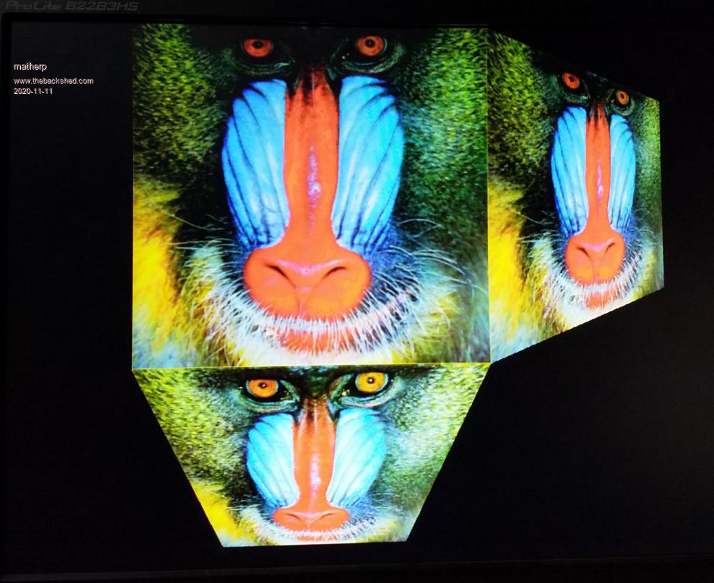

Perspective transforms in V5.05.06RC16
mode 1,16
load jpg "image2"
image warp_h 0,0,400,385, 400,0,385, 600,85,385-170
image warp_v 0,0,400,385,  0,385,400,  100,385*1.5,200
do:loop
The new commands are:
IMAGE WARP_H x, y, w, h, x1, y1, h1, x2, y2, h2 [,readpage] [,dontcopyblack]
IMAGE WARP_V x, y, w, h, x1, y1, w1, x2, y2, w2 [,readpage] [,dontcopyblack]
x, y, w, h defined the top left coordinates and the width and height to read from the current write page or optional read page
In both cases x1 and x1 define the top left corner of the area to write
In both cases x2 and y2 define the top right corner of the area to write
When warping horizontally h1 and h2 define the height of the transformed area at the left edge and right edge
When warping vertically w1 and w2 define the width of the transformed area at the top edge and bottom edge
Enjoy

Mauro Xavier will love this new feature
