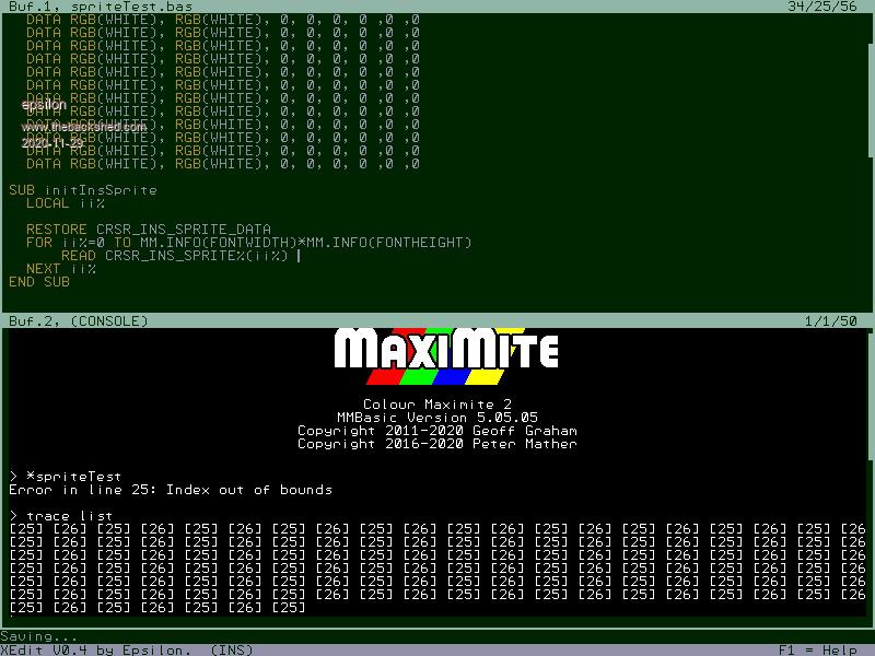

Hi all,
I uploaded XEdit 0.4. Here are the changes since 0.3:
- Added visual position-in-buffer indicator on right window border.
- Improved search speed.
- Fixed out of memory error when opening help screen in certain configurations, reported by thwill.
- Fixed weird 'animation' on last line when (un)indenting a selection that spans more than 1 screen. Also made indenting much faster.
- Dynamically sized keyword array (KEYWORD_LIST_DATA) using end sentinel as suggested by Jiri.
- Fixed bug: Search always started from the beginning of the line instead of from cursor.
- Added serial compatibility mode, enabled through flag SERIAL_INPUT_COMPAT_MODE. Note that enabling this mode affects certain keybindings. In particular, selection mode is toggled using the Esc key.
- Moved find-next keybinding to Ctrl-N. Added find-previous function bound to Alt-N.
- Added reverse-find keybinding, Alt-F.
- F6 shows console screen as it was when launching xedit in current buffer. This allows you to see your previous program output, trace list etc. from xedit. See screenshot below.
- F11 exits XEdit and runs program currently in buffer.

Best effort Character Recognition is indeed what I'm proposing. Just for MODE 1,8 and FONT 1,1 (initially?). I would divvy up the PAGE in FONTWIDTH by FONTHEIGHT chunks and match against the FONT 1,1 character set.
I'm more curious about how I can speed up horizontal scrolling. I tried copying the window contents one column to the left or right and then rendering the rightmost/leftmost column (with syntax highlighting) but that turns out to be just as slow as full page redraws. I'm going to have to do some profiling to figure out where the bottlenecks are exactly. I don't have a very good sense yet of the cost of MMBasic operations (function/sub calls, string manipulations, CSUB calls) vs. graphics operations such as BLIT.
Epsilon CMM2 projects

  Quote  I'm more curious about how I can speed up horizontal scrolling. I tried copying the window contents one column to the left or right and then rendering the rightmost/leftmost column (with syntax highlighting) but that turns out to be just as slow as full page redraws. I'm going to have to do some profiling to figure out where the bottlenecks are exactly. I don't have a very good sense yet of the cost of MMBasic operations (function/sub calls, string manipulations, CSUB calls) vs. graphics operations such as BLIT.
Is it on PAGE 0 or on some hidden one? I didn't go through XEdit, because I can't use it so much (in my workflow), but I you need I can write CSUB for horizontal scroll.

Posted: 06:02pm 30 Nov 2020
I have vertical scrolling implemented like that and it's working great. The difference is that with vertical scrolling I just need one additional SUB call to fill in the missing line.
With horizontal scrolling, the scrolling portion is just as easy of course (one fast blit) but filling in the missing characters requires one SUB call per row to figure out the right character and the right color for that character and that's expensive.

Could you store the full width (255 characters) as bytes, not pixels?
(Assuming mode 1,8 (800x600x1) and font 1 (8x12) for the following)
Storing 255 x 50 characters as pixels needs 255 * 8 * 50 * 12 = heck-of-a-lot bytes.
Storing them as characters uses considerably less, 12750 bytes.
When you scroll vertically, you either shift all the rows and add a new one, or better, maintain a pointer and use the buffer in a circle.
The buffer doesn't change for horizontal scrolling. You just show the appropriate horizontal window.
The big trouble? Colour coding. That could easily double the memory requirements: 2 bytes per character, 1 for the ASC code, 4 bits for foreground colour, 4 bits for background colour.

  vegipete said  Could you store the full width (255 characters) as bytes, not pixels?
Hi Pete,
That's a good idea. I might try that. The additional memory requirements are peanuts compared to a framebuffer. Thanks!
Coming back to Jiri's proposal to use a CSUB, I realized I can get around not having a TEXT function in CSUBs by having a page handy with all printable characters already drawn. I can then blit characters individually from that page. Blit is available in CSUBs. So that's another option I can try.

The problem with BLIT the character from another page is complicated because of foreground color. You can do it (prepare complete font in one page=once, then prepare  another page full of forecolor=everytime, do PAGE_AND_PIXELS=you will have font in forecolor, BLIT it back to PAGE 0), but it's pretty complicated...
So I already used CSUB for one character (drawChar screen address, charset address, ASCII code, row, column, forecolor, backcolor), it has some advantages:
1. fast and simple
2. I can use also characters with ASCII 0-31
3. I can change font on the fly!
With help of screenaddress I can fine tune vertical position (for example in MODE 1 and charset 8x16 you have 37.5 rows x 100 columns, so I need to choose first row position) and I'm limited with fixed column for character.
Edited 2020-12-01 20:00 by jirsoft

Hi all,
XEdit V0.5 is now on GitHub (also attached):
https://github.com/epsilon537/xedit_cmm2
See changelog below for details. It includes improved horizontal scrolling. Jiri and vegipete's input (thanks guys!) gave me enough incentive to actually go after it. It turned out to be fairly straightforward. Initially I was trying to make the row oriented rendering faster and more flexible so it could handle single character rows, and that just didn't work (well, it did, but it was slow). All I had to do was create a column oriented rendering routine. Calling TEXT "LTV" once for the entire column of text, instead of for each row made all the difference. In hindsight everything is obvious.
There's always more to do, but I'm pretty happy with where XEdit is right now, so I'm going to move it to the back-burner for a while. I'm itching to start other projects. I'm still on the hook for bug fixes of course.
Cheers,
Ruben/Epsilon.
ChangeLog
0.5:
- Improved horizontal scrolling speed.
- More sensible buffer position when toggling window split (F5).
- Faster vertical scrolling with active selection (shift-crsrUp/Down).
- Ctrl-K deletes from cursor to End Of Line.
- Fixed some laggy selection highlighting cases.
- Added User Configurable variable NUM_BACKUP_FILES specifying how many backup copies to
 maintain when saving a file. Defaults to 1.
- Added editor resource utilization pop-up, bound to Alt-R.
- Add Select-All key binding Ctrl-A.
- Avoiding unnecessary horizontal scrolling when moving cursor up or down.
- Reorganized help page.
- Fixed corner case where "Paste done." message doesn't appear after completing a past action.
- Fixed corner case: when undo buffer was full and needed to be cleared (emergency measure),
 the undo buffer lines weren't returned to the line pool, creating a memory leak.
